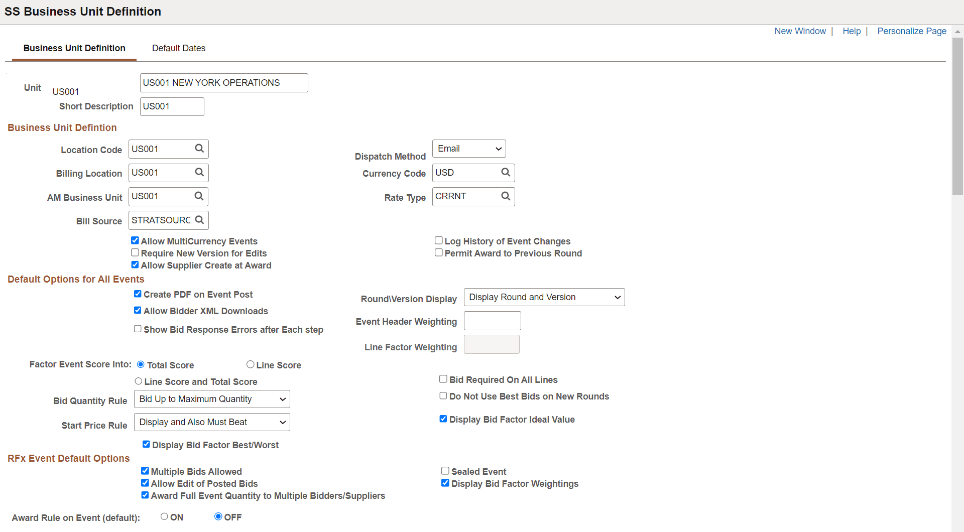

Use the Sourcing - Business Unit Definition page (BUS_UNIT_TBL_A1) to define the parameters of the business unit.
Either click the Add button after adding a new value, or select a business unit by number from the list of existing values.
Navigation:
This example illustrates the fields and controls on the Sourcing - Business Unit Definition page (1 of 3). You can find definitions for the fields and controls later on this page.
This example illustrates the fields and controls on the Sourcing - Business Unit Definition page (2 of 3). You can find definitions for the fields and controls later on this page.
This example illustrates the fields and controls on the Sourcing - Business Unit Definition page (3 of 3). You can find definitions for the fields and controls later on this page
Note: These fields are available for selection when you create new Strategic Sourcing business units.
Field or Control |
Description |
Unit and Short Description |
Enter the name and description for the new Strategic Sourcing business unit. |
Default SetID |
(Optional) Select a value for this business unit. |
Create BU |
Click this button after you enter all the field information to save the data and create the business unit. If the business unit is unique, a new row is inserted into the SetID table. |
Enter the values for the fields; these are the default values for events that are created for this business unit. You can change any of these defaults on a per-event basis when you create events.
Field or Control |
Description |
Location Code |
Enter default geographic locations for events within this business unit. |
Billing Location |
Enter mailing addresses for billings that are to be used for this business unit. This applies only to sell events. |
AM Business Unit |
Enter the Asset Management (AM) business unit that is to be used for sell events within this business unit. Selected assets are based on the asset management business unit that is associated with the event business unit. |
Bill Source |
Enter the external and online systems from which PeopleSoft Billing receives bills. When you integrate with PeopleSoft Asset Management and sell an asset by using a PeopleSoft Strategic Sourcing sell event, the Strategic Sourcing system sends the asset sale information to PeopleSoft Asset Management. PeopleSoft Asset Management then sends that information to PeopleSoft Billing to create the bill. The PeopleSoft Billing system uses the bill source to identify that the bill originated from PeopleSoft Strategic Sourcing. The system displays this field only if you have PeopleSoft Asset Management installed. |
Dispatch Method |
Enter the default means by which bidders are notified: Email, Print, or Fax. |
Currency Code |
Enter the default currency that is to be used for events that are within this business unit. |
Rate Type |
Enter the default rate type that is to be used for events that are within this business unit. |
Allow Multicurrency Events |
Select this check box to allow events to be created in currencies other than the default. |
Log History of Event Changes |
Select this check box to indicate that you want to track the event change dates and times, and the user making changes to a sourcing event. |
Require New Version for Edits |
Select this check box to indicate that a new event version must be created when an event is changed. Important! If you select this check box, you must create a new version every time you modify an event. |
Permit Award to Previous Round |
Select this check box to indicate whether a previous event round can be awarded. If this option is not selected, you can award bids only from the current round. |
Allow Supplier Create at Award |
Select this check box to allow suppliers to be created from bidders at the time of award. When awarding events to suppliers converted from bidders, the user must also have the appropriate access on the Procurement - Supplier Processing Authority page to enter and approve suppliers. To award purchase orders or contracts, users must have access on the User Preferences - Procurement page to create contracts and purchase orders. |
Default Options for All Events
Field or Control |
Description |
Create PDF on Event Post |
Select this check box to create a PDF version of the sourcing event. If this option is not selected, PDF creation is suppressed. |
Allow Bidder XML Downloads |
Select this check box to enable bidders to download events to an XML file. If this option is not selected, a PDF version of the sourcing event is created; however, an XML version is not created when the events are posted. |
Factor Event Score Into: |
Use to indicate that you want the system to factor the header score into the total score for the event or the individual line score, or both the line score and total score. Select Total Score to factor the header score into the total score of the event, which is calculated by adding the weighted line scores plus the weighted header score. Select this option if you intend to award the entire event to one bidder. Select Line Score to add a header score bid factor automatically to each line within an event. The line score will be calculated by adding the weighted scores of each line bid factor plus the weighted header score. Select this option if you intend to award different lines within the event to different bidders, or if you intend to use the optimization engine to recommend sourcing awards. The optimization engine uses the bidders line scores, not total scores, to determine an ideal award allocation. |
Round/Version Display |
Select a value to indicate how the rounds should appear to bidders:
Event Header Weighting |
Enter a default weighting to determine how the system weighs the event header score in relation to the total or line score. For example, if the header score is factored into the total score and you set the default event header weighting to 20 percent, then create an event with three lines. Line 1 is weighted 50 percent, line 2 is weighted 20 percent, and line 3 is weighted 10 percent. The total weighting of the lines is 80 percent plus the defaulted weighting of the header (20 percent), totaling 100 percent. For example, if the header score is factored into the line score and you set the default event header weighting to 20 percent, then the sum of the remaining bid factors for each line must total 80 percent. For example, you could have the price bid factor with a weighting of 50 percent and warranty with a weighting of 30 percent. The remaining 20 percent would be the header score bid factor, which is automatically added to each line. |
Bid Quantity Rule |
Select the bid quantity rule that will be the default value for all lines in the event. You can change this during event creation: See Understanding PeopleSoft Strategic Sourcing Events.
Start Price Rule |
Select a value to indicate the rule that the system is using as a basis for pricing:
Bid Required on All Lines |
Select to indicate that the bidders must submit bids for all lines in the event. |
Do Not Use Best Bids on New Rounds |
Select to indicate that new rounds should not be created using best bids when the bids are countered. If you select this option, then bidders will not be able to accept the counter offer on the Create Bid Response page; bidders will be forced to rebid. In this scenario, bidders will still be able to either counter or withdraw the bid. This setting will default to the Event Details page based on the business unit. However, you can change the setting at the event level on the Event Settings and Options page. |
Display Bid Factor Best/Worst and Display Bid Factor Ideal Value |
Select to show the best and worst values for the bid factor or the ideal value for the bid factor on the Create Bid Response page. If you deselect these options, then bidders will not be able to see the best and worst values or the ideal value for a bid factor on the Create Bid Response page. These settings will default to the Event Details page based on the business unit. However, you can change the settings at the event level on the Event Settings and Options page. |
RFx Event Default Options
Field or Control |
Description |
Multiple Bids Allowed |
Select to allow multiple bids on RFx sourcing events. Auction events inherently allow multiple bids by the same bidder on the same event. |
Allow Edit of Posted Bids |
Select to enable bidders to edit their posted bids for RFx and RFI events. Bidders cannot edit their posted bids on auction events. |
Sealed Event |
Select to indicate that the event is sealed, which means that the event originator cannot view either bids or bid history until the event has ended. This option is available only for RFx events. |
Display Bid Factor Weightings |
Select to display to bidders the weightings associated with bid factors for RFx and RFI events. Bid factor weightings are always displayed to bidders on auction events. |
Award Full Event Quantity to Multiple Bidders/Suppliers |
Select to allow RFx buy events to award up to 100% or full quantity of an event to multiple bidders/suppliers. This is applicable only for RFx Line (not applicable for Group Lines) — Buy.Event. Award Rule on Event (default) When you select this check box, the Award Rule on Event (default) field becomes visible. If the Award Rule on Event (default) is OFF, the Award Full Event Quantity to Multiple Bidders/Suppliers option is visible in the Event Setting page but the check box will be unchecked by default. However, user has option to select the check box for specific event. If the Award Rule on Event (default) is ON, the Award Full Event Quantity to Multiple Bidders/Suppliers option in the Event Setting is visible and by default enabled with the checked option. By default, it is OFF. |

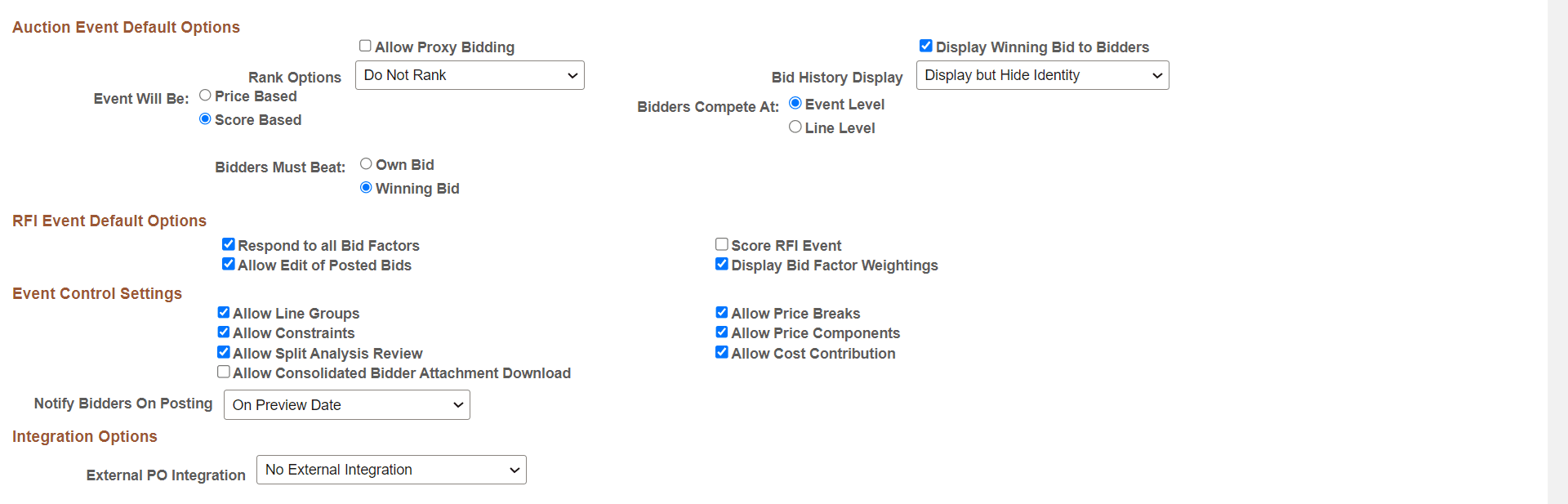

Auction Event Default Options
Field or Control |
Description |
Allow Proxy Bidding |
Select to enable bidders to use automatic proxy bidding. |
Rank Options |
Select a value:
Note: If you selected the Allow Proxy Bidding check box, this field is not available. |
Event Will Be: |
Select a value to indicate the basis on which the event will be awarded:
Note: If you selected the Allow Proxy Bidding check box, Price Based is automatically selected because proxy auctions are based on price. |
Bidders Must Beat: |
Select a value:
Note: If you selected the Allow Proxy Bidding check box, Winning Bid is selected. |
Display Winning Bid to Bidders |
Select this check box if you want the winning bid to be displayed to all bidders. Note: If you selected the Allow Proxy Bidding check box, this field is not available. Also if you selected that bidders must beat the winning bid, this option must be selected. |
Bid History Display |
Select a value to indicate how to display the bid history to bidders:
Bidders Compete At: |
Select either Event Level or Line Level. If Event Level is selected, bidders compete based on best total price or best total score. In some cases, a bidder can post a subsequent bid that has a worse score or price on one or more lines as long as the total score or price is better than the bidder's previous bid or the current winning bid. If Line Level is selected, bidders compete based on the best line price or line score. Note: If you selected the Allow Proxy Bidding check box, this field is not available. |
RFI Event Default Options
Field or Control |
Description |
Respond to all Bid Factors |
Select to indicate that bidders must respond to all bid factors associated with sourcing events. |
Score RFI Event |
Select to indicate that you want the system to calculate a score for RFI responses. |
Event Control Settings
Field or Control |
Description |
Allow Line Groups |
Select to allow line groups in events. |
Allow Constraints |
Select to allow constraints in events. |
Allow Split Analysis Review |
Select this check box to enable split analysis review functionality, which can be used for event creation or analysis collaboration. If this check box is not selected, split analysis review is not available for events. |
Allow Consolidated Bidder Attachment Download |
Select this check box to display the Download Bidder Attachment option in the Go To drop-down list on the Analyze Events page. |
Allow Price Breaks |
Select to allow price breaks in events. |
Allow Price Components |
Select to allow price components in request for quote events. |
Allow Cost Contribution |
Select to allow cost contribution for auction events. |
Notify Bidders On Posting |
Select an option to send an e-mail notification at a preferred time after an event is posted.
Integration Options

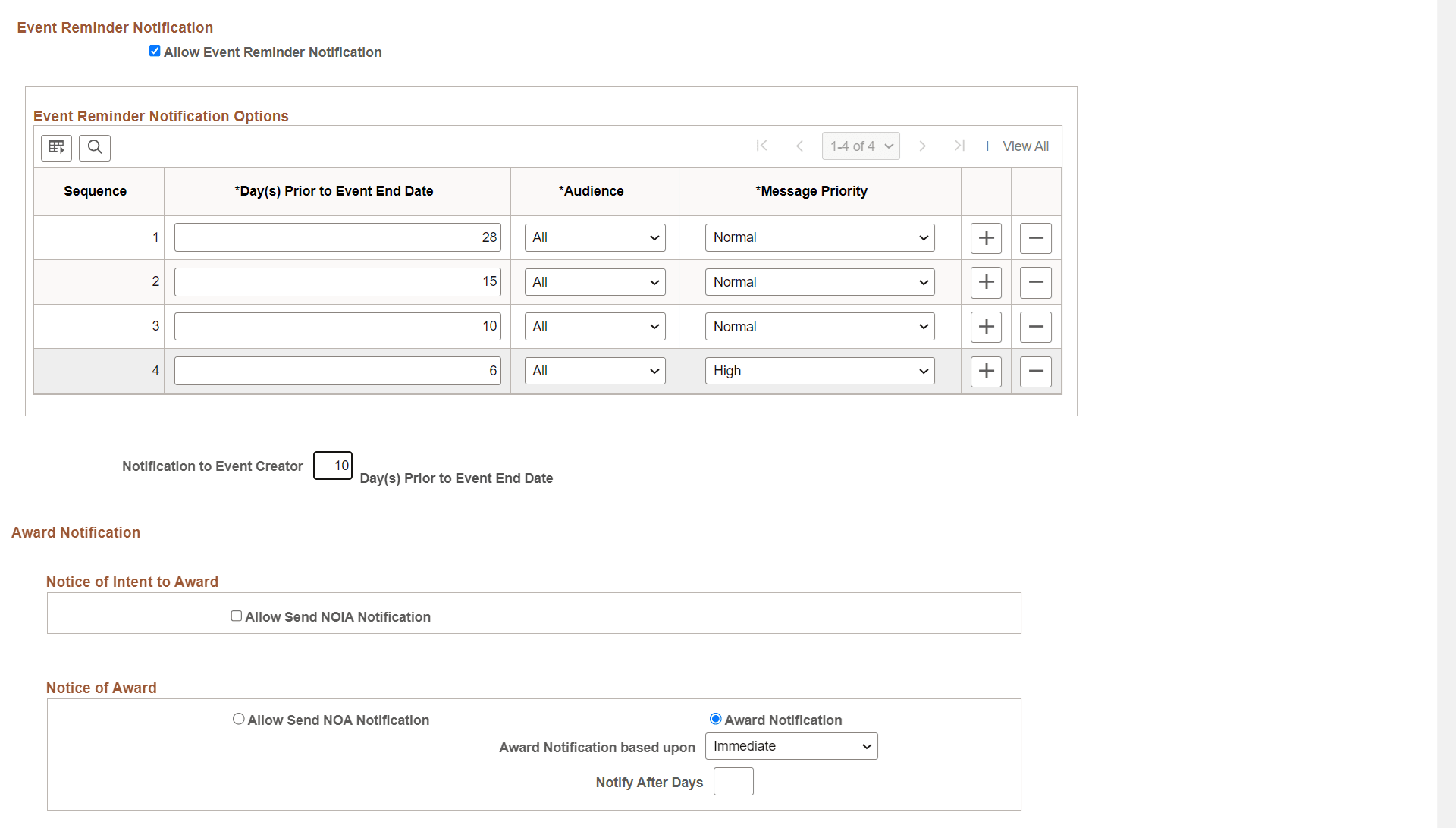

Event Reminder Notification
Field or Control |
Description |
Allow Event Reminder Notification |
Select this check box at the business unit level to display the Event Reminder Notification Options. Based on the specified configuration settings, email notifications are sent to suppliers or bidders as the end dates of the events approach. Note: You can send notifications only for BUY and RFI event formats and RFx event types. Sell Event formats and Auction Event types are excluded. You can modify the configuration settings on the Event Reminder Notification page while creating events. For more information, see Event Reminder Notification Page. |
Day(s) Prior to Event End Date |
Enter the number of days prior to an event end date. Based on the dates entered, the Bidding Opportunities tile displays the total count of events with the closest end dates. For more information on Bidding Opportunities tile, see Bidding Opportunities Page. |
Audience |
Select the type of audience - Accepted, All, In Progress, and Not Started- to whom you want to send notifications. |
Message Priority |
Select the message priority as High and Normal as desired. |
Notification to Event Creator X Day(s) Prior to Event End Date |
Enter the number of days prior to an event end date, so that the event creator receives a notification X days before the event end date. |
Award Notification
Notice of Intent to Award (NOIA) refers to a communication from a Company to a bidder that an award is forthcoming, and it also identifies the winning bidder.
Field or Control |
Description |
Allow send NOIA Notification |
Select to send a communication to the bidders that they have been identified for awarding a PO or contract. If you select this check box, all the related fields in this group box becomes available. An email is necessary, and an NOIA report template must be populated to use the NOIA feature. |
Notification to be Sent |
Select an option to choose bidders for sending the NOIA notification. This setting can be overridden on the Event settings and Option page. |
NOIA Report Template |
Select a NOIA report template. This adds a NOIA report template to the BI report. The NOIA report template of type RTF will then be used to generate a PDF which will be attached to the NOIA email Notification and sent to bidders identified for the award. This setting can be overridden on the Event Settings and Options Page. |
Standard Email Template |
Select a Standard Email Template to notify bidders on an email. The template specified at the business unit level will be used as the standard email template for that business unit and it cannot be overridden or changed in the transaction. |
NOIA Opening and Closing Text |
Select this link to default opening and closing texts on the RTF report. This uses standard comments entered in the Standard Comments Page |
Award Only after Notice End Date |
Select this check box to prevent a user from posting an award to PO or Contract before the notice period has ended. This setting can be overridden on the Event Settings and Options Page. |
You have two options to send notification to the bidder(s) when an event is ready to be awarded:
Award Notification: Select this option for sending email notification to a bidder and non-awarded bidders upon posting of the award. This has the following options:
Field or Control
Description
Award Notification based upon
Days: Select to send notification based on days. If you select this option, you must enter a numeric value in the Notify After Days field.
Immediate: Select to send notification immediately upon posting of the award.
When fully awarded:Select to send notification when the event is fully awarded.
Notify After Days
Enter a numeric value in this field if you choose to send notification based on days.
Allow send NOA Notification: Select this option for sending NOA notification to a winning bidder. Notice of Award (NOA) refers to a communication from a Company to the winning bidders that they are being awarded the PO or contract.
On selecting this option, the Award Notification option will be unavailable, and all the fields related to Allow send NOA Notification becomes available. A message displays to confirm the use of NOA notification option instead of the Award Notification option displays. Select Yes to proceed using the NOA option.
Field or Control
Description
Select an option to choose bidders for sending the NOA notification.
Award Template
Select an award template. This template will be added to the BI report.
The award template of type RTF will then be used to generate a PDF which will be attached to a standard email notification and sent to the Awarded bidder.
Non- Award Template
Select a non-award template. This template will be added to the BI report .
The non-award template of type RTF will be used to generate PDF report file which will be attached along with a standard email template and sent to the non-awarded bidder.
Select a standard email template to notify bidders with an email notification. The template specified at the business unit level will be used as the standard email template for that business unit. Both the Award and Non-award notification will use this standard email template. However, the content of the will with awarded and non-awarded details.
NOA Opening and Closing Text
