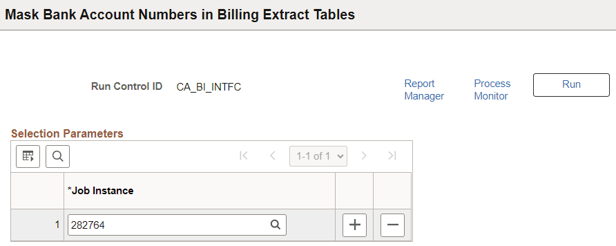

Use the Mask Bank Account Number in Billing Extract Tables page (RUN_BI_MASK_PG) to run the BI_MASK_EXTR process, which masks bank account numbers in Billing extract tables.
Navigation:
This example illustrates the fields and controls on the Mask Bank Account Number in Billing Extract Tables page.
Field or Control |
Description |
Job Instance |
Enter the job instance number(s) for non-successful job instances that contain the Invoice Extract process. |
