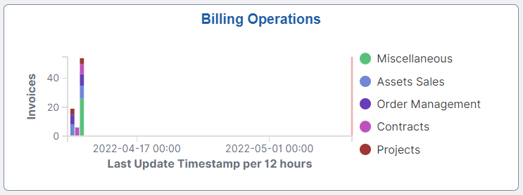

This example illustrates the Billing Operations tile.

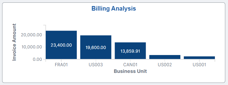

This example illustrates the Billing Analysis tile.
