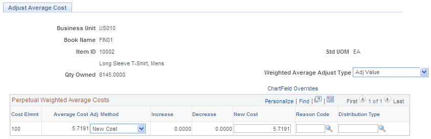

Use the Adjust Average Cost page (CM_COST_ADJ) to adjust perpetual weighted averages for items.
ChartField security can be applied to this page.
Navigation:
This example illustrates the fields and controls on the Adjust Average Cost page. You can find definitions for the fields and controls later on this page.
Use this page to adjust an item's current perpetual weighted average cost based on the business unit, cost book, item ID, and cost elements. The cost adjustment and inventory revaluation are processed by the Accounting Line Creation job. Entries on this page impact the average purchase price value displayed on the Define Business Unit Item - General: Common page.
Note: Negative quantities are acceptable, but the unit cost cannot be negative. A message appears if this situation arises.
Field or Control |
Description |
Qty Owned (quantity owned) |
Inventory is classified as owned, nonowned, or consigned. If inventory is nonowned, it is not considered a part of the inventory value for the business unit; nonowned inventory does not affect costing, and in this case, the average cost. The owned quantity for an item is used to recalculate average cost. Consigned inventory from a supplier becomes owned inventory when it is consumed; at that time, it is included in average cost recalculation. |
Weighted Average Adjust Type |
Options are: Adj Value (adjustment value): Enter a new inventory value for the specified item. The adjustment is processed by the Accounting Line Creation process by using the value adjustment transaction (transaction group 205). Accounting entries are created to record the change in inventory valuation. The adjustment transaction records the difference between the old and the new weighted average cost for the current owned quantity on hand for the entire business unit. If the inventory business unit requires location accounting, the process writes an average cost adjustment transaction for each owned storage area containing a nonzero balance of the item. Change Avg (change average): Enter a new current average cost for the specified item. This option does not result in accounting entries, but the transaction is stored in the database for record keeping purposes. For example, assume that the balance of the item in PeopleSoft Inventory (average cost multiplied by on-hand quantity) does not agree with the item's net balance in PeopleSoft General Ledger. Upon investigation, you discover that the general ledger (GL) balance is correct. Perhaps it is adjusted by using a manual journal entry. The change average option provides a method to change the average cost for perpetual inventory records. |
ChartField Overrides |
Select to change ChartField information, or you can select a SpeedType Key and the ChartField information appears as the default from the SpeedType. The SpeedType Key field only appears if SpeedType level is selected on the Inventory Definition - Business Unit Options page. |
Adjustment Method |
To adjust the average cost of an item, you have three options: Increase: The amount that you enter in the Increase field is added to the current average cost. Decrease: The amount that you enter in the Decrease field is subtracted from the current average cost. Enter the amount as a positive number. New Cost: The amount that you enter in the New Cost field replaces the current average cost. |
Distribution Type |
(Optional) User-defined codes that are a subset of transaction groups. This enables you to break down a transaction group into customized categories which can use different ChartFields by distribution type from the distribution accounting rules. |
Use the Average Cost Adjustment/PPV report to view adjustments that this page creates.
