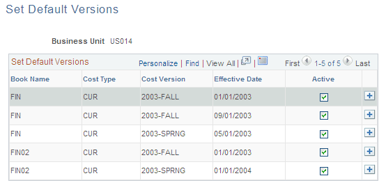

To use default versions for processing actual costing data, use the Set Default Versions component (CE_SET_BUBOOK_VER2).
Use the Set Default Versions page (CE_SET_BU_DFLT_VER) to identifies the default cost version that is to be used for each cost book when creating a production ID.
Cost versions are defined for the various books for actual costing in manufacturing. Different versions may have different cost rates for different as of dates.
Navigation:
This example illustrates the fields and controls on the Set Default Versions page. You can find definitions for the fields and controls later on this page.
Identifies the default cost version that is to be used for each cost book when creating a production ID. As production IDs are created, the costing process needs to know which cost version to use for the various books for actual and average cost purposes. The Transaction Costing process (within the Cost Accounting Creation process) uses the most current cost version based on the effective date that is entered here compared to the transaction date. Cost versions must be set for all cost books. The cost versions are used for calculating labor, machine, overhead, and by-products. Since each cost book could be on a different planning or budget cycle, the system enables you to have different cost versions (and cost rates) for each book. Cost rates, such as costing conversion rates and costing conversion overhead rates, are defined by a combination of cost type and cost version.
This page is not required for cost books using a frozen standard cost profile because the standard costs do not vary across cost books. The frozen standard costs are calculated and applied to production at the business unit level for all standard cost books that are within the business unit.

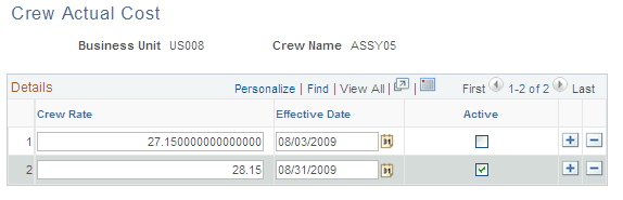

To assign actual cost rates to a business unit crew, use the Assign Crew Actual Costs (CE_CREW_ACTCOST) component. Use the Assign Crew Actual Costs component interface to load data into the tables for this component.
Use the Crew Actual Cost page (CE_CREW_RATE) to enter the actual labor rate by crew that is to be used by the Transaction Costing process (within the Cost Accounting Creation process) to calculate the actual cost of production IDs by using this labor crew.
This page is used if the item's cost profile uses the Actual Time-Crew Rate option for the Labor Cost Method field.
Navigation:
This example illustrates the fields and controls on the Crew Actual Cost page. You can find definitions for the fields and controls later on this page.
Enter the actual labor rate by crew that is to be used by the Transaction Costing process (within the Cost Accounting Creation process) to calculate the actual cost of production IDs by using this labor crew. This page is used if the item's cost profile uses the Actual Time-Crew Rate option for the Labor Cost Method field.
