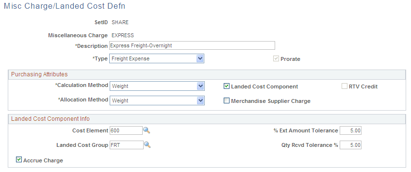

To define miscellaneous charge codes, use the Misc Charge/Landed Cost Defn component (CM_LC_COMPONENT).
Use the Misc Charge/Landed Cost Defn page (CM_LC_COMPONENT) to define miscellaneous charges, including landed costs, to be applied to POs.
Navigation:
This example illustrates the fields and controls on the Miscellaneous Charges/Landed Cost Defn page. You can find definitions for the fields and controls later on this page.
This page is used to identify both miscellaneous charges and miscellaneous landed cost charges. Landed costs charges are prorated to the PO distribution lines, receipt distribution lines, and voucher lines. A landed cost can be from the merchandise supplier or a third-party supplier.
If you select the Accrue Charge check box, then the estimated landed costs for that miscellaneous charge code are included in inventory value at putaway. If you do not select the Accrue Charge check box, the system waits for the actual landed costs (recorded on the matched and posted voucher) and then records the actual landed costs in an expense account. The non-accrued charges are not included in the inventory value.

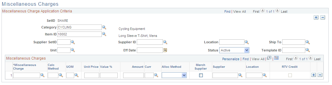

Use the Miscellaneous Charges - Miscellaneous page (ITM_CAT_VNDR_MC) to enter the criteria for applying miscellaneous charge codes or landed cost templates to POs.
Navigation:
This example illustrates the fields and controls on the Miscellaneous Charges - Miscellaneous page. You can find definitions for the fields and controls later on this page.
In order to have the system automatically populate the POs with the correct miscellaneous charge codes and charge amounts; you must design a series of parameter combinations. When a PO is entered that matches the combination of parameters that you define, the assigned charge code or template is used.
You can set up default miscellaneous charges that are automatically calculated based on these combinations, where level one overrides level two, and so on:

For example, you can set up miscellaneous charges that are automatically calculated on the PO when a certain item is ordered from a particular supplier, for a particular purchasing business unit, and for a specific ship to location of the business unit. You can also set up a miscellaneous charge that is automatically calculated for a particular item.
Only one Miscellaneous Charges - Miscellaneous page combination is used for each charge code. If you define the same charge code at multiple levels, the system uses the Miscellaneous Charges - Miscellaneous page at the most specific level of detail. However, you can define more than one charge code. For example, if you define a miscellaneous charge named shipping for an item (level 4), and also for the category (level 8) that the item belongs to, only the charge that is defined for the item is used. The miscellaneous charge that is defined for the category is only used for items that do not have a miscellaneous charge that is specifically defined for them. However, if you define one charge code (shipping) at the item level and another charge code (handling) at the category/supplier/Purchasing business unit/ship to location, then the PO picks up both the handling and shipping charges.
Field or Control |
Description |
Template ID |
If you want to apply a template of miscellaneous charges, select the template ID. Miscellaneous charge templates are set up on the Misc Chg/Landed Cost Template page. |
Misc Chg (miscellaneous charge) |
The miscellaneous charge code. If you want to apply a miscellaneous charge code, select the charge code ID. Miscellaneous charge codes are set up on the Misc Charge/Landed Cost Definition page. |
Calc Method (calculation method) |
Select the method that you want to use to calculate this charge. The default comes from the Misc Charge/Landed Cost Defn page. Choose from these options: FL (flat amount): The charge is a flat amount that you enter in the Amount field. FR (free): No charge is to be applied. UNT (per unit amount): Calculate the charge based on the number of items on the PO line. VAL (percent of value): Calculate the charge based on a percentage of the material value. VOL (rate based on volume): Calculate the charge based on the total volume for the PO line. WT (rate based on weight): Calculate the charge based on the total weight for the PO line. |
UOM (unit of measure) |
The unit of measure, for volume or weight, depending on the choice that you made in the Calc Method field. |
Unit Price |
The per unit amount of the charge. |
Value % |
If the miscellaneous charge is a percentage of the unit price, this is the percentage of the charge. |
Amount |
The fixed order amount of the miscellaneous charge. You can define both a unit price and an amount if the calculation method is UNT, VOL, or WT. |
Currency |
The currency of the miscellaneous charge. |
Alloc Method (allocation method) |
Select the method to allocate the miscellaneous charge. The default comes from the Misc Charge/Landed Cost Defn page. Options are: Matl Value (material value): Allocates the charges based on the value of the items on each selected line. Quantity: Allocates the charges based on the quantity of items on each selected line. Volume: Allocates the charges based on the volume of the items on each selected line. Weight: Allocates the charges based on the weight of the items on each selected line. |
Merch Supplier (merchandise vendor) |
The Merch Supplier option setting appears by default from the miscellaneous charge's purchasing attributes on the Misc Charge/Landed Cost Defn page. You can override the setting here as necessary. If you select this option, charges are paid to the PO supplier. If you do not select this option, you can use the Supplier and supplier Location fields to designate a third-party supplier. |
RTV Credit (return to vendor credit) |
Select this check box if you can receive credit from the vendor for these miscellaneous charges if the items are returned. This check box is only active if the merchandise supplier is selected. |
Selection Criteria |
Click to access the Miscellaneous Charges Selection page, where you enter the criteria for the miscellaneous charges to appear on the Miscellaneous Charges page. |
