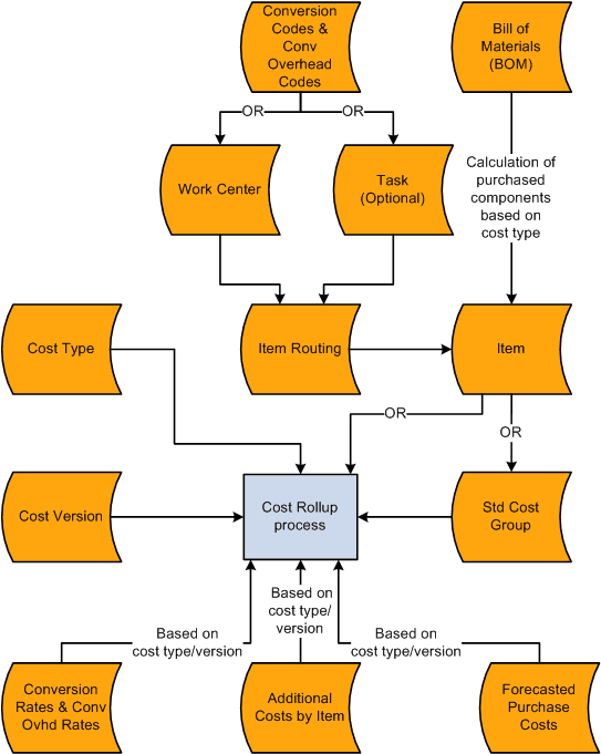

This diagram illustrates the calculation of the cost of manufactured items. The Cost Rollup process calculates the standard cost based on the BOM and routing of the item. The cost type and cost version combination determine the rates and additional costs used to calculate the cost:
The Cost Rollup process uses several elements to compute the frozen standard costs, including:

Cost Rollup Process |
The Cost Rollup process uses the item routing, cost type, and cost version to determine the labor, machine, subcontracting, and overhead costs. For example, if the cost rollup process uses the cost type of CUR and the cost version of PRD1, with the item ID SR1001, then the conversion costs for the operation sequence 50 would be:

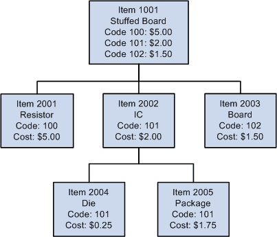

The Cost Rollup process must calculate the cost at each level of the product structure, as well as the final cost. For example, if an item has a BOM or component list like the one in this diagram, the cost rollup must calculate the cost of item 2002 before it can calculate the cost of item 1001.
This diagram illustrates the cost rollup of a multi-level product structure:
In this example, the costs associated with items 2004 and 2005 would be lower-level or component-level costs for item 2002. The cost of 2002, when you add it to items 2001 and 2003, becomes the lower-level or component costs for item 1001. The labor, machine, and overhead costs associated with manufacturing item 2002 are this-level or assembly-level costs for 2002. However, they would become lower-level or component-level costs when associated with item 1001. Item 1001 would have its own set of this-level or assembly-level costs, associated with putting items 2001, 2002, and 2003 together.

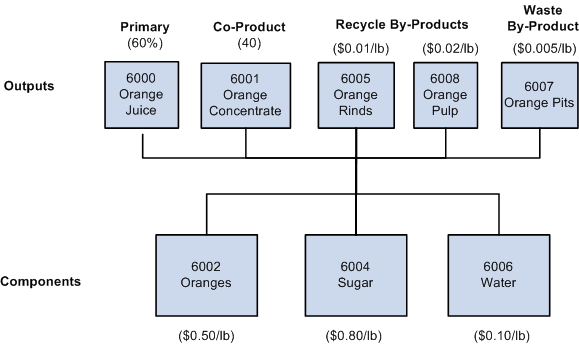

This diagram illustrates an example of a cost rollup with multiple outputs.
In this example for orange juice processing, you have these outputs: primary (orange juice), co-product (orange concentrate), recycle by-products (orange rinds and orange pulp), and waste by-product (orange pits). The components are oranges, sugar, and water.
Calculate the material costs by multiplying the quantity of each component by the standard cost:
Oranges: (5lb * 0.50) = 2.50
Sugar: (1lb * 0.80) = 0.80
Water: (10Gal * 0.10) = 1.00
Total Material Costs = 4.30
Calculate the by-product costs as:
Orange Rinds: (2lb * 0.01) = -0.02 (Cost is negative, because the recycled by-products are viewed as a cost benefit.)
Orange Pulp: (1lb * 0.02) = - 0.02
Orange Pits: (2lb * 0.005) = 0.01 (Cost is positive, because it is a disposal cost.)
Total By-Product costs = - 0.03
Total Costs = Material Costs + By-Products Costs = 4.30 + (-0.03) = 4.27
To determine the primary and co-product costs, multiply the total costs by the cost percentage.
Orange Concentrate = 40% * 4.27 = 1.71
Orange Juice = 4.27 − 1.71 − 2.56
Calculate the standard cost of the primary and co-product by dividing the apportioned costs by the output quantity of each item.
