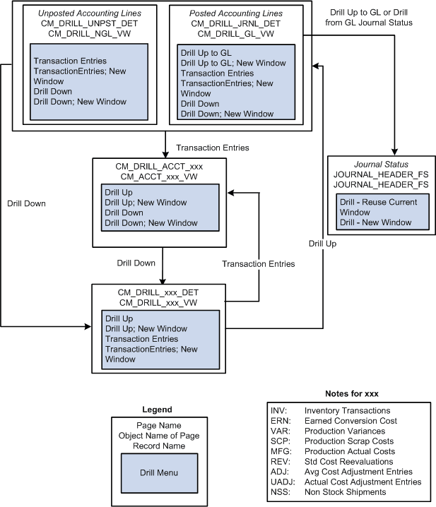

By using the financial inquiry pages, you can track financial transactions throughout the audit trail by drilling up to the journal entries and drilling down to the accounting entries. You can analyze financial transactions in a few different ways, including:
Viewing an entry in the general ledger and drilling down to the actual transaction details or entries that created the entry.
Viewing the financial transaction details or entries and drilling up to the journal entries that are created in the general ledger.
Drilling between the actual transaction detail and the accounting entries for the transaction before or after you perform the Journal Generator process.
Viewing accounting entries that are created without using the drill-up and drill-down functionality.
Generating reports that display the accounting register, inventory value, and transaction register.
Note: If you have purge or archive production data, you cannot view production-related costs such as earned labor, scrap costs or variances.
This diagram illustrates the drill up and drill down flow between transactions and accounting entries.

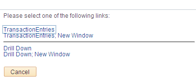

Understanding the Transfer Menu
Transfer menus enable you to navigate between the different inquiry pages. The transfer menus can vary, depending on the inquiry page. To access the transfer menu, click the View Related Links button for any account line number. This example illustrates the transfer menu that is available from the Posted Accounting Lines page in PeopleSoft Cost Management.
This example illustrates the fields and controls on the Transfer Menu Example. You can find definitions for the fields and controls later on this page.
The new window option in the transfer menu gives you the ability to have more than one window open at a time, enabling you to analyze several transactions at one time.
Drilling Down from PeopleSoft General Ledger to PeopleSoft Cost Management
The drill-down feature begins at the General Ledger inquiry pages in PeopleSoft General Ledger. Select an entry and click its View Related Links button to access a transfer menu. Select a drill option from the menu, and you can navigate to the Posted Accounting Lines page in PeopleSoft Cost Management. After you select a posted accounting line, you can use another transfer menu to access the originating transaction detail page or the transaction accounting entry page. These transaction pages give you the ability to see the transaction details or accounting entries for a selected transaction.
Drilling Up from PeopleSoft Cost Management to PeopleSoft General Ledger
When you want to trace an originating entry up to the general ledger, you can drill up. You begin by viewing the transaction detail or transaction accounting entries in PeopleSoft Cost Management. Then select the transaction and click the View Related Links button to access a transfer menu. Select Drill Up from the menu to drill up to the Posted Accounting Lines page (if the transaction is processed by the Journal Generator process) or to the Unposted Accounting Lines page (if it is not yet processed by the Journal Generator process). From the Posted Accounting Lines page in PeopleSoft Cost Management, you can drill up to journal entries by using a transfer menu. You cannot drill up to the journal entries from the Unposted Accounting Lines page because the journal entries do not yet exist for those accounting lines.
Drilling Between the Transaction Details and Transaction Accounting Entries
When you are interested in viewing the transaction detail and transaction accounting entries only within PeopleSoft Cost Management, you can drill between the different types of information. To go from the transaction details to the transaction accounting entries, you select Transaction Entries from the transfer menu. To go from the transaction accounting entries to the transaction details, you select Drill Down from the transfer menu.
