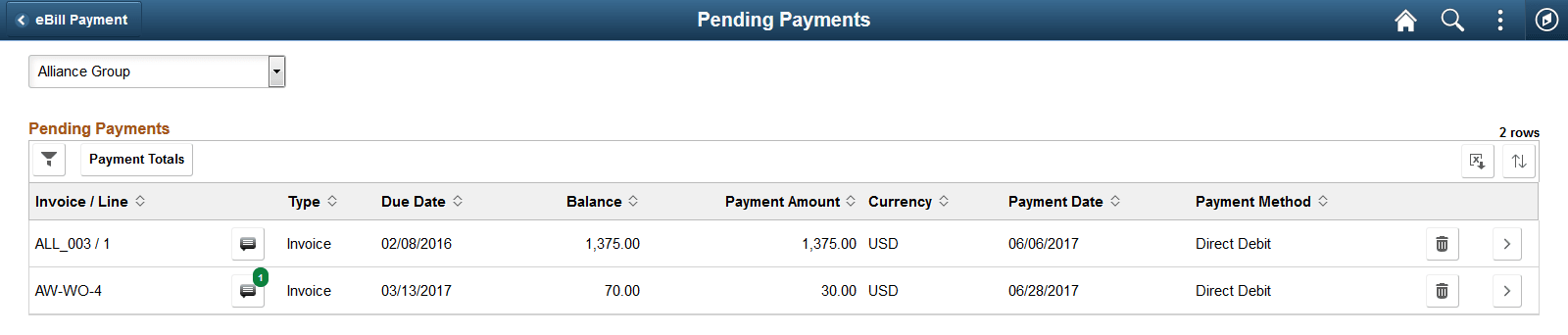

Use the Pending Payments page to review invoices submitted for payment through eBill Payment and pending processing in Receivables.

This example illustrates the fields and controls on the Pending Payments page (LFF). You can find definitions for the fields and controls later on this page.
The Pending Payments page lists invoices, including the invoice type, due date, remaining balance, payment amount and currency, payment date, and payment method.

Select the Filter Items button to open the Filter page, where you can narrow the results you see on the Pending Payments list page, as you would using a search page. |
Payment Totals (Show Payments) |
Click this button to open the Payment Amounts by Currency page (EB_PNDPYMT_TOT_SCF) where you can view the pending invoice totals for each currency and date combination. |
Select the Messages button to open the Message Center, where you can view messages regarding this invoice. The number of messages appears on the button when messages exist. |
Select the Delete button to remove a scheduled payment. This button is available only when the payment method is Direct Debit. If an invoice is removed from the pending page, it becomes available again to pay. |
Select the Detail button to view payment detail for the selected payment. |

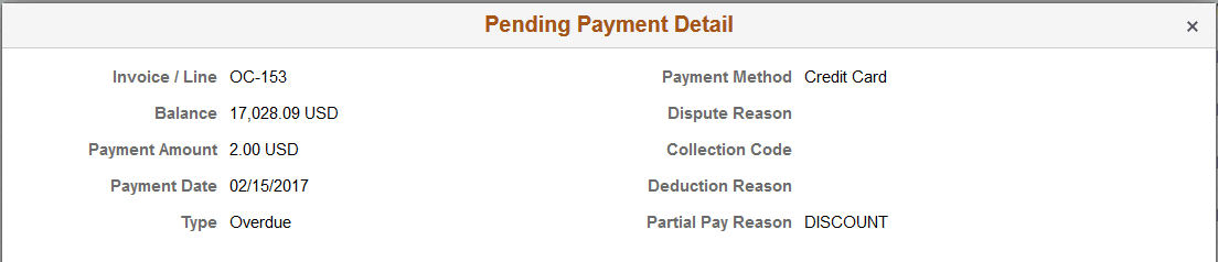

Use the Pending Payment Detail page to review payment detail information.
Navigation:
Select the Detail button for an invoice or line.
This example illustrates the fields and controls on the Pending Payment Detail page (LFF). You can find definitions for the fields and controls later on this page.
The detail shown for a pending payment includes the following:
Invoice or line ID
Balance amount of the invoice or line
Amount of the pending payment
Payment date
Invoice type
Payment method
Values for these details are shown if applicable:
Dispute reason
Collection code
Deduction reason
Partial Pay Reason
