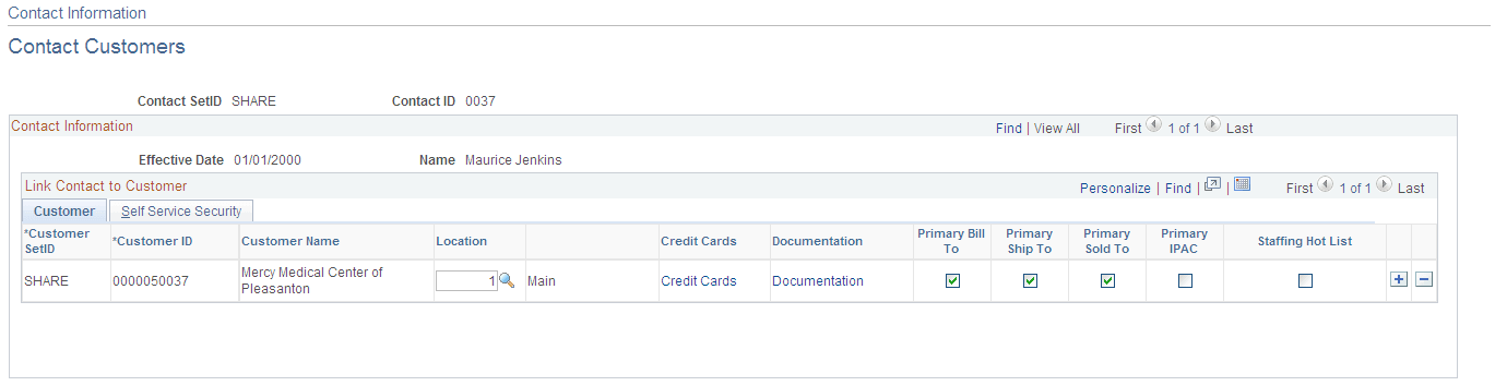

Click the Contact Customer Information link to access the Contact Customer page.
Enter the customers that are associated with the contact. The Contact Customer page contains a grid that is used to enter the customers that are associated with the contact.
This example illustrates the fields and controls on the Contact Information - Customer tab.

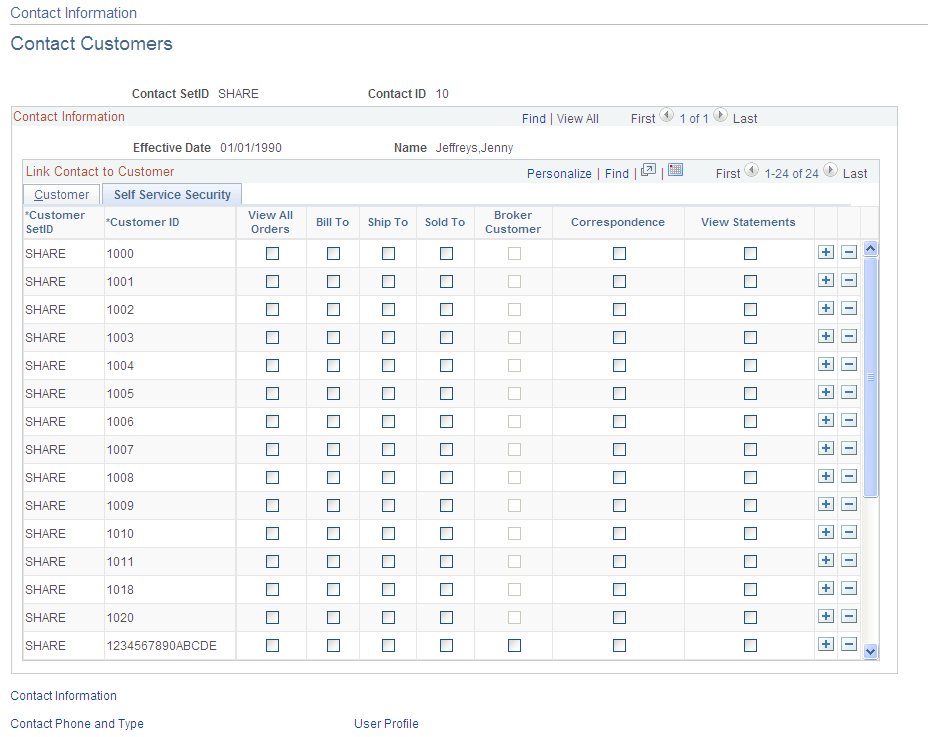

Click the Self Service Security tab.
Select the Bill To option to designate which customer data is accessible from PeopleSoft eBill Payment. When a customer contact accesses PeopleSoft eBill Payment, the system displays data for only the customers that have the Bill To option selected on the Self Service Security page. Row-level security is maintained in this manner for PeopleSoft eBill Payment users.
This example illustrates the fields and controls on the Contact Information - Self Service Security tab.
