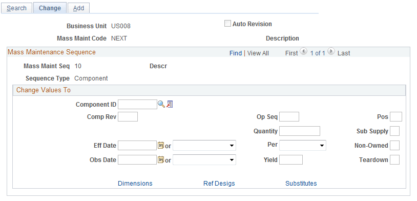

Use the BOM Mass Maintenance Codes - Change page (EN_BOM_MMC_NEW) to specify new component values, after you have selected the set of components that you want to change using the Search page.
Navigation:
This example illustrates the fields and controls on the BOM Mass Maintenance Codes - Change page. You can find definitions for the fields and controls later on this page.
Field or Control |
Description |
Component ID |
Enter a new value if you intend to change the component ID field. Note: This is typically done for correcting BOMs. To keep history of a component change, do not enter a value here. |
Output Item and Output Type |
If you selected Output, enter the required output change-to data on this page. The effectivity dates operate the same as they do for a component sequence type. |
Using Automatic Revisions and Effectivity Dates
Field or Control |
Description |
Eff Date (effective date) and Obs Date (obsolete date) |
These values determine the specific effectivity date changes that mass maintenance will make to the BOM for the searched components. For example, to obsolete components, leave the Eff Date field blank and specify an obsolete date, or use the second field next to the Obs Date field to derive an obsolete date for the component. In the second field, you can select Prior Date or Schd Date (scheduled date). For the obsolete date, Prior Date indicates the day before the scheduled date, which is the process run date. This is used, for example, to obsolete a component the day before a new component takes its place. If you select Schd Date for the effective date, then, at process time, the system translates this into the process run date. For the obsolete date, the scheduled date varies, depending on whether you selected the Auto Revision check box on the BOM Mass Maintenance Codes - Search page. If revisions aren't automatically incremented, the scheduled date is the run date of the process. If revisions are automatically incremented, the obsolete date is the obsolete date of the newly created revision. This value can be used to obsolete a component on the run date when no component is to take its place. |
Auto Revision |
If this check box is selected, and you specify the scheduled date for both the effective date and the obsolete date, the system displays a warning that the component is effective for only one day. |
Note: You can enter only one effective date or obsolete date. Therefore, if you specify a calendar date and then select Schd Date, the system clears the calendar date. Similarly, if you select a scheduled date and then enter a calendar date, the system clears the scheduled date.
This table outlines the automatic revision impact that the second set of effective date and obsolete date values have, both on revisions and the dates reflected on the BOMs. This example applies only to items that have been defined as revisions controlled on the Define Business Unit Item - Manufacturing: General page.
Also provided is an example of how the dates change on the BOM if the scheduled date is 06/15/02 on the ECO and the newly created revision is the latest revision for the item.

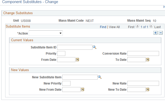

Use the Component Substitutes - Change page (EN_BOM_MMC_SUB2_SP) to change a substitute everywhere that it is used.
Navigation:
Click the Substitutes link on the BOM Mass Maintenance Codes - Change page.
This example illustrates the fields and controls on the Component Substitutes - Change page. You can find definitions for the fields and controls later on this page.
Field or Control |
Description |
Action |
Select a value:
You can add, change, and delete component substitutes in much the same manner as you add, change, and delete reference designators. However, you have more information to maintain. If adding a new substitute, specify all the required new values. If deleting a substitute, specify as many of the current values as necessary to process the deletion. If changing substitute information, enter the current and new values. For example, to delete all occurrences of LT5001 as a substitute, enter only LT5001 as the substitute item. To delete only the substitute LT5001 if it has priority 1, then enter LT5001 as the substitute item and 1 as the priority. |
Current Values
Field or Control |
Description |
Substitute Item ID |
Displays the current default value that comes from the business unit. |
Priority, Conversion Rate, From Date, and To Date |
If deleting a substitute, specify as many of the current values to process the deletion. For example, if you want to delete all occurrences of LT5001 as a substitute, then enter only LT5001 as the substitute item ID. If you want to delete the substitute LT5001 only if it has priority 1, then enter LT5001 as the substitute Item ID and 1 as the priority. If changing substitute information, enter the current values. |
New Values
Field or Control |
Description |
New Substitute Item |
Enter the value for the new substitute component. If you're adding a new substitute, specify all of the required new values. |
New Priority, New From Date, New To Date, and New Rate |
To change the parameters of the new substitute item, enter values where applicable. Otherwise, any values that you don't specify here for the new substitute item priority, effective dates, and conversion rate remain unchanged on the BOM. You can also change the parameters for the original item here. Enter only the information that you want to change. |

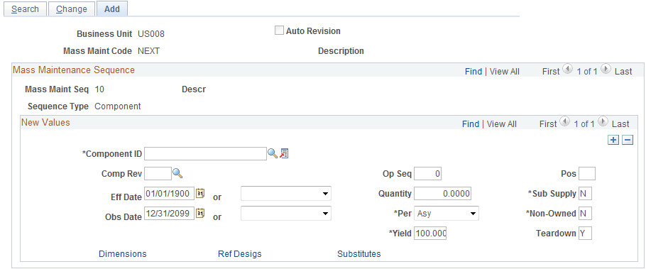

Use the BOM Mass Maintenance Codes - Add page (EN_BOM_MMC_ADD) to add components or outputs to assemblies.
The system adds these components or outputs to each BOM identified by the values that you entered on the Search page. Use the Process BOM Mass Maintenance pages to designate, at a later time, the assemblies to be affected by these changes.
Navigation:
This example illustrates the fields and controls on the BOM Mass Maintenance Codes - Add page. You can find definitions for the fields and controls later on this page.
Note: Automatic revision is operative only for items that are defined as using automatic revisions on the Define Business Unit Item - Manufacturing: General page. The system uses the ECO schedule date to create revisions when mass maintenance is used in conjunction with an ECO. It uses the run date of the mass maintenance process to create revisions when mass maintenance is run as a standalone.
Field or Control |
Description |
Component ID |
You must select a component if you selected a sequence type of Component on the BOM Mass Maintenance Codes - Search page. Enter associated values that you want to add to the selected BOMs that meet the search criteria specified on the BOM Mass Maintenance Codes - Search page. You can add multiple components per MMC. You can also add a placeholder item as a component. If the MMC is later applied to manufacturing BOMs that don't allow placeholders, then the process flags that BOM change as an exception, and the BOM won't be changed. |
If you selected a sequence type of Output on the BOM Mass Maintenance - Search page, enter values and any additional required output data. |
Note: The values that you select on these pages are subject to the same validation checks that apply to any engineering BOM or manufacturing BOM component or output values. Some of these checks occur when you create the MMC, and the remaining validation checks occur at the time that the MMC is applied.

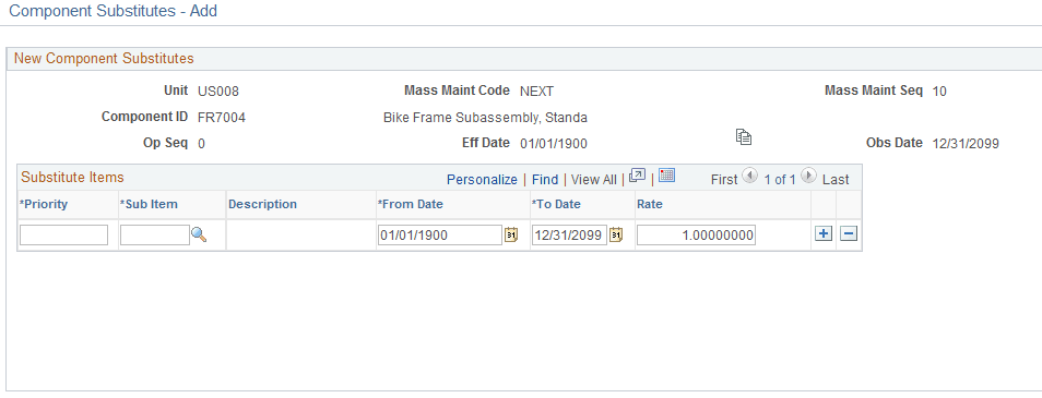

Use the Component Substitutes - Add page (EN_BOM_MMC_SUB3_SP) to add a substitute everywhere that it is required.
Navigation:
Click the Substitutes link on the BOM Mass Maintenance Codes - Add page.
This example illustrates the fields and controls on the Component Substitutes - Add page. You can find definitions for the fields and controls later on this page.
Field or Control |
Description |
Click the Copy Substitute button to display all valid substitute items for the business unit. |
OK |
Click this button to add all valid substitute items for the business unit. |
If you don't want to add all valid substitute items for the business unit, enter each individual substitute item that you want to add, as well as the priority, from date, to date, and conversion rate for each substitute.
Note: Substitute items must be unique for the item. You cannot enter the same item twice as a substitute with different dates. For example, substitute A with effective dates from 01/01/99 to 02/01/99 and substitute A with effective dates from 02/01/00 to 08/30/00 couldn't be substitutes for the same item. In this case, define a different substitute for the second set of effective dates.
