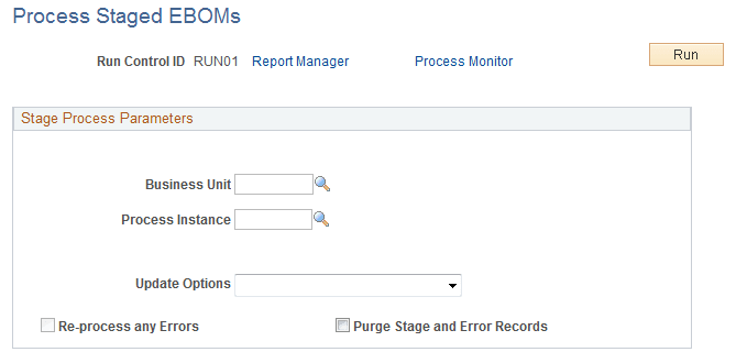

Use the Process Staged EBOMs page (EN_RUN_BOMSTAGE) to reprocess corrected staged BOMs using the MMC Stage process.
Navigation:
This example illustrates the fields and controls on the Process Staged EBOMs page. You can find definitions for the fields and controls later on this page.
Field or Control |
Description |
Update Options |
Select from:
Re-process any Errors |
If you are processing a large number of BOMs, you can correct the errors in the BOM pages but leave the status as Error. You can then select this check box while running the MMC Stage process, and the system reprocesses transactions with the statuses of New, Reprocess, and Error. If this check box is deselected, then only transactions with statuses of New and Reprocess are processed. This option is only applicable when Validate Only or Validate and Transfer is selected. |
Purge Stage and Error Records |
Select this check box to delete the error transactions from the staging table once you have run this process. If you select Validate and Transfer and you select the Purge Stage and Error Records check box here, then the BOMs are first validated and then transferred to the BOM tables. If any BOMs are invalid, the BOM tables won't be updated, but the BOMs are still deleted from the Stage and Error records. If you select None and you select the Purge Stage and Error Records check box here, then the BOMs won't be validated or changed. The Stage and Error records are purged. This combination can be used to clean up after you have completed processing BOMs. |
Run |
Click to run this request. PeopleSoft Process Scheduler runs the MMC Stage process at user-defined intervals. |
