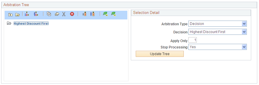

Arbitration Plans That Apply Highest/Lowest Discount Only and Then Stop
If you have more complex price rules but you only want to apply the highest/lowest discount and stop processing price rule sorting and filtering after that, then set the stop processing option.
To define an Arbitration Plan that limits the applied adjustments and then stops the arbitration process:
Add a Highest Discount First or Lowest Discount First decision to the arbitration plan.
Set the Number of Adjustments to Apply field to 1.
Select Yes in the Stop Processing field to ensure that the arbitration plan does not apply any more adjustments beyond the highest/lowest discount.
The following example defines an Arbitration Plan that limits the applied adjustments and then stops the arbitration process:
This example illustrates the fields and controls on the Example of the Arbitration Tree section of the Arbitration page showing Highest Discount First and Stop.

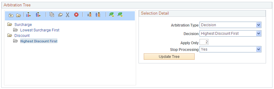

Surcharge and Discount Arbitration Plan Criteria
The following diagram shows an example in which the system selects all price rules with conditions that match the transaction and sorts them first by surcharges and then by discounts. If there are multiple surcharges, the lowest surcharge is applied first. Discounts are applied after all the surcharges are applied (highest discount first).
This example illustrates the fields and controls on the Example of the Arbitration Tree section of the Arbitration page sorted by Surcharges and then Discounts.

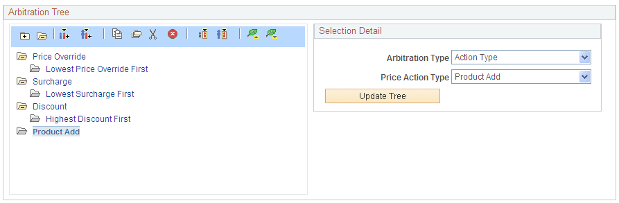

Arbitration Plans That Apply Giveaway and Price Override Rules
This example defines an arbitration plan with giveaway and price override rules:
This example illustrates the fields and controls on the Example of the Arbitration Tree section of the Arbitration page showing Product Adds.

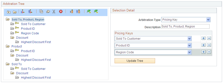

Any arbitration plan that does not have a decision point at the top level of the tree is a filter. Wherever you place the decision node in the tree is where you tell the pricing engine you do not want to further differentiate the price rules, but just apply whatever rules match the transaction at that point in the order of the decision.
For example, you want to define an arbitration plan that selects only discount price rules that match certain fields in a transaction. In this case, you define the order in which the matching price rules are applied to the transaction. In the following example, you want to match price rules defined only by sold-to customer, product, and region code. After the system finds the matching price rules, it first applies those rules that match all three criteria, then it applies the rules that match only the product, and then it applies any discounts defined for favorite customers.
This example shows a filter arbitration plan. A filter arbitration plan does not have a decision point at the top level of the tree.
This example illustrates the fields and controls on the Example of the Arbitration Tree section of the Arbitration page showing Filtering.
This arbitration plan considers only discount price rules that are defined by sold-to customer, product, and region; product; or sold-to customer only. It applies the formulas for those price rules in that order. If there is a tie within a node, that is, if two price rules are defined for the product ID, then the system sorts those two rules and applies the higher discount first.
In the event of two rules that match the same node in the tree, the system finds the next node that is used for each rule until a different node is used by each rule or a decision point is reached. When searching for the node, if the rule does not match a top-level node, it skips any child node and evaluates the next node that is at the same level or a level higher as the node that was evaluated last. If the rule does not match any node in the tree and no final decision point is defined at the top level of the tree, then the rule is ignored. Every node that is used to break a tie ends in a decision.

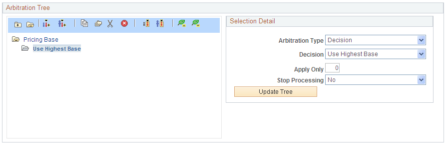

Different Pricing Base Arbitration Plan Criteria
Enterprise Pricer enables you to define the base for pricing calculations. The options are list price, cost, and alternate cost. You can build the arbitration plan to select the base from these criteria:
Use Highest Base.
Use Lowest Base.
Use List Price as Base.
Use Cost as Base.
Use Alternate Cost as Base.
Under this option, Enterprise Pricer sorts the based pricing base price rules to determine the base to use.
This example shows the first top-level node in the arbitration plan indicating that the system should use the highest base for pricing calculations:
This example illustrates the fields and controls on the Example of the Arbitration Tree section of the Arbitration page showing Base for Pricing Calculations.
During the order arbitration process, the system locates the cost plus price for the product, the list price, and the alternate cost for the product; the highest of the three is used as the basis for all pricing calculations.

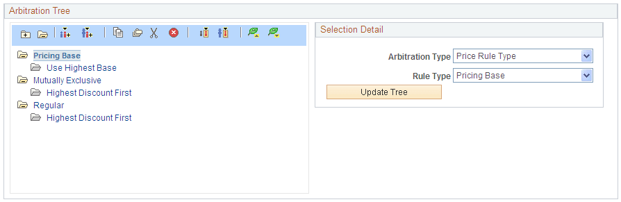

Mutually Exclusive Price Rules Arbitration Plan Criteria
Enterprise Pricer enables you to create price rules that are mutually exclusive in nature. This means that the mutually exclusive price rule wins out over all other promotional discounts and is the only price rule applied to the order line. If, during arbitration, there are multiple mutually exclusive price rules matching the arbitration plan only the first mutually exclusive price rule is applied. All other price rules are ignored, including the normal price rule that is sorted before the applied mutually exclusive rule.
Note: Since mutually exclusive price rules exclude other regular rules; the Stop flags on those price rules do not stop the mutually exclusive price rules from being applied. At most, one mutually exclusive price rule per order and one per schedule is present.
You use the Price Rule Type arbitration type to set up a branch to sort only the mutually exclusive price rules. You set up a separate branch to sort the non-mutually exclusive price rules.
For example, you use mutually exclusive price rules to define exceptional promotions aimed at increasing the total units purchased and the total order value. You create a price rule that specifies orders more than 50,000 USD and 1000 units combined receive a discount of 25 percent. When you define the arbitration plan, you set up a separate branch, ideally at the same level as the pricing base node, to sort the mutually exclusive price rules.
When Enterprise Pricer sorts and filters the price rules, it locates the matching mutually exclusive rule, goes to the branch containing the mutually exclusive price rule, and applies only that first mutually exclusive rule to the order. This example shows a mutually exclusive price rule:
This example illustrates the fields and controls on the Example of the Arbitration Tree section of the Arbitration page showing Mutually Exclusive Branching.

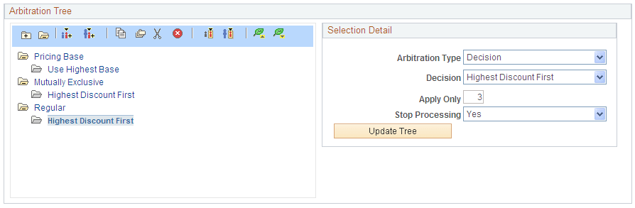

Apply Only "X" Number of Discounts Arbitration Plan Criteria
Numerous discounts might apply to a given order line. However, business needs can dictate that you only want to apply a specific number of discounts rather than every applicable discount located by the arbitration plan.
Note: This option is only available for the Decision arbitration type.
For example, you decide not to allow customers to receive more than three discounts on a decision point:
Select the Decision arbitration type.
Select the decision sorting order; for our example, select Highest Discount First.
Set the Apply Only field to 3.
Set the Stop Processing field to Yes.
Click Update Tree.
The following example shows an arbitration tree for which the number of discounts to be applied is specified rather than allowing the system to apply all the discounts found by the arbitration plan:
This example illustrates the fields and controls on the Example of the Arbitration Tree section of the Arbitration page showing X Number of Discounts.

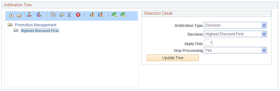

Trade Promotion Only Arbitration Plan Criteria
Enterprise Pricer enables you to build arbitration plans to ensure that, if trade promotions exist, those promotions are the only ones considered during arbitration.
For example, you have both trade promotions and company funded promotions. You want the system to apply the trade promotions only if matches are found during arbitration.
This is the process for building arbitration plans:
On the first branch of the arbitration plan, select the Price Rule Source arbitration type.
Select Promotion from the Source drop-down list box.
For the second node of the arbitration plan, select the arbitration type and the Highest Discount First decision.
Set the Apply Only field to 1.
Click Update Tree.
The following example shows an arbitration tree for which matching promotional price rules are used and all regular price rules are ignored:
This example illustrates the fields and controls on the Example of the Arbitration Tree section of the Arbitration page showing Promotions Only.
Placement of certain price action types in the arbitration tree will not affect the order in which the adjustment is applied to the transaction, but it might affect the Stop Processing Here option selected in the price rule. These price action types are:
Summed
Adjustments are always summed and applied after all other adjustments are made.
Total Order Discounts/Surcharges
Adjustments are always summed and applied to the total order value after all other line level adjustments are made.
At the end of the arbitration process, any matched product adds are stored. Subsequently, the matching product adds are available for selection by the CSR to add to the order, for example, in PeopleSoft Order Management online order entry.
