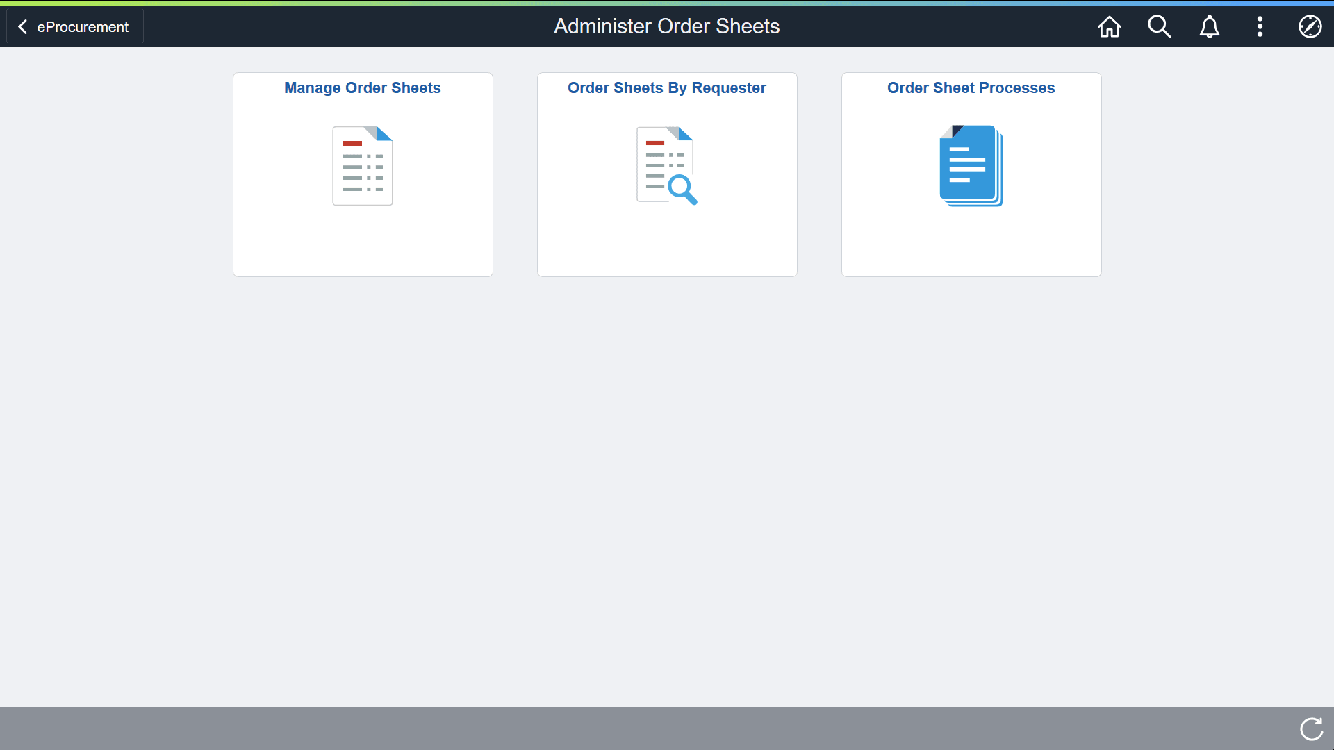

You can navigate to the Personalize Homepage, and add the Administer Order Sheets tile to the required home page, if it does not display even after you are assigned to the Permission List.
Use the Administer Order Sheets tile to access the Manage Order Sheets, Order Sheets By Requester, and Order Sheet Processes tiles for creating and managing order sheets.
This example illustrates the fields and controls on the Administer Order Sheets Tiles.

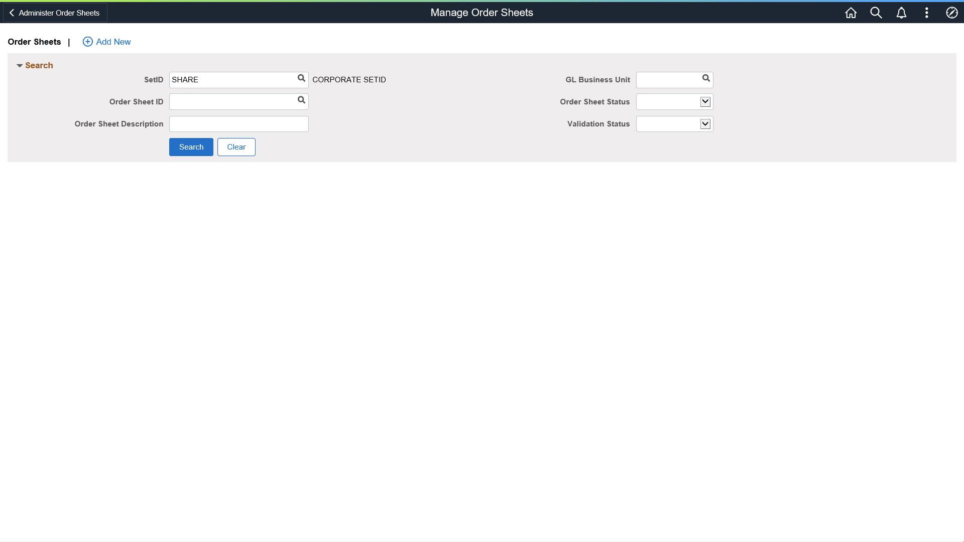

Use the Manage Order Sheets page (PV_OS_MANAGE_FL) to search for existing order sheets and to create order sheets at the Set ID level for the authorized GL business units.
Navigation:
This example illustrates the fields and controls on the Manage Order Sheets Page. You can find definitions for the fields and controls later on this page.
Field or Control |
Description |
Add New |
Click this link to add new order sheets. For more information on creating a new order sheet, see Create Order Sheet Page. |
Search |
Click the Search button after entering the required search criteria. The results display existing order sheets. |

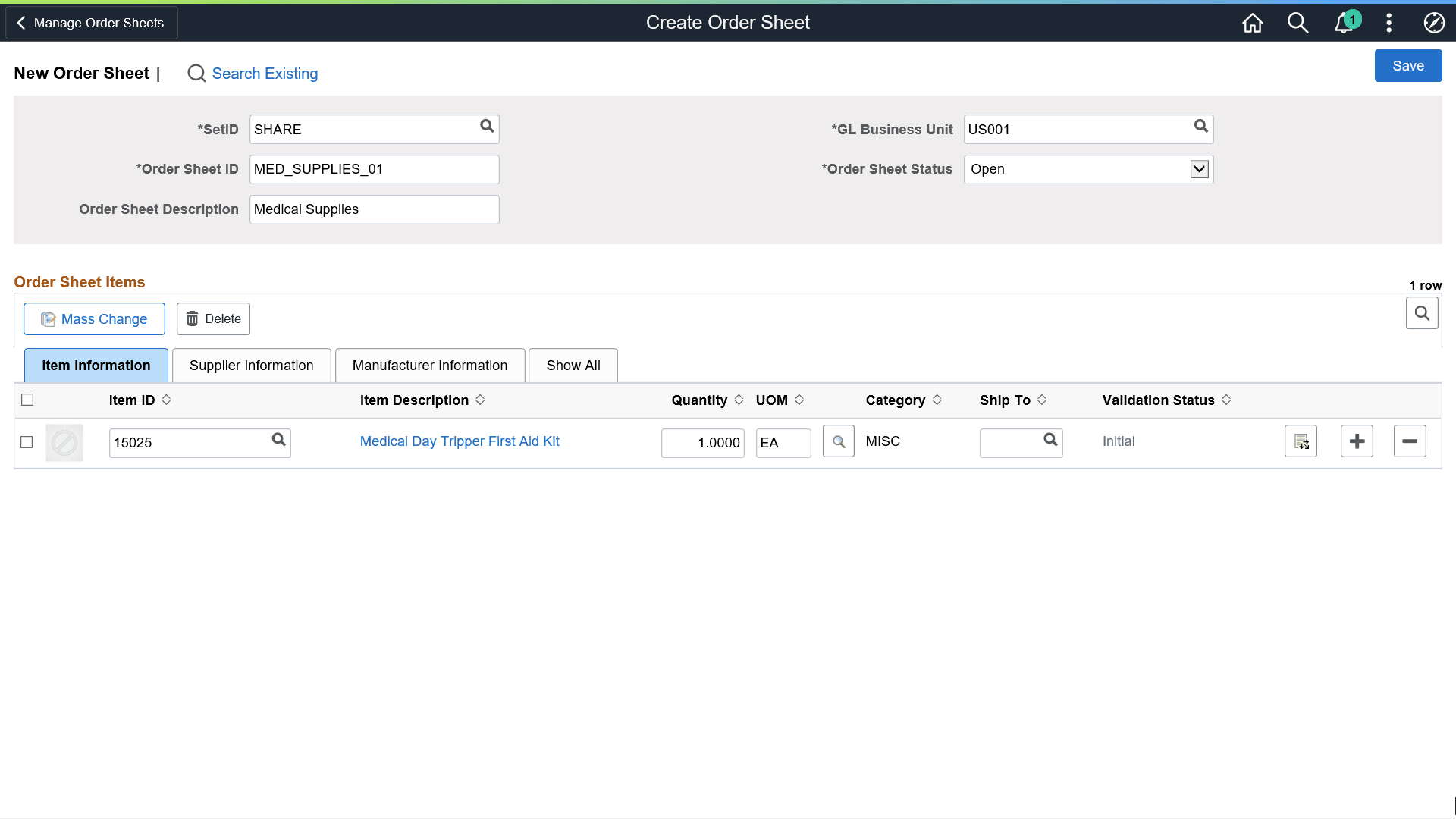

Use the Create Order Sheet page (PV_OS_CREATE_FL) to create order sheets at the Set ID level for the authorized GL business units.
Navigation:
Click the Add New button on the Manage Order Sheets page.
This example illustrates the fields and controls on the Create Order Sheet Page. You can find definitions for the fields and controls later on this page.
Field or Control |
Description |
Set ID |
Select the Set ID. It is a mandatory field. |
Order Sheet ID |
Enter a unique order sheet ID. |
Order Sheet Description |
Enter an order sheet description. |
GL Business Unit |
Select the GL business unit. The prompt lists all the business units according to the Set ID. |
Order Sheet Status |
Select the order sheet status from the options available: Active, Inactive, Open. By default, the order sheet status is Open. Note: The status of an order sheet must be Active to be used while creating a requisition. When the order sheet is completely defined and requesters are authorized to it, set the status to Active so that it will be available to the designated requesters while creating requisitions. |
Next, you can enter the item, supplier, and manufacturer details. As you select an item, the tabs automatically populate values (except Ship To) based on the inventory item definition and purchase item attributes.

Click the Save button to save the order sheet. When you save an order sheet, the system validates all the line items and their accounting lines. The validation status changes from Initial to Valid.
As part of validation, the system validates:
Whether the item is active or not.
The Item Vendor setup is valid or not.
The UOM exists in the Inventory UOM table and the Item Vendor UOM table.
The ChartField combinations.
If any issues occur, the status changes to Error. Click the Error link to view more details. The Show Validation Errors page displays the error description for each order sheet line. You must manually fix the errors on the Edit Order Sheet page or use the mass change option.
Upon saving, the Set ID, Order Sheet ID, and GL Business Unit fields become disabled. The administrator can change the header status to Active if the order sheet is ready for requisition.

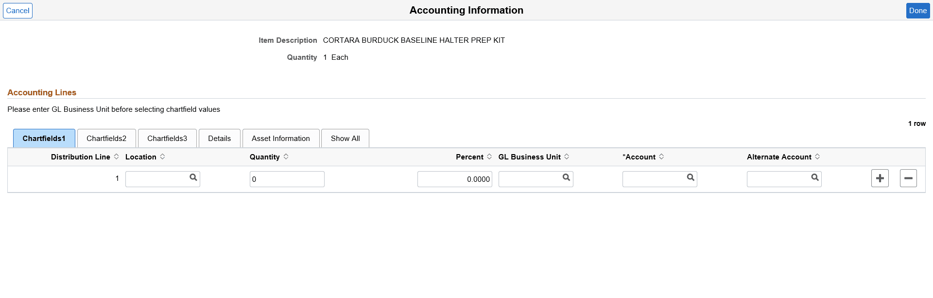

Use the Accounting Information page (PV_OS_DISTRIB_SCF) to create order sheets with one or more distribution lines.
Navigation:
Select the Add Distribution Lines icon on the Create Order Sheet page.
This example illustrates the fields and controls on the Accounting Information Page.
All accounting lines are quantity and percentage based.
Note: If you have selected the Edit ChartField Combinations check box on the Fluid installation Settings page, you cannot save the order sheets with invalid ChartField combinations. An error message will be displayed asking you to correct invalid combinations.

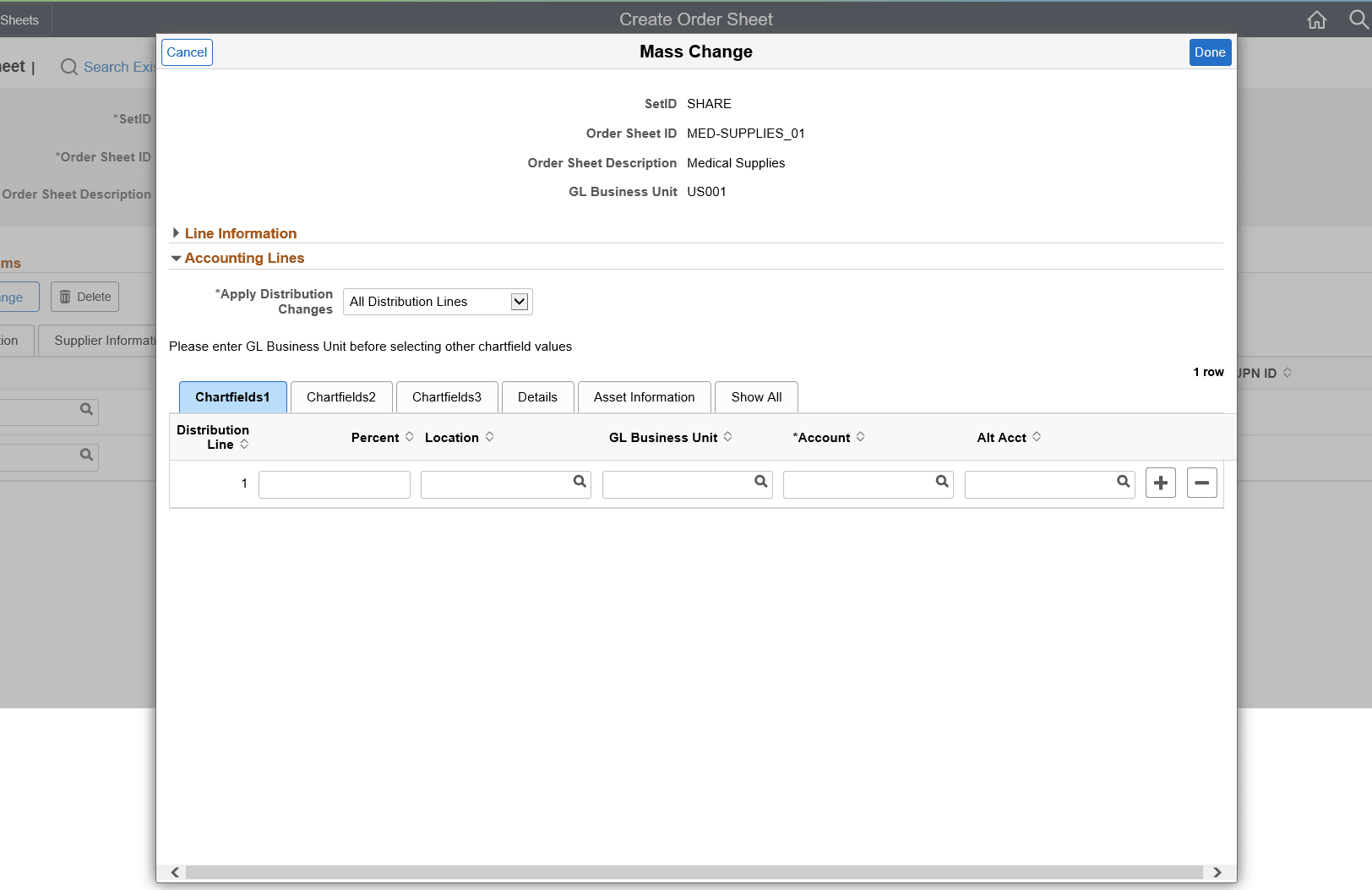

Use the Mass Change page (PV_OS_MASS_SCF) to mass update multiple order sheet item details at the same time.
Navigation:
Click the Mass Change button on the Create Order Sheet page.
This example illustrates the fields and controls on the Mass Change Page.
Make the required changes and click the Done button to save your changes.
For more information on mass change, see Edit Lines/Shipping/Accounting for Selected Lines Page.

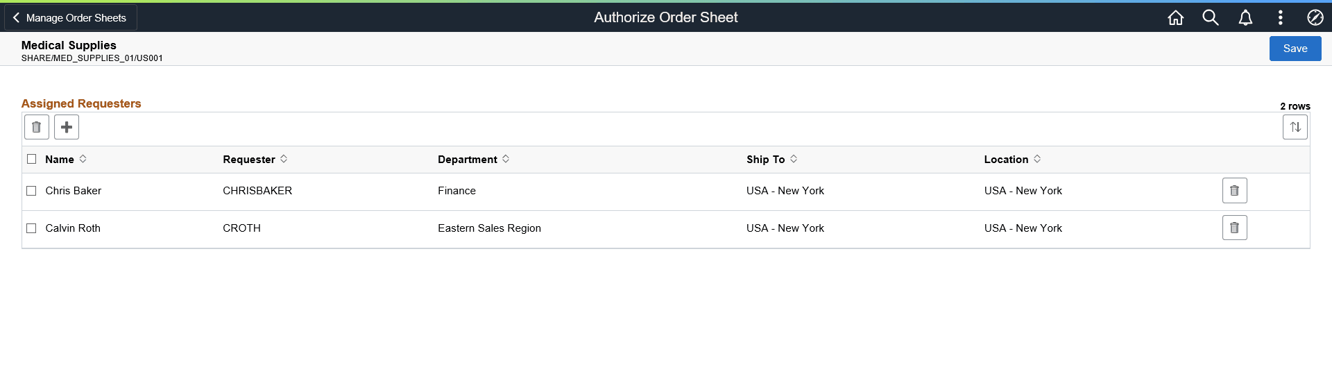

Use the Authorize Order Sheet page (PV_OS_SECURITY_FL) to authorize requesters to the created order sheets. You can authorize multiple requesters to an order sheet. The GL business unit that a requester can access is determined by the GL Business Unit value specified on the Requester Setup page - ChartFields grid.
Navigation:
Click the Related Actions icon on the Manage Order Sheet page and select Authorize.
This example illustrates the fields and controls on the Authorize Order Sheet Page.
The page displays the list of assigned requesters, if any. The page header displays the Order Sheet Description, Set ID, Order Sheet ID, and GL Business Unit.
You can authorize new requesters to the order sheet and delete existing requesters.

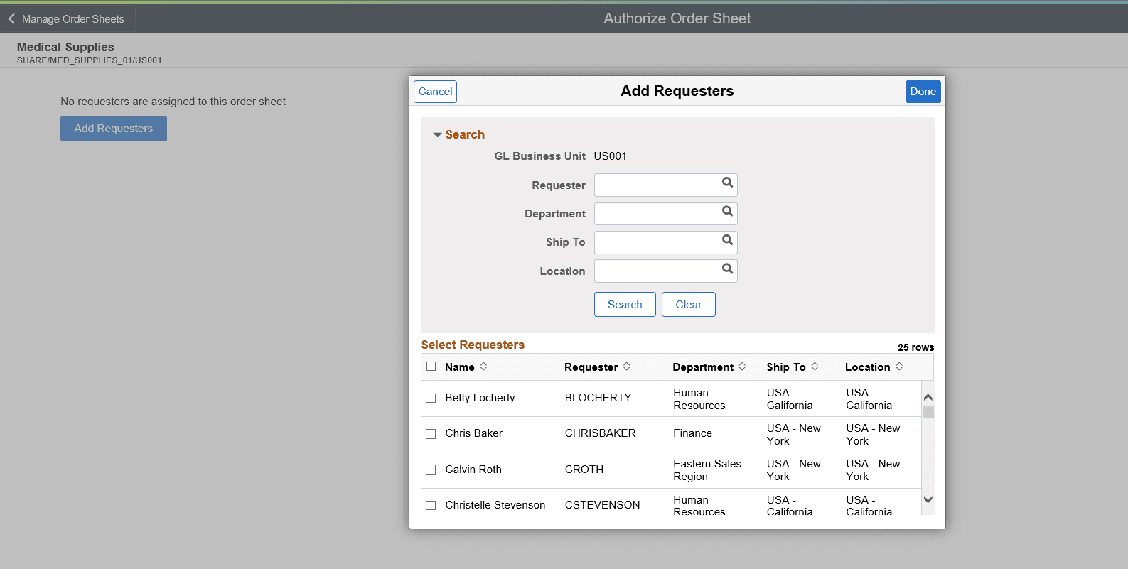

Use the Add Requesters page (PV_OS_SEC_ADD_SCF) to search for requesters authorized to the GL business unit and assign them to the order sheets.
Navigation:
Click the Add button on the Authorize Order Sheet page.
This example illustrates the fields and controls on the Add Requesters Page.
The search results display all the requesters associated to the GL business unit. It does not include those who are already authorized to the order sheet. The administrator can select one or more requesters. After selecting the requesters, click the Done button. On the Authorize Order Sheet page, click Save to finalize your selection.
Note: The Requester Setup page determines if a requester is associated with the particular GL business unit. To authorize a requester to order sheets for more than one GL business units, you must change the default settings on the Requester Setup page.
For more information about the Requester Setup page, see Requester Setup Page.

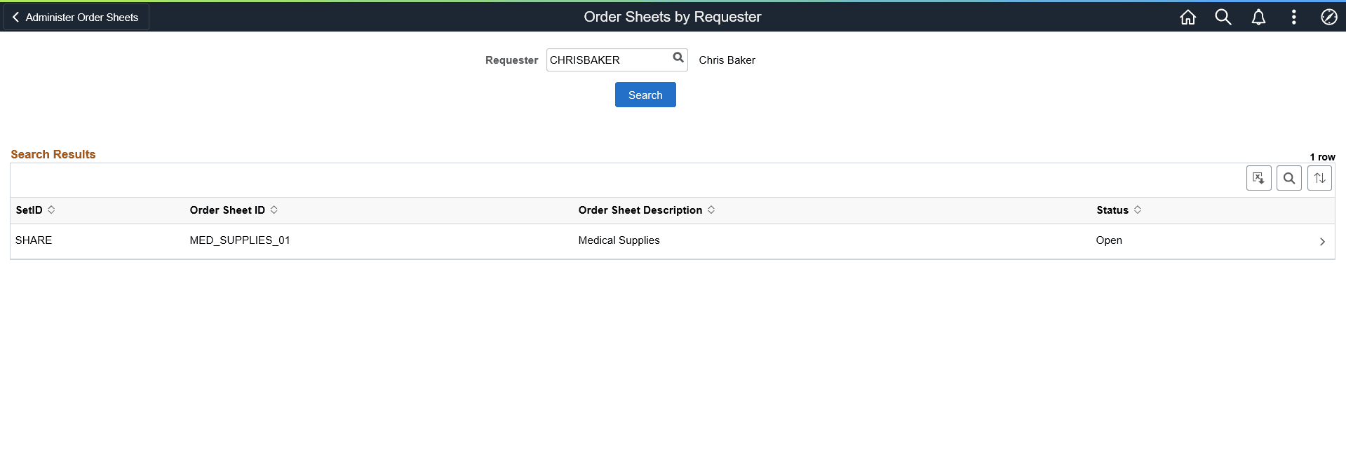

Use the Order Sheets by Requester page (PV_OS_INQUIRY_FL) to search for order sheets by the authorized requesters. The search results include all the order sheets that belong to the assigned GL business unit and that are authorized to the particular requester.
Navigation:
This example illustrates the fields and controls on the Order Sheets by Requester Page.
On this page, you can view the Set ID, Order Sheet ID, Order Sheet Description, and Status. To view more information about an order sheet, click its Details icon.

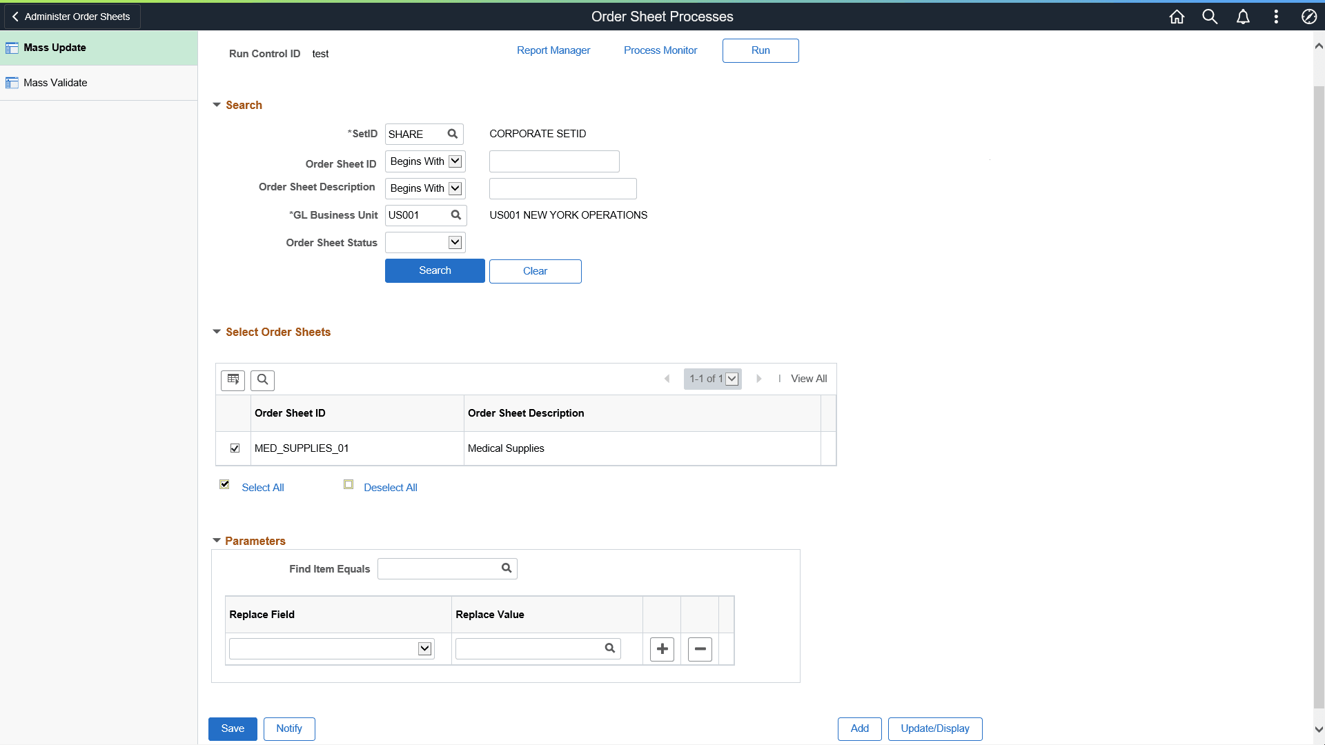

Use the Order Sheet Processes page (Navigation Collection) to run Mass Update and Mass Validate processes.
Navigation:
This example illustrates the fields and controls on the Order Sheets Processes - Mass Update Page. You can find definitions for the fields and controls later on this page.
To run a new mass update process, add or select a Run Control ID. Enter the required search criteria and search for the required order sheet.
Field or Control |
Description |
Find Item Equals |
Enter or select the required item. |
Replace Field |
Select the field to be replaced in the order sheet from the drop-down list. Values are:
Replace Value |
Select the new value. You can add more items to be replaced. The same Replace Field value cannot be selected more than once. Note: Be cautious when using the Mass Update option. The Replace Value must meet the requirements for the selected Replace field. |
Click the Run button to run the mass update process. In the Process Scheduler Request window, click OK to continue. Check the process monitor to view the change report that shows all the order sheets and the lines that have changed.

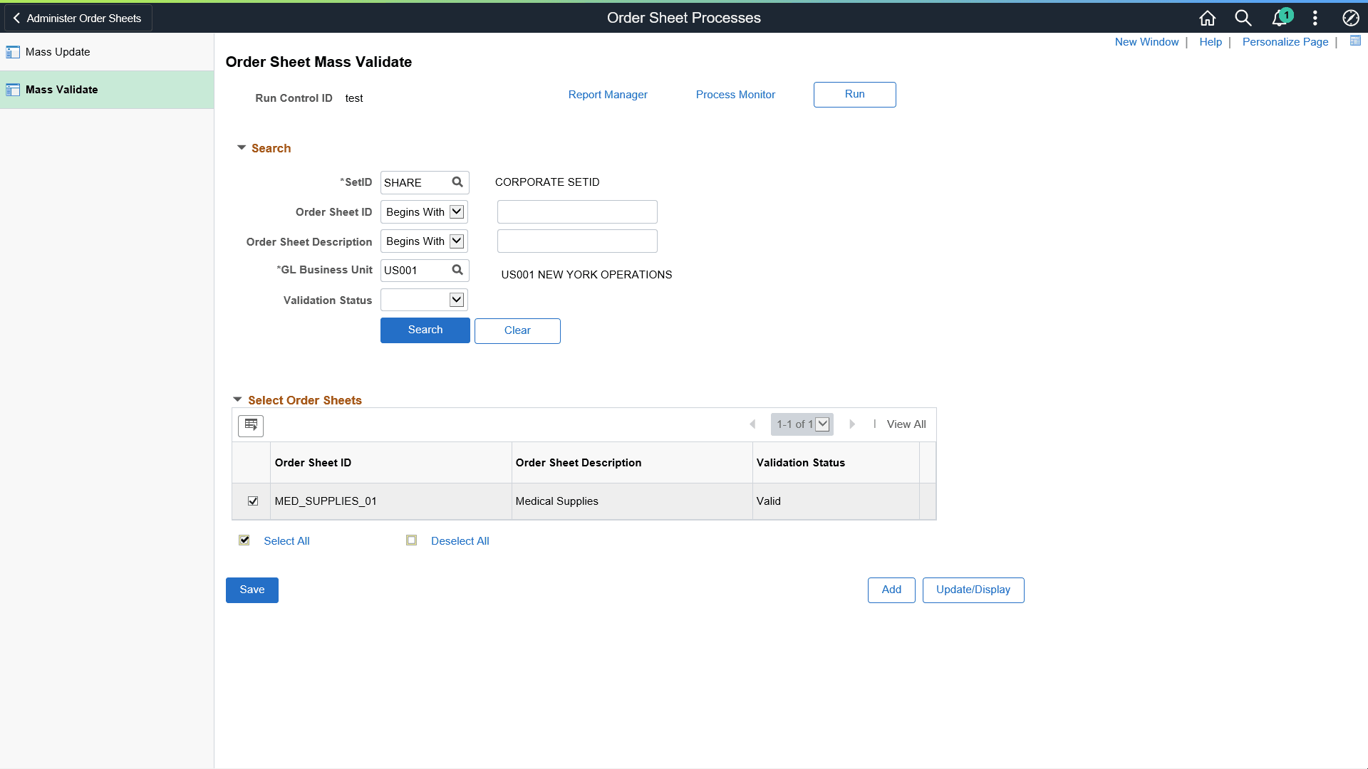

This example illustrates the fields and controls on the Order Sheets Processes - Mass Validate Page.
You must select at least one order sheet to run the Mass Validate process. Then, click the Run button to run the mass validate process. In the Process Scheduler Request window, click OK to continue. Check the process monitor to view the change report that shows all the order sheets that have been mass validated.
