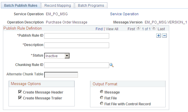

Use the Batch Publish Rules page (EO_MSGPUBATCH) to define batch publishing rules that determine how the dynamic dispatch transactions should be sent electronically.
Navigation:
This example illustrates the fields and controls on the Batch Publish Rules page.
Use this page to associate a rule to a message and characterize the rule.
Batch publish rules describe jobs or processes that run independently from their initiating process. A batch process can also run at one or more predetermined times in the future from the initiating request. This is appropriate for publishing incremental changes to data in a batch environment or when processing large volumes.

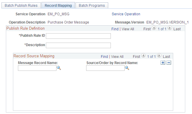

Use the Record Mapping page (EO_MSGRECMAP) to specify source data for records (such as POs) in messages.
Navigation:
This example illustrates the fields and controls on the Record Mapping page.
Use this page to map the Message Record Name to the Source/Order by Record Name.

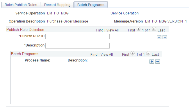

Use the Batch Programs page (EO_MSGBATPGM) to associate publish processes with rules.
Navigation:
This example illustrates the fields and controls on the Batch Programs page.
Use this page to assign an application program (PROCESS_NAME) to the publish rule.
