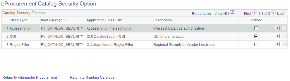

Use the eProcurement Catalog Security Option page (PV_CAT_FACTORY) to Define catalog security options.
These are system wide access policies and GUI formats for the rule-based item catalog method.
Navigation:
eProcurement > Administer Procurement > Maintain Catalogs > eProcurement Catalog Security Option
This example illustrates the fields and controls on the eProcurement Catalog Security Options page. You can find definitions for the fields and controls later on this page.
Use this page to define the access policy for the item catalogs and the GUI presentation for the Catalog Securities component. If you customize the access policy or GUI presentation, then insert a new row with a new implementation application class.
See PeopleTools: PeopleCode Developer's Guide
Field or Control
Description
Class Type
Enter the interface classes to be used of access policy and GUI presentation. The system is delivered with the class types already defined. However, you can customize and add versions of these classes. The system delivered classes are:
  1. AccessPolicy: Defines the processing logic for item catalogs to be accessed by a user.
    When a requester is entering a requisition, the available items are limited based on this logic. This class type enables the system to retrieve only the items that are authorized by all applicable security types.
  2. GUI: Defines the GUI presentation for the Catalog Security component (PV_CAT_SECURITY).
    It provides an interface, where you can create a customized page layout for the Catalog Security page by implementing an implementation application class.
  3. RegionalFilter: Defines regional item and supplier security for item browsing and searching.
Root Package ID
Select the package of the PeopleCode class that you created.
Application Class Path
Enter an application class to further define the implementation (class types). You must enter implementation application classes for the class types of AccessPolicy and GUI. The system is delivered with two implementation application classes. You can override these with custom versions.
  1. IntersectPolicy (for the AccessPolicy class type): Defines how item catalogs are to be accessed by a user.
    This application class limits a requester to viewing item catalogs that are included in all security types used. In other words, it is the intersection of item catalogs retrieved by all security types. If you decide that the environment requires a different approach to item retrieval, then you can define an implementation application class.
  2. CatalogSecurityGUI (for GUI class type): Defines the layout of the pages in the Catalog Security component.
    If you want to have a different GUI presentation, create a new implementation application class.
  3. Catalogs:SupplierRegionFilter: Defines regional security by supplier locations.
Description
Enter a brief description of the purpose of the class type and implementation application class.
Enabled
Select to activate the class type and implementation application class combination for the row. Do not select this check box until you have completed the system setup for item catalog security.

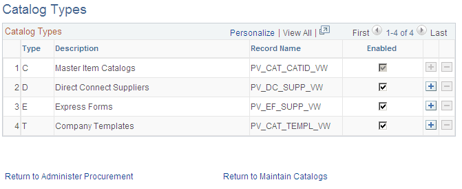

Use the Catalog Types page (PV_CAT_SOURCE) to define catalog types.
Navigation:
eProcurement > Administer Procurement > Maintain Catalogs > Catalog Types
This example illustrates the fields and controls on the Catalog Types page. You can find definitions for the fields and controls later on this page.
Catalog Types page
Use this page to identify the types of item sources that should be available for requisition entry or retrieved by the search and browse feature. Enter all catalog types for use across the organization; this page applies system wide. The catalog types enabled on this page appear in the Catalog Type field on the Catalog Security page.
Field or Control
Description
Type
Enter the catalog type. Use one or more of these options:
  • C: Items located in the PeopleSoft Item Master table. This can include items from the marketplace or the express catalog.
  • D: Items from direct connect suppliers.
  • E: Express forms.
  • T: Company templates.
Record Name
Enter the record definition that contains all the values for the item source. The system is delivered with the record names for the Item Master table, direct connect suppliers, express forms, and business templates. You can change this record name if you are customizing this area.
Enabled
Select to authorize access to this item source on the Catalog Security page. The system automatically changes to Y (yes) for type C and to N (no) for all other catalog types.

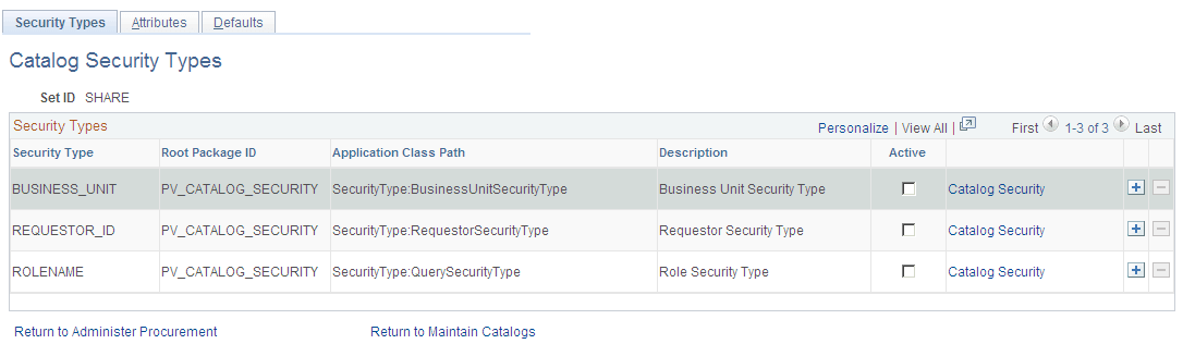

Use the Catalog Security Types page (PV_CAT_SEC_TYPE) to define catalog security types.
These are levels at which you apply catalog security, for example, at the user role level or the individual requester level.
Navigation:
eProcurement > Administer Procurement > Maintain Catalogs > Catalog Security Types
This example illustrates the fields and controls on the Catalog Security Types page. You can find definitions for the fields and controls later on this page.
Use this page to define the levels where security should be applied. For example, suppose that the items available should be restricted by the business unit used to enter the requisition, then activate the row for business unit on this page. You can have multiple security levels defined.
The system is delivered with three security types, business unit, requester ID, and role name. You can add additional security types, for example, ship to location, by inserting a new row on this page. When a user enters a requisition, the list of authorized item catalogs is the intersection of the catalogs granted to each of the security types.
Field or Control
Description
Security Type
Enter a descriptive name for the security type. The system is delivered with BUSINESS_UNIT, REQUESTOR_ID, and ROLENAME.
Root Package ID
Enter the parent application package.
Enter an interface class that contains the processing logic for the security type. The system is delivered with BusinesUnitSecurityType, RequestorSecurityType, and QuerySecurityType. The implementation application classes for business unit and requester are specific to those security types and link them into the existing item catalog security system using the Assign Catalog to Business Unit page and the Requestor Setup page. However, the QuerySecurityType is not specific to the user role name and can be used with any additional security types that you may add to this page. For example, suppose that you decide to add a ship to location as a security type, then you can use the QuerySecurityType class for both role name and ship to.
Description
Enter a description of the security type.
Active
Select to enable this security type for the SetID. If you select this for the security type of BUSINESS_UNIT, then the system:
  1. Selects the BU Catalog Control check box on the eProcurement Installation Options page and makes it unavailable for selection.
  2. Looks to the Assign Catalog to Business Unit page, as well as the Catalog Security page, to determine the authorized item catalogs.
If you activate the security type REQUESTOR_ID, then the system:
  1. Looks to the Requestor Setup page, as well as the Catalog Security page, to determine the authorized item catalogs.
  2. Does not use the Default Access field on the Security Type Attributes page.
Catalog Security
Click to access the Category Security page, where you can update security parameters.

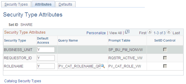

Security Type Attributes Page
Use the Security Type Attributes page (PV_CAT_ST_ATTR) to define security type attributes which include query or prompt tables used.
Navigation:
Click the Attributes tab.
This example illustrates the fields and controls on the Security Type Attributes page. You can find definitions for the fields and controls later on this page.
Use this page to define the attributes for each of the security levels that you defined on the Security Types page.
Field or Control
Description
Default Access
Determines access to catalogs when no data entry found for the security type in Catalog Security page. Enter Y to access all item catalogs and enter N for no access to item catalogs. For example, for the security type of business unit, if you do not enter the business unit AUS01 on the Catalog Security page, then a default access value of Y gives AUS01 access to all item catalogs; However, a default access value of N gives AUS01 no access to any item catalogs. Since the system uses an intersect policy, N would prevent any entries into the business unit AUS01.
Note: The Default Access field is not applicable to the security type of REQUESTOR_ID, because the system always loads all requesters into the Catalog Security page.
Query Name
Enter a query record name to retrieve the acceptable values based on the security type record definitions. A query is required if the implementation application class on the Catalog Security Types page is the QuerySecurityType class. Design this query to retrieve the needed data to find rows. All necessary values can be retrieved based on the requisition's business unit, requester, or user ID. For example, if the ship to location is defined as a security type, then the query would be designed to retrieve the ship to based on the user ID on the User Preferences - Procurement page.
Prompt Table
Enter the prompt table to be used for this security type. A prompt table is required if the implementation application class is the system-delivered QuerySecurityType.
SetID Control
Select whether the security type query in the Query Name field is SetID controlled.

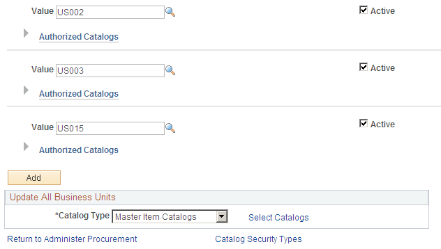

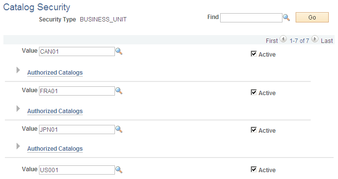

Use the Catalog Security page (PV_CAT_SECURITY) to assign authorized item catalogs to security types.
Navigation:
Click the Catalog Security link.
This example illustrates the fields and controls on the Catalog Security page (1 of 2). You can find definitions for the fields and controls later on this page.
This example illustrates the fields and controls on the Catalog Security page (2 of 2). You can find definitions for the fields and controls later on this page.
For each security type (security level), define what item catalogs are available.
Field or Control
Description
Find
Enter a value on which to search in the scroll area. Use this field when you have a large number of values in the scroll area.
Value
Select a field value that you have defined for this security type.
Active
Select to enable the item catalogs security for this value. If this value is not selected, then the Default Access field on the Security Type Attributes page is applied.
Authorized Catalogs
Click the Show Authorized Catalogs button to display or enter the set of item catalogs authorized for the value. This includes all item catalogs, no catalogs, or a specific set of catalogs. To add item catalogs, select the catalog type and click the Select Catalogs link to display all valid catalogs, then select the catalog and click the OK button. The new catalog appears in the Authorized Catalogs section.
Add
Select to add a new row to this page, so that you can enter a new value.
Update All Business Units
Use this section to add or remove item catalogs to all of the listed values. For example, if a new item catalog is created after implementation, use this feature to add the catalog to all business units, requesters, and user roles. To add or remove item catalogs, select the catalog type, use the Select Catalogs link to display all valid catalogs, then select the catalogs and click the Add To All or Remove From All button.

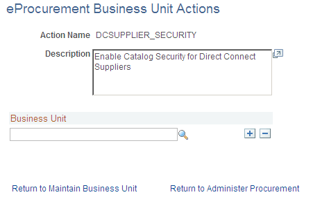

Use the eProcurement Business Unit Actions page (PV_ACTIONS_BU) to identify the PeopleSoft eProcurement actions that should be used for each business unit.
The applicable PeopleSoft eProcurement actions enable security for items from the business template, express forms, and direct connect suppliers.
Navigation:
Click the eProcurement Business Unit Actions link on the Maintain Business Units page.
This example illustrates the fields and controls on the eProcurement Business Unit Actions page. You can find definitions for the fields and controls later on this page.
If you have set up the system to control access to direct connect, express forms, or company templates, then you must identify specific business units that utilize the catalog security. For each action, you need to identify business units you wish to apply catalog security to:

Action Name
Options are:
  • DCSUPPLIER_SECURITY: Enable item security for items from direct connect suppliers
  • EXPRESSFORM_SECURITY: Enable item security to be applied to express forms.
  • TEMPLATE_SECURITY: Enable item security to be applied to business templates.
