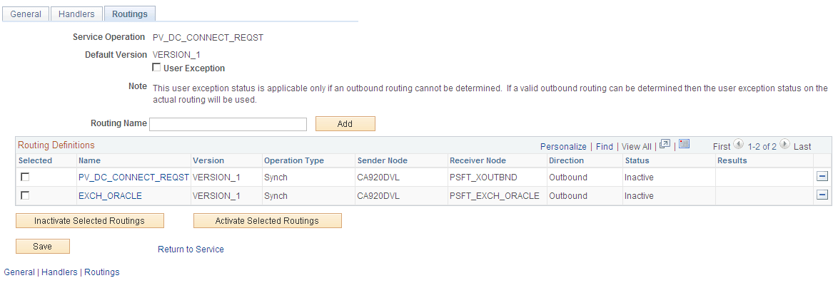

Use the Service Operations - Routings page (IB_SERVICERTNGS) to activate routing definitions used on the service operation.
Navigation:
This example illustrates the fields and controls on the Service Operations - Routings page.
On the Routings tab of the Service Operations component, activate a routing definition for each node that will send or receive data. To activate a routing, select the check box next to the routing definition and click the Activate Selected Routings button.
Note: For DirectConnect PunchOut via OBN, activate the PV_DC_OBN_REQST Routings.

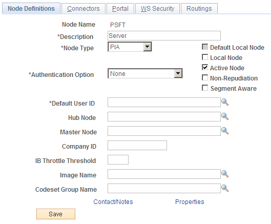

Use the Node Definitions page (IB_NODE) to create a new node or activate an existing node for each linked supplier that you utilize with direct connect.
Note: If a node is configured for direct connect purpose, the node name length must be less than or equal to 18 characters.
Navigation:
PeopleTools, Integration Broker, Integration Setup, Nodes
This example illustrates the fields and controls on the Node Definitions page. You can find definitions for the fields and controls later on this page.
For the direct connect feature, a node represents the direct connect supplier. Nodes are locations from which the system sends or receives service operations. Nodes can also be an application, a database, or a server. Multiple nodes can share the same local gateway, which might be the only gateway you will need for all integrations. When a node is linked to a particular service operation, the relationship is called a routing.
Set up a node for each direct connect supplier. For those suppliers who support both Punchout and Transparent Punchout, it is required to set up two nodes, one for each, as the supplier URLs are typically different.
The sample data delivered with the system includes:
The PSFT_EXCH_ORACLE node. This node is designed for access to the Exchange.oracle.com website using Punchout.
The PSFT_TPO_EXCH_ORACLE node. This node is designed for access to the Exchange.oracle.com website using Transparent Punchout.
The PSFT_ORACLE_SUPPLIER_NETWORK node. This node is designed for Punchout using OBN.
For the above nodes, you will need to provide the desired exchange environment URL address and then activate the node.

Node Type |
For direct connect suppliers, select External. |
Active Node |
Select to activate the node. Verify the Active Node check box has been selected for the node used in the routings that you activated on your Service Operations-Routings page. |
WSIL URL |
Enter the desired exchange environment URL address. |

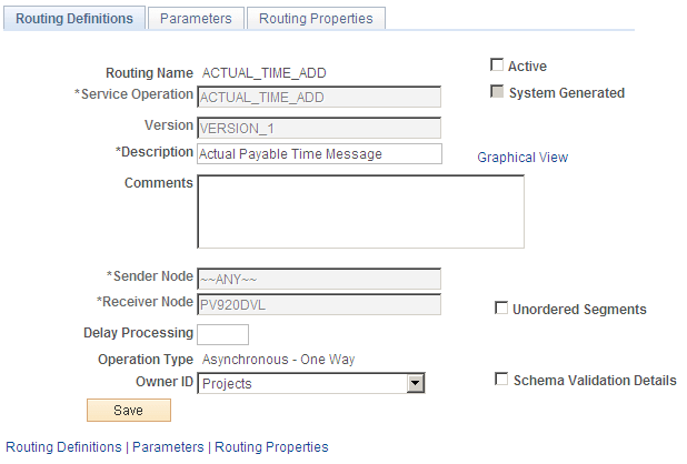

Use the Routing Definitions page (IB_ROUTINGDEFN) to set up a routing that is associated with the direct connect node.
Navigation:
PeopleTools, Integration Broker, Integration Setup, Routings
This example illustrates the fields and controls on the Routing Definitions page. You can find definitions for the fields and controls later on this page.
When a node is linked to a particular service operation, the relationship is called a routing. Each integration requires at least one routing at each PeopleSoft Integration Broker node. One node uses a routing to send a message, and one or more nodes use routings to receive the message. The sending node might apply a routing with different parameters than those applied by the nodes that receive the message, with respect to routing, transmission type, message structure, or message content.
There are four routings that are delivered in the sample data for direct connect:
The PV_DC_CONNECT_REQST routing can be altered to connect to a supplier's website.
The EXCH_ORACLE routing is designed to connect to the Exchange.oracle.com website using Punchout.
The PV_TPO_CONNECT routing is designed to connect to the Exchange.oracle.com website using Transparent Punchout. Use this routing as a model when creating routings for other Transparent Punchout suppliers.
PV_DC_OBN_REQST routing is designed to connect to OBN for Punchout.
To connect to another third-party supplier, create and activate a new routing. Create one routing for each node/supplier.

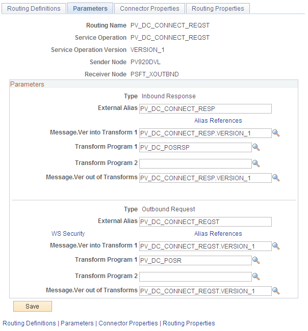

Use the Routings - Parameters page (IB_ROUTINGDEFNDOC) to set up routing parameters.
Navigation:
Click the Parameters tab.
This example illustrates the fields and controls on the Routing Parameters page.
Confirm that the external alias names in the External Alias fields for the routing are correct. When sending or receiving data, the Integration Broker determines which routing to use by referring to the external alias name, not the routing name. For routings already defined in the sample data, the External Alias fields and the transformations have already been defined.
