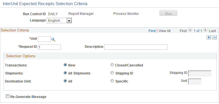

Use the Interunit Expected Receipts Selection Criteria page (IN_RUN_SHPNTC_IU) to launch the Interunit Expected Receipts outbound transaction for interunit transfer orders that have been depleted and not yet received.
Navigation:
SCM Integrations, Publish Outbound Messages. Select Interunit Expected Receipts check box on the Publish Outbound Message page to enable the Interunit Expected Receipts link. Click the Interunit Expected Receipts link.
This example illustrates the fields and controls on the InterUnit Expected Receipts Selection Criteria page. You can find definitions for the fields and controls later on this page.
| Field or Control | Description |
| Transactions | Select New to generate an expected receipt for new interunit transfer orders that have been depleted but not sent out in a previous message. Select Closed/canceled to generate an expected receipt for interunit transfer orders that have been previously sent in a message and have subsequently been closed or canceled. |
| Shipments | Select All to generate an expected receipt for all shipments for a business unit. Select Specific and enter a Shipping ID to generate an expected receipt for a specific shipping ID. |
| Shipping ID | Select a valid shipping ID. This field is available for entry only if you elect to generate an expected receipt for a specific shipment ID. |
| Destination Unit | Select All to generate an expected receipt for all destination business units. Select Specific to generate an expected receipt for a specific destination business unit. |
| Unit | Select a valid destination business unit. This field is available for entry only if you elect to generate an expected receipt for a specific destination business unit. |
| Re-Generate Message | Select this option to regenerate a message for orders that have already been sent out. |
Note: Select the Re-Generate Message check box to create a second interunit expected receipt message for selected shipments. This option is for instances where the destination node did not receive the original message.
