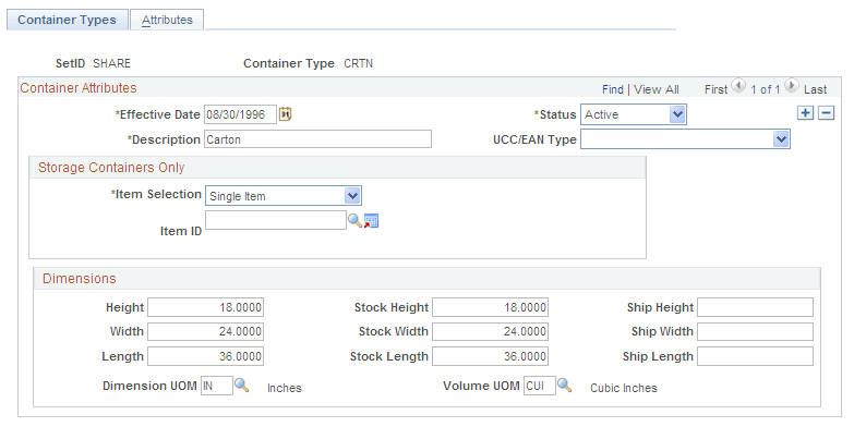

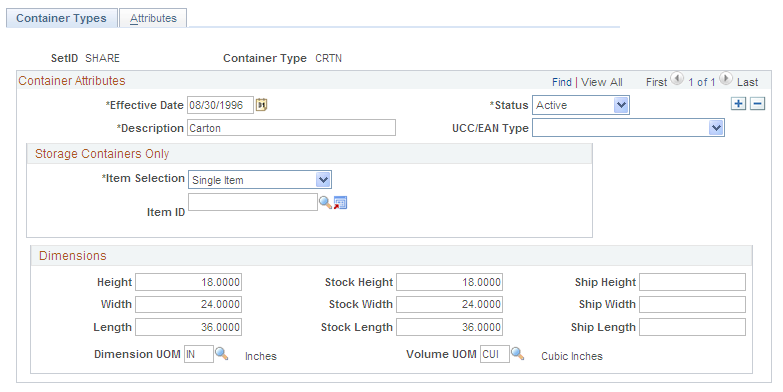

Use the Container Types page (CNTR_TYPE_INV_1) to begin defining parameters for a specific type of container.
Navigation:
This example illustrates the fields and controls on the Container Types page. You can find definitions for the fields and controls later on this page.
Before you can create either storage or shipping containers, you must establish default values for both the SetID and the business unit. You can have a variety of container types; for example, you might use both cartons and pallets.
Container Types Tab
Field or Control  |
Description  |
UCC/EAN Type  |
 If you ship containers, this information prints on the Packing Slip report. Values are: Cs/Crtn (case or carton), Intra-Comp (intracompany defined), Pallet, Truckload, or Undefined.  |
Storage Containers Only  |
 Indicate whether this is a multiple-item or single-item container type. For single-item containers, you can specify an item ID.  |
Height, Width, and Length  |
 Enter dimensions of the container itself.  |
Stock Height, Stock Width, and Stock Length  |
 Enter dimensions of the base container plus any extra material (such as packaging or straps) used to store the item.  |
Ship Height, Ship Width, and Ship Length  |
 The dimensions of the base container plus any extra material (such as packaging or straps) used to ship the container.  |
Dimension UOM (dimension unit of measure)  |
 Select a unit of measure in which to express all dimensions defined on this page.  |

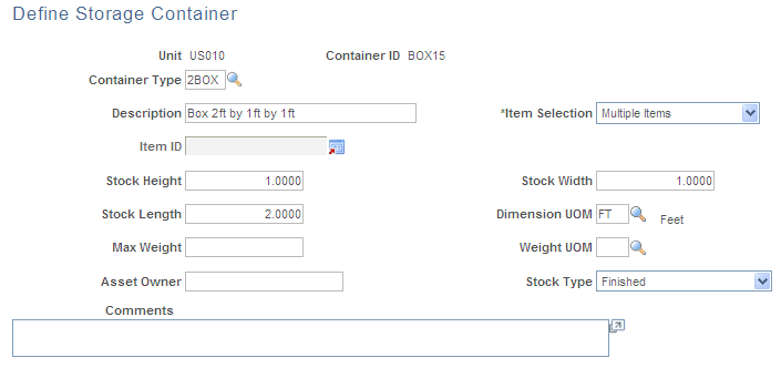

Use the Define Storage Container page (CNTR_ID_INV) to establish parameters for individual storage containers.
Navigation:
This example illustrates the fields and controls on the Define Storage Container page. You can find definitions for the fields and controls later on this page.
Use this page if the business unit requires the creation of containers before use, or to override default container values. If the business unit uses only one type of container, and the container does not require detailed attributes, you do not need to enter information here.
Field or Control  |
Description  |
Asset Owner  |
 Enter the owner of the container. This field is for reporting and inquiry purposes only.  |
Stock Type  |
 Select the type of stock stored in the container. Values are: Finished, Raw Matl (raw material), and WIP.  |

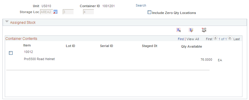

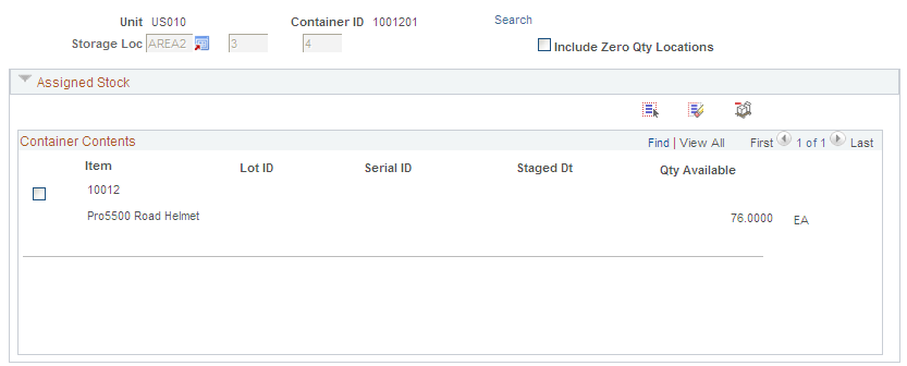

Assigned Stock  |
 Displays items currently stored in the container. To remove an item from the container, select its check box and click the Remove from Container button. The selections move to the Unassigned Stock section. When you remove an item, you can enter the item's new material storage location in the Assigned Stock section. This type of movement is similar to an item transfer.  |

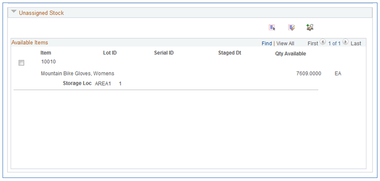

Unassigned Stock  |
 Displays items matching the search criteria. To add an item to the container, select its check box and click the Add to Container button. The selections move to the Assigned Stock section.  |
Note: You can only move items with available quantity. You can, however, move partial quantities of items, and if negative inventory is allowed, you can choose more than the quantity available by selecting the check box next to a line and overriding the quantity available). In addition, you must move owned items into owned material storage locations and non-owned items into non-owned material storage locations. Finally, to move the entire storage container to a new material storage location, use the Transfers component in the Maintain Inventory menu.
