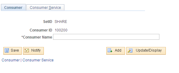

To maintain consumer data, use the Consumer Maintenance (CONSUMER_INV) component.
Use the Consumer page (CONSUMER_INV) to update basic consumer information received from a third-party consumer management system using the Consumer EIP.
Use of this page is not intended to replace an admissions system or other system that tracks consumer service activity. Consumer information can also be entered here manually; however, data entered or changed in PeopleSoft Inventory is not updated in the original system.
Navigation:
This example illustrates the fields and controls on the Consumer page. You can find definitions for the fields and controls later on this page.
To receive consumer data from a third-party consumer management system, use the Consumer Message EIP.
The consumer data on this page and stored in PeopleSoft Inventory is the minimum amount of information you need to generate meaningful reconciliation and material usage reports. This information is also sent to third-party consumer billing or costing accounting system.
Note: Ideally, the consumer information should be populated by the Consumer Message EIP. Use Add mode only as support when the third-party consumer management system is down and material usage for a new consumer must be captured.

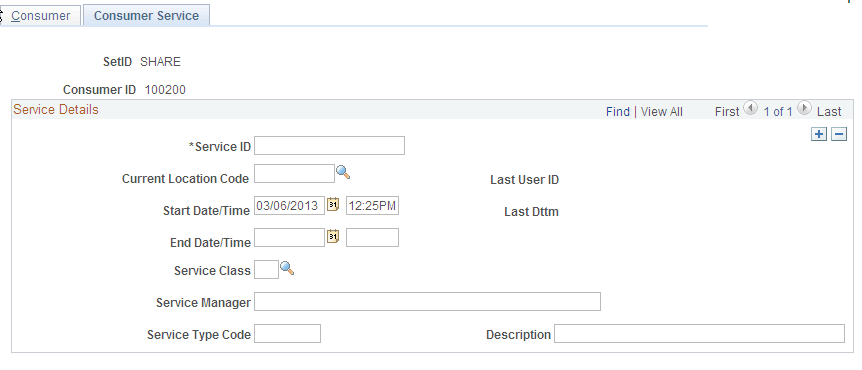

Use the Consumer Service page (CONSMR_SRVC_INV) to update basic consumer information received from a third-party consumer management system using the Consumer EIP.
This page is similar to the Consumer page.
Navigation:
This example illustrates the fields and controls on the Consumer Service page. You can find definitions for the fields and controls later on this page.
Each consumer entered in PeopleSoft Inventory has one or more service IDs. The service event associated with a service ID carries with it the values entered in the fields on this page.
