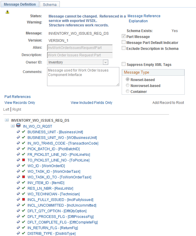

Use the Message Definition page (IB_MESSAGE_BUILDER) to view the fields to be used by the service operation within PeopleSoft Integration Broker.
In order to correctly populate the incoming data, review the message definition.
Navigation:
This example illustrates the fields and controls on the View the fields included in the message used by the INVENTORY_WO_ISSUES service operation (1 or 2). You can find definitions for the fields and controls later on this page.
This example illustrates the fields and controls on the View the fields included in the message used by the INVENTORY_WO_ISSUES service operation (2 or 2). You can find definitions for the fields and controls later on this page.

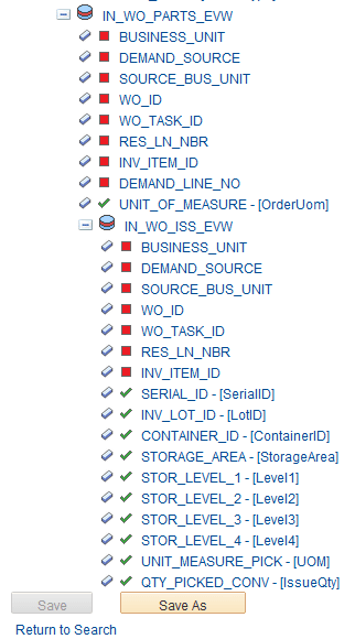

The INVENTORY_WO_ISSUES_REQ_DS message consists of three sections:
Header section: IN_WO_CI_RQST.
The header section includes information that applies to the entire transaction. It identifies a specific work order, task, transaction code, and material schedule combination applied to the transaction. If the issue is tied to a pick plan, then this header section also contains the pick batch ID, and pick plan line number. There is always only one header row per transaction. For the Issue Scheduled Part (10) and Issue Pick Line (40) transactions, the Default Complete Flag field and the Default Pick Qty Option field allow you to control the processing of the picking transactions.
Level 1 section: IN_WO_PARTS_EVW.
The level 1 section identifies a specific work order demand line. There is always only one level 1 row per transaction.
Level 2 section: IN_WO_ISS_EVW.
The level 2 section identifies the material storage location, quantity, lot, and serial ID of the quantity issued or picked. For each header and level 1 row you specify a row for every material storage location, lot, and serial ID that is issued or picked. For example, for one material schedule row on the work order, you issue 10 units from the material storage location A and 5 units from the material storage location B; therefore, two level 2 rows are included, one for 10 units from location A and another row for 5 units from location B.
The following fields are used on the INVENTORY_WO_ISSUES_REQ_DS message:
