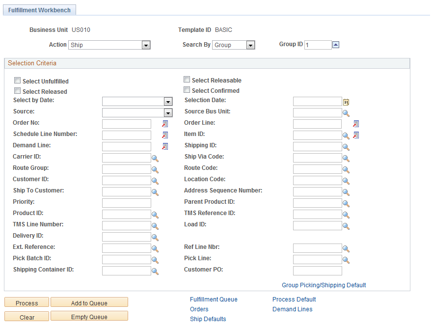

An authorized user can navigate to the Fulfillment Workbench page (Inventory, Fulfill Stock Orders, Fulfillment Workbench) and enter the following:
In the Action field, select the option Ship.
Enter the search criteria in the Selection Criteria group box to identify the large order. For this order you select the check boxes for the fulfillment states of the demand lines (Select Unfulfilled, Select Releasable, Select Released, Select Confirmed). You enter specific information in the Source, Source Bus Unit, and Order No fields in order to pick up just this order.
Click the Process button to write the transaction request to the staging tables. The transaction request can now be processed by the fulfillment engine using the Fulfillment Requests process. If you have selected automatic schedule processing on the Processing Defaults page of this workbench (use the Process Default link) or the Setup Fulfillment - Fulfillment Engine page, then the Fulfillment Requests process is launched when you click this button.
This example illustrates the fields and controls on the Fulfillment Workbench page . You can find definitions for the fields and controls later on this page.

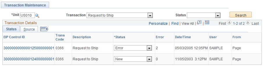

Use the Transaction Maintenance page (SCM Integrations, Transaction Error Handling, Maintain Transactions, Transaction Maintenance) or the Message Log to monitor the status of your transaction.
This example illustrates the fields and controls on the Transaction Maintenance page. You can find definitions for the fields and controls later on this page.

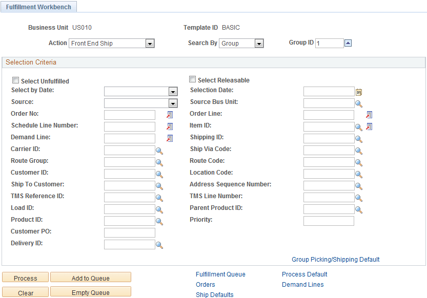

Once the new supplier shipment is received and putaway into the inventory business unit, you can use the Fulfillment Workbench to bring the 2 backordered lines to the Shipped state. First, an authorized user navigates to the Fulfillment Workbench page (Inventory, Fulfill Stock Orders, Fulfillment Workbench) and enters the following:
In the Action field, select the option Front End Ship.
Enter the search criteria in the Selection Criteria group box. For this order, select the Select Unfulfilled check box, and enter the correct values in the Source, Source Bus Unit, and Order No fields. Note that the Front End Ship launched by the Fulfillment Workbench can pick up Unfulfilled demand lines whereas the Front-End Shipping Requests process page can only pick up Releasable demand lines. This is possible because of the settings for the workbench are different from the process page.

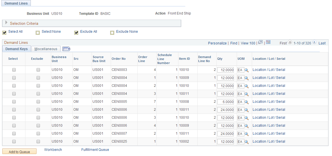

Select the Demand Lines link to access the Demand Lines page of the workbench.
This example illustrates the fields and controls on the Fulfillment Workbench page. You can find definitions for the fields and controls later on this page.

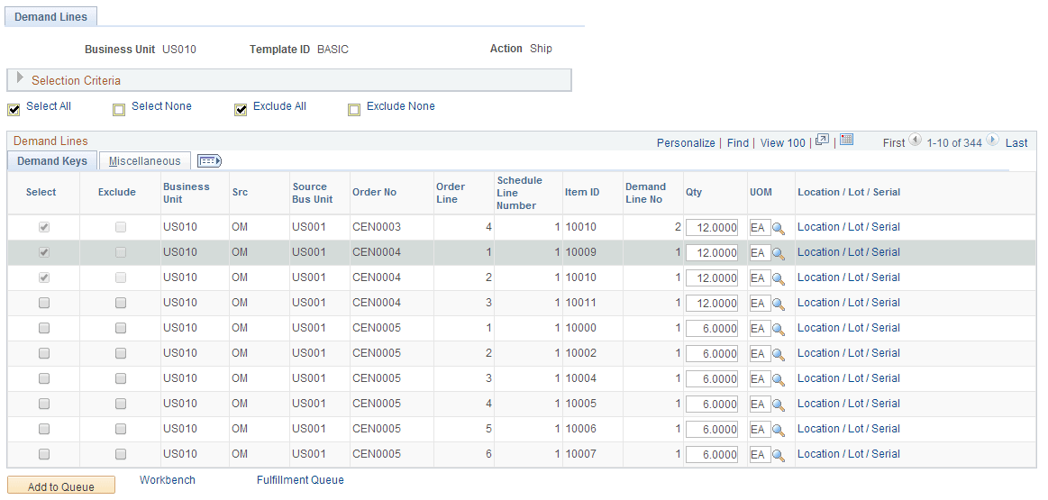

On the Demand Lines page of the Fulfillment Workbench, view all the lines of the order that meet our search criteria. On this page:
Select the demand lines using the Select check box on each demand line row.
Click the Add to Queue button.
Click the Fulfillment Queue link to access the Fulfillment Queue page of the workbench.
This example illustrates the fields and controls on the Demand Lines page of the Fulfillment Workbench. You can find definitions for the fields and controls later on this page.

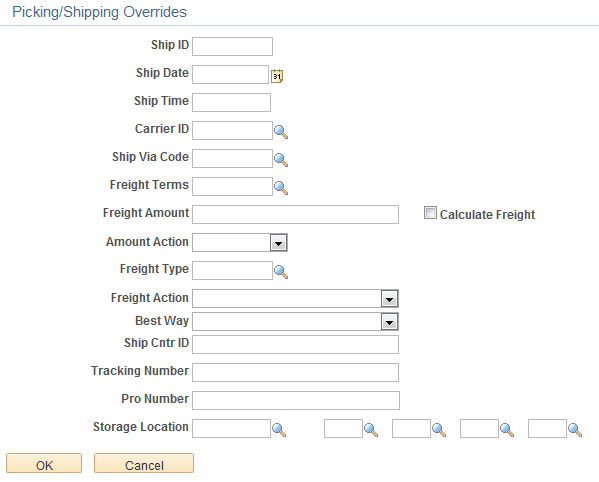

On this Picking/Shipping Overrides page, enter the Ship ID that was used for the other 8 demand lines of this order. Using this page, the Shipping ID override is applied to the entire transaction request. Click the OK button to return to the Fulfillment Queue page.
This example illustrates the fields and controls on the Picking/Shipping Overrides page. You can find definitions for the fields and controls later on this page.

First, create the group. An authorized user can navigate to the Fulfillment Workbench page (Inventory, Fulfill Stock Orders, Fulfillment Workbench) and enter the following:
In the Search By field, select the option Group.
Enter the search criteria in the Selection Criteria group box to identify the group. For this group, enter load ID 0000000001 that contains 4 demand lines. All the demand lines are in the Released state, so you can select the Select Released check box.

Exclude one demand line in this Load ID from the shipment. Once the group is created, select the Demand Lines link to access the Demand Lines page of the workbench. To exclude line 3 of the MSR0000011:
Select the Exclude check box on the demand line row. This action also selects the Select check box.
Click the Add to Queue button to add the exception to the fulfillment queue.
Click the Fulfillment Queue link to access the Fulfillment Queue page.
