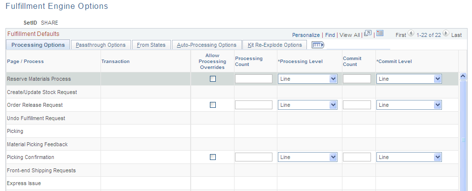

Use the Fulfillment Engine Options page (INV_FUL_DFLT) to define the fulfillment engine processing options for the SetID level.
This is linked to one or more PeopleSoft Inventory business units on the TableSet Control - Record Group page using the record group, IN_17, Fulfillment Engine Options.
Navigation:
This example illustrates the fields and controls on the Fulfillment Engine Options page (page 1 of 2). You can find definitions for the fields and controls later on this page.
This example illustrates the fields and controls on the Fulfillment Engine Options page (page 2 of 2). You can find definitions for the fields and controls later on this page.

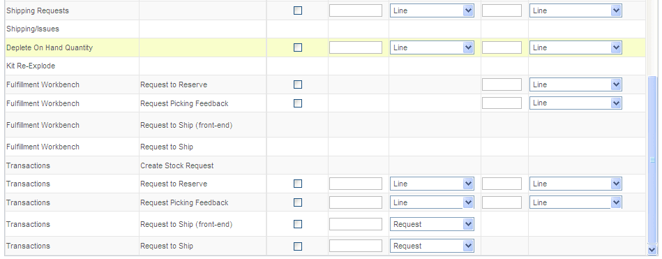

Processing Options
The columns on this page are defined at the beginning of this section.
This page defines default values to be used when the fulfillment engine processes fulfillment transaction requests.
Field or Control |
Description |
Page/Process and Transaction |
Displays the type of interface that uses the processing options:

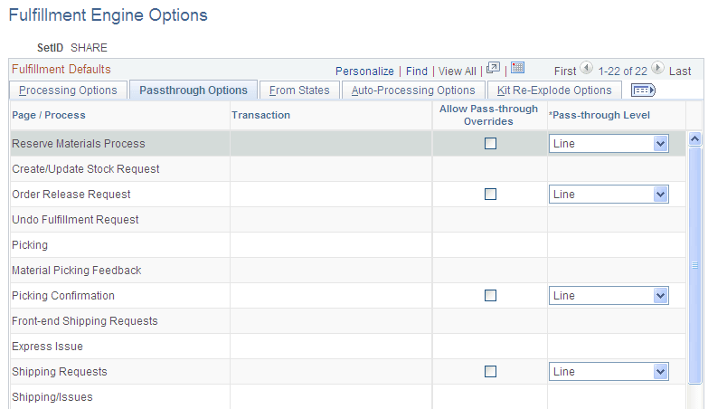

Passthrough Options
This example illustrates the fields and controls on the The Passthrough Options tab of the Fulfillment Engine Options page (page 1 of 2). You can find definitions for the fields and controls later on this page.
This example illustrates the fields and controls on the The Passthrough Options tab of the Fulfillment Engine Options page (page 2 of 2). You can find definitions for the fields and controls later on this page.

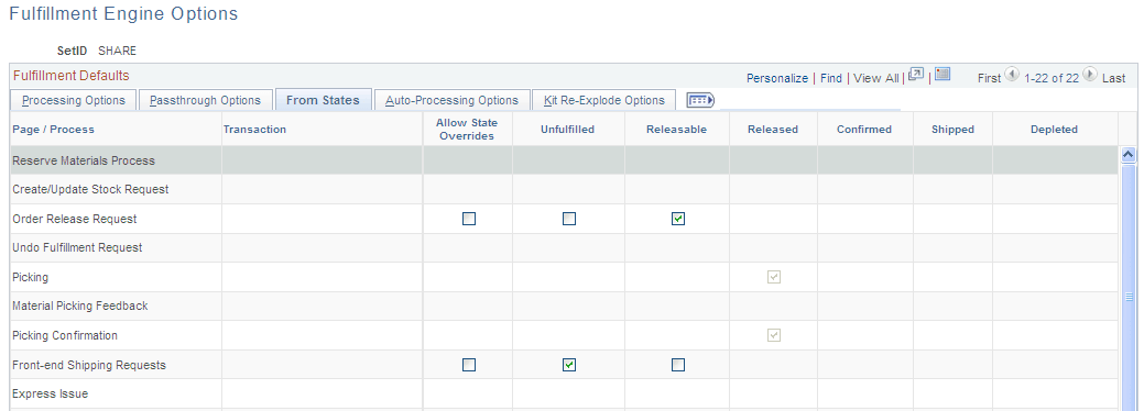

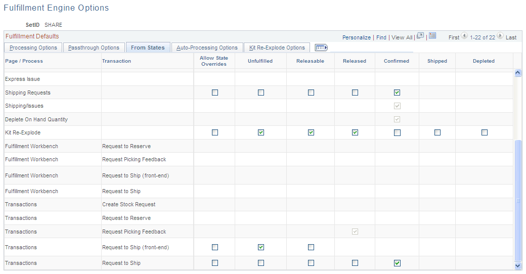

From States
Select the From States tab.
This example illustrates the fields and controls on the The From States tab of the Fulfillment Engine Options page (page 1 of 2). You can find definitions for the fields and controls later on this page.
This example illustrates the fields and controls on the The From States tab of the Fulfillment Engine Options page (page 2 of 2). You can find definitions for the fields and controls later on this page.
The From States page identifies the fulfillment status of the orders that users can select for processing by the fulfillment engine. For example, if the From States of Unfulfilled is selected, then users can select unfulfilled orders for processing.
Field or Control |
Description |
Allow State Overrides |
Select to enable the user to select a different From State in the fulfillment transaction request. |
Unfulfilled, Releasable, Released, Confirmed, Shipped, and Depleted |
Select the from state (or starting fulfillment status) of the orders to be moved to another status by the fulfillment engine. |
Note: The From States for the Fulfillment Workbench page are defined in the template ID for the workbench, not on this page.

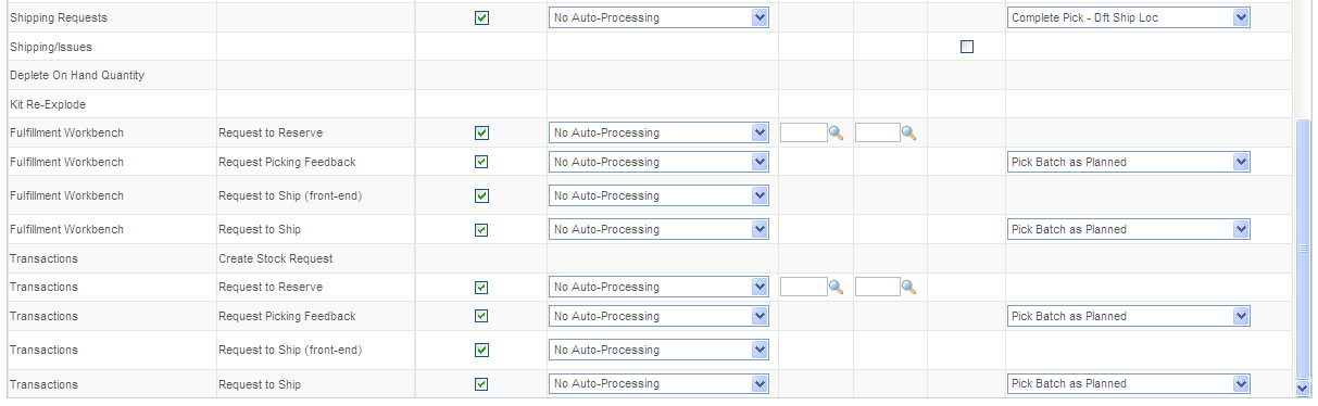

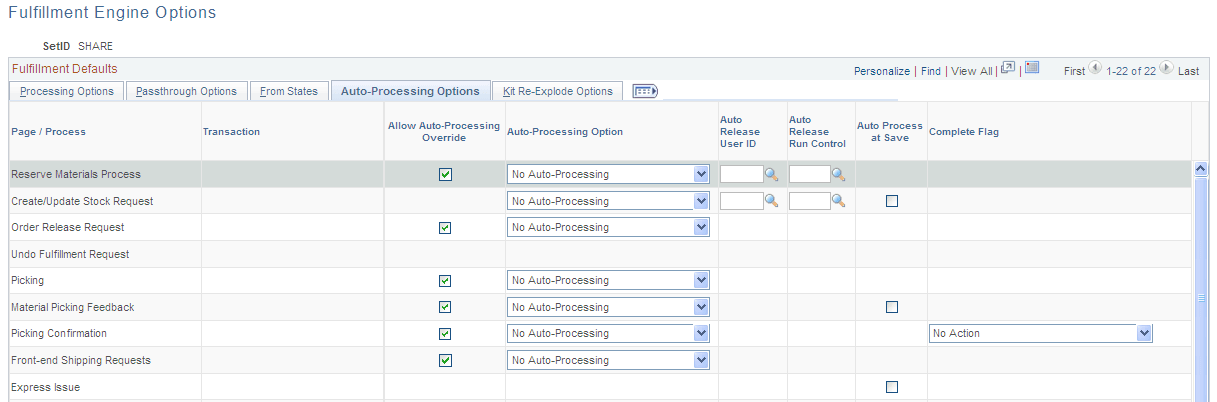

Auto Processing Options
This example illustrates the fields and controls on the The Auto-Processing Options tab of the Fulfillment Engine Options page (page 1 of 2). You can find definitions for the fields and controls later on this page.
This example illustrates the fields and controls on the The Auto-Processing Options tab of the Fulfillment Engine Options page (page 2 of 2). You can find definitions for the fields and controls later on this page.

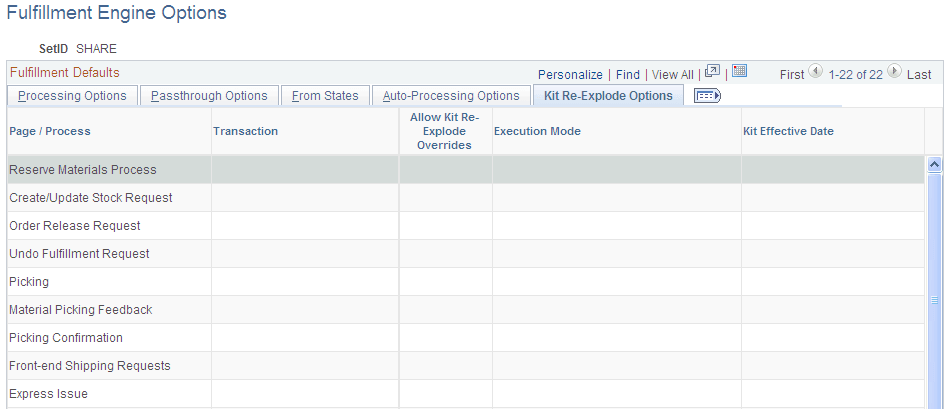

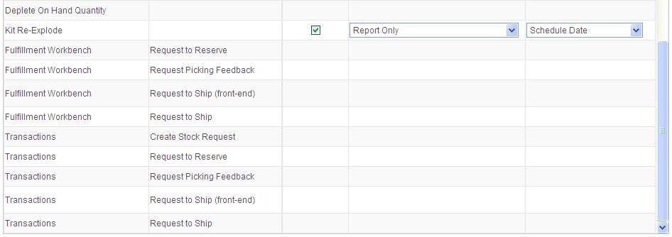

Kit Re-Explode Options
Select the Kit Re-Explode Options tab.
This example illustrates the fields and controls on the The Kit Re-Explode Options tab of the Fulfillment Engine Options page (page 1 of 2). You can find definitions for the fields and controls later on this page.
This example illustrates the fields and controls on the The Kit Re-Explode Options tab of the Fulfillment Engine Options page (page 2 of 2). You can find definitions for the fields and controls later on this page.
Field or Control |
Description |
Allow Kit Re-Explode Overrides |
Select to enable the user to override the default settings for the Execution Mode and the Kit Effective Date on the Kit Re-Explode process page. |
Execution Mode |
Choose the action to be performed by the Kit Re-Explode process. The option are:
Kit Effective Date |
Select the date of the component kit demand lines to be compared to the date range (effective date and obsolete date) on the Product Kit Summary page. The demand line dates are:
