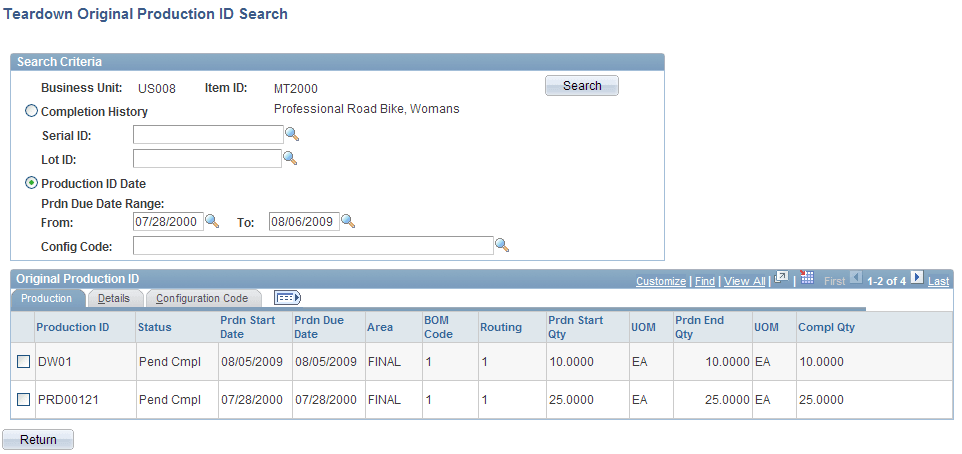

SF_TRDN_PID_SEC |
Locate the original production ID used to create the teardown item. This page is used for teardown orders only. |

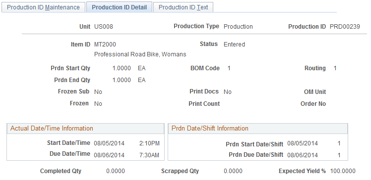

SF_PRDNID_STATIC |
View production ID and scheduling data. |

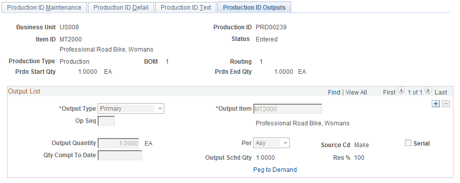

SF_PRDN_OUTPUT |
Maintain and display production output information. |

Prdn Start Date (production start date) |
Date production is or was to have started. |
Prdn Due Date (production due date) |
Date production is or was due to be completed. |
Prdn Due Shift (production due shift) |
Shift that the production is or was due to be completed. |

Output Qty (output quantity) |
Output production quantities based on per assembly or per order setting. |
Per |
Quantity qualifier. Options are Asy (assembly) or Ord (order). |
Res % (resource allocation percentage) |
Percentage that determines how much of the BOM batch quantity the primary and co-product represents. It is used during completions to determine what percentage of the components should be consumed for the primary and co-product. The total resource allocation percentage should always equal 100 percent. |

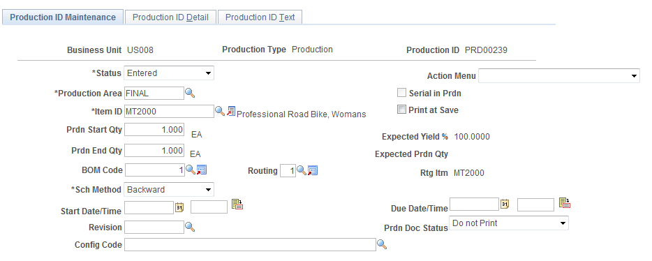

Use the Production ID Maintenance page (SF_PRDNID_MAINT) to create and maintain a single production ID for production, rework, or teardown orders.
Navigation:
Select a Production Type.
This example illustrates the fields and controls on the Production ID Maintenance page. You can find definitions for the fields and controls later on this page.

You can add a production ID with a production type of Production in either the Entered, Firmed, or Released status. You can add a rework or teardown production ID with a Firmed or Released status only. |
Note: Pend Cmpl (pending complete), Completed, Clsd/Labor (closed for labor), and Clsd/Acctg (closed for accounting) are used when tracking and closing production, but they are not used when creating or maintaining a production ID.

Production Area |
Select to indicate where this production will take place. Once you select a production area, you can view the items produced in that production area by selecting an item ID. You cannot add a production ID for an item that has not previously been defined in the production area selected. Additionally, you must have selected to maintain production IDs for the production area and item combination. The production area and item combination must have an Active status to add a new production ID. |
Item ID |
Select one of the items produced in the production area. You can change the item for any production ID in the Entered or Firmed status. If the production ID has a status of Released, you can change the item for any production as long as subcontracted purchase orders have not been generated against the production ID. If you change the item ID:
Note: If you need to change the item ID for In Process production, you can split the production ID into a new production ID—moving the remaining quantity in process—and simultaneously specify a new item. When adding a production ID for an item with item status of Hold or Discontinue, you'll receive a warning message. However, there is no warning for rework or teardown production type. If the production ID for an item has a status of Hold, the system gives you the option to cancel that order at save time. |

Start Date/Time or Due Date/Time |
If you selected a routing, enter only one of these dates. The system automatically calculates the other date once you define whether the production for this item is based on forward or backward scheduling. Keep these points in mind when entering a start date and time or a due date and time:
Note: If capacity and material availability are concerns, estimate the start and due dates when you create or maintain the production ID using PeopleSoft Manufacturing, and then schedule the production ID's start and due dates using PeopleSoft Supply Planning. |
Revision |
If a revision was specified for the area and item, it is displayed here. Otherwise, if the item is revision-controlled, the BOM revision in effect as of the due date for the order is used. Changing the revision is valid only if the item is revision controlled. Select an alternate revision if alternates have been specified. If you are changing the revision and the production ID is in Firmed or Released status, the system prompts you to replace the existing component list.
Prdn Doc Status (production document status) |
Indicates whether production documents have been printed. Values are:
Print at Save |
Select to print production documents for the production ID at save time. |

Use the Teardown Original Production ID Search page (SF_TRDN_PID_SEC) to locate the original production ID used to create the teardown item.
Navigation:
Click the Search button next to the Original PID field to access this page.
This example illustrates the fields and controls on the Teardown Original Production ID Search page: Production tab. You can find definitions for the fields and controls later on this page.
Note: If the production type is Teardown, the output list is based on the components used on a previous production ID or on the components designed as teardown outputs on the item's BOM.
Select Completion History, and if the serial ID and lot ID exist for the original order, select values.
You can also select a production due date range or configuration code from the available options. After you make the selections, click Search for a list of production IDs. If multiple production IDs were used to create the item, the system generates a list of production IDs, but it only selects production IDs with a status of In Process or later status with a production type of Production.
Production Tab
Select the check box next to the original production ID that you're tearing down.

Use the Production ID Detail page (SF_PRDNID_STATIC) to view production ID and scheduling data.
Navigation:
This example illustrates the fields and controls on the Production ID Detail page. You can find definitions for the fields and controls later on this page.
Field or Control |
Description |
Frozen Production |
Indicates whether a decision was made to hold or firm up the due date for this production ID by PeopleSoft Supply Planning. Change production information using the Production ID Maintenance page. If you change production information and the status is Yes, the system displays a warning message indicating that the production ID has been frozen by PeopleSoft Supply Planning and the change results in the production ID being rescheduled. You can continue or cancel the changes. If you change this information, the production ID is no longer frozen and the status changes to No. |
Frozen Substitutes |
Indicates whether the system has frozen substitutes in the PeopleSoft Supply Planning system. This means that when you sent this production ID to PeopleSoft Supply Planning, the Planning engine did not include substitute components. |
OM Business Unit (Order Management business unit), Sales Order No and Configuration Code |
These fields display sales order information if the production ID results from a sales order configured in PeopleSoft Order Management. |
Print Count |
Indicates the number of times that production documents have been printed for the production ID. |
Indicates whether production documents have been printed. |
Completed Qty (completed production start or production end quantity) |
Indicates whether assemblies have been completed to stock, routed to another WIP location, or issued directly to another production ID. |
Scrapped Qty (scrapped quantity) |
Indicates the number of assemblies that have been scrapped in process. |
Use the Production ID Outputs page (SF_PRDN_OUTPUT) to maintain and display production output information.
Navigation:
If you're adding a new production ID, the Production ID Outputs page is not available until after you save the page.
Select View Outputs from the Action Menu on the Production ID Maintenance page.
This example illustrates the fields and controls on the Production ID Outputs page. You can find definitions for the fields and controls later on this page.
Output List
Field or Control |
Description |
Output Type |
Values are:
Op Seq (operation sequence) |
Operation step in which the output is generated. For primary and co-products, this is always the last operation. By-products and teardown outputs can be generated at any intermediate operation. If the operation sequence is 0 or does not exist on the operation list, it is assumed the output is generated at the last operation. |
Output Sched Qty (output scheduled quantity) |
Output quantity based on the scheduled quantity but adjusted for scrap. The format for this display-only field may depend on the item's unit of measure and quantity precision combination defined in PeopleSoft Inventory. For example, suppose that item ID A0007 has a unit of measure of EA and a natural round, whole number combination. In that case, only whole numbers entered appear.
Release Type |
This field is used by PeopleSoft Supply Planning and indicates if the entire quantity of an end item at an operation should be completed at the end of the operation. Select None for no incremental release. Select Over Time to indicate that you want a specified quantity of end items to be on hand before completions occur. |
Release Offset |
This field is used by PeopleSoft Supply Planning and works with the Over Time option of release type. Enter the quantity of end items to be on hand before completions occur. |
Peg to Demand |
Click this link to access the Pegging Workbench page to peg the production ID to a sales order. |
Show Pegged Demand |
Click this link to access the Pegging Inquiry page to view any pegged orders. |
Adding Unplanned By-Products
Field or Control |
Description |
Click the Add button to add an additional (unplanned) by-product. You can add or change Recycle, Teardown, or Waste by-products on the production ID; however, you cannot add or change primary items or co-products. Note: You can only add teardown outputs to a Teardown type production ID. Similarly, you cannot add recycle or waste outputs to a Teardown production ID. However, you can change the output quantity, operation sequence, and Per field for any by-products. |
Whether you can enter a whole number or a decimal depends on unit of measure and quantity precision combination that was defined for the item in PeopleSoft Inventory. |
Res % (resource percentage) |
Indicates the resource percentage for the primary and co-products. |
Important! Only by-products such as recycle or waste products can be added or changed. You cannot change or add primary items or co-products.
If you are maintaining a rework production ID, the output page lists only the reworked item as the end item. You cannot define co-products or by-products with rework.
