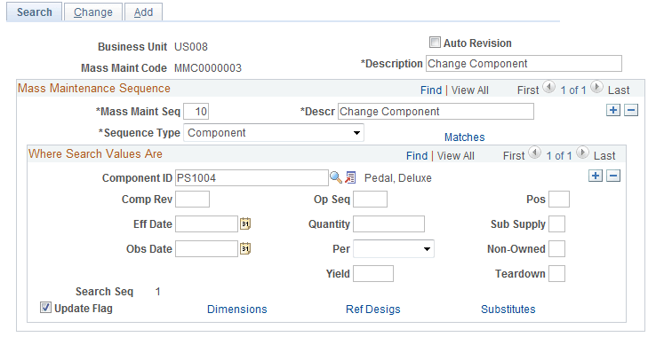

Use the Search page (EN_BOM_MMC_SRCH) to identify the specific existing outputs or components to change.
Specifying components also enables you to identify the BOMs that are impacted.
Navigation:
This example illustrates the fields and controls on the BOM Mass Maintenance Code - Search page. You can find definitions for the fields and controls later on this page.
Before you associate any changes or additions to an MMC, you can use the Search page to identify which specific outputs, components, or component revisions to change on the BOM.
When adding components, use the Search page to further identify the BOMs to which the new component should be added. For example, you may want to add component ID LT5001 only on BOMs that already have a component ID called LT5000 and a 12/31/97 obsolete date or perhaps where you already have component ID LT5000 and LT5001 defined. Similarly, you can use the Search page to further identify to which BOMs the new output should be added.
Note: On these pages, the fields that appear vary, depending on the choice of values in the required Sequence Type field. The page examples that you see are based on the value Component having been selected in the Sequence Type field. However, if you select Output, the system doesn't display the component ID, component revision, quantity, yield, position, if the item is supplied by a subcontractor, if the item is non-owned, or if it is a teardown item. It also does not display the dimensions, reference designators, and substitutes. Instead, it displays the output item, output type, output quantity, resource allocation percentage, and cost allocation percentage fields.
Field or Control |
Description |
Auto Revision |
Select this check box to apply schemes for this mass maintenance code that automatically update revisions when a change event occurs. You actually generate the automatic revisions when you run the mass maintenance functionality. |
Mass Maint Seq (mass maintenance sequence) and Descr (description) |
Enter a mass maintenance sequence number and its description. The mass maintenance sequence number enables you to set up more than one set of changes for a single mass maintenance code. The sequence number determines the order in which the changes are applied. Note: The maximum number of sequence numbers that you can enter for a specific mass maintenance code is 20. |
Sequence Type |
Select Component or Output. If you select Component, enter the component search values. This optionally includes standard BOM fields such as Component ID, Comp Rev (component revision), Op Seq(operation sequence), Eff Date, (effectivity date), Obs Date (obsolete date), and quantity Per. The system searches for values that meet, at the same time, all of the criteria that you enter. Note: The effective date and obsolete date that you enter indicates the precise date on which the component becomes effective or obsolete on the BOM. If you select Output as the sequence type, then you can, optionally, select the output item and output type. You can also enter an output quantity, resource percentage, and cost allocation percentage. If you don't want to change a specific component, then leave the Component ID field blank, and select criteria based on the other fields. If you leave any field on the Component Search page blank, the system searches for BOM components without considering the blank search field. For example, if you leave Component ID blank and just enter a yield of 50, then all components with a yield of 50 are selected. To search for multiple components or outputs within a sequence, use the Where Search Values Are group box to enter "and" searches for more than one component or output on a BOM. |
Update Flag |
While searching for BOMs that contain multiple components or outputs, you may only want to actually make changes to a subset of all components or outputs. Select this check box to indicate which components or outputs you want updated by the Mass Maintenance process. |

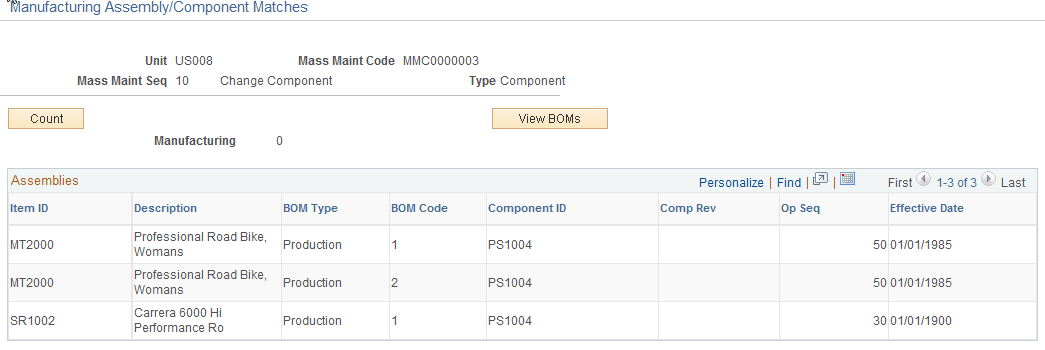

Use the Manufacturing Assembly/Component Matches page (EN_BOM_MMC_VW_SP) to this display-only page allows you to view the number of assemblies that match the search criteria that you have entered and view matching BOMs.
Navigation:
Click the Matches link.
This example illustrates the fields and controls on the Manufacturing Assembly/Component Matches page. You can find definitions for the fields and controls later on this page.
Field or Control |
Description |
Count |
Click this button to view the number of assemblies that match the search criteria that you entered. The page displays MBOM totals. These values are the number of MBOMs that will be affected, assuming that you plan to perform mass maintenance processing for all BOMs in the business unit that meet the search criteria. The actual MBOMs to be changed can be determined by assembly list, by range, when the mass maintenance code is applied later. Note: If you anticipate that a large number of BOMs are going to be affected by the search criteria, click the Count button before attempting to view the BOMs, to avoid viewing too much data online. |
View BOMs |
Click this button to view manufacturing assembly matches to the criteria that you entered. This display of assembly matches lists the assemblies that can be affected by this mass maintenance sequence. When the mass maintenance code is applied later, this list of assemblies can be further restricted, by supplying a range of assemblies, a specific list of assemblies, or an ECO that contains assemblies with BOM changes. If you selected Output as the sequence type on the Search page, the assembly matches display the output item and output type instead of the component ID. |

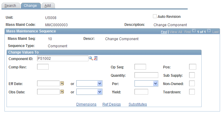

Use the Change page (EN_BOM_MMC_NEW) to specify new component values, once you have selected the set of components that you want to change on the Search page.
Navigation:
This example illustrates the fields and controls on the BOM Mass Maintenance Code - Change page. You can find definitions for the fields and controls later on this page.
Use this page to change values or obsolete the components specified on the Search page.
Field or Control |
Description |
Component ID |
Enter a new value if you intend to change the Component ID field. Note: This would typically be done for correcting BOMs. If you intend to keep the history of a component change, you should leave this field blank. |
Output Item and Output Type |
If you selected Output, you can enter the required output change to data on this page. The effectivity dates operate in the same manner as they do for a component sequence type. |

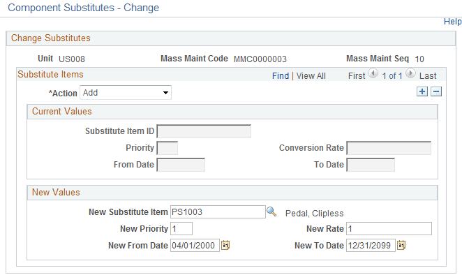

Use the Change - Substitutes page (EN_BOM_MMC_SUB2_SP) to mass change a substitute everywhere it's used.
Navigation:
Click the Substitutes link.
This example illustrates the fields and controls on the Component Substitutes - Change page. You can find definitions for the fields and controls later on this page.
Field or Control |
Description |
Action |
Select one of these values:
Adding, changing, and deleting component substitutes works in a similar fashion as the reference designators, except that you have more information to maintain. If adding a new substitute, specify all the required new values. If deleting a substitute, specify as many of the current values as necessary to perform the delete. If you are changing substitute information, enter the current and new values. For example, to delete all occurrences of LT5001 as a substitute, then enter only LT5001 as the substitute item. To delete only the substitute LT5001, if it has priority 1, then enter LT5001 as the substitute item and 1 as the priority. |
Current Values
Field or Control |
Description |
Substitute Item ID |
This is the current default value that comes from the business unit. |
Priority, Conversion Rate, From Date, and To Date |
If deleting a substitute, specify as many of the current values to perform the deletion. For example, to delete all occurrences of LT5001 as a substitute, then only enter LT5001 as the substitute item ID. If you only want to delete the substitute LT5001 if it has priority 1, then enter LT5001 as the substitute item ID and 1 as the priority. If changing substitute information, enter the current values. |
New Values
Field or Control |
Description |
New Substitute Item |
Enter the value for the new substitute component. If you're adding a new substitute, you must specify all of the required new values. |
New Priority, New From Date, New To Date, New (conversion), and Rate |
If you want to change the parameters of the new substitute item, enter values where applicable. Otherwise, any values that you don't specify here for the new substitute item priority, effective dates, and conversion rate remain unchanged on the BOM. You can also change the parameters for the original item here. Enter only the fields that you want to change. |

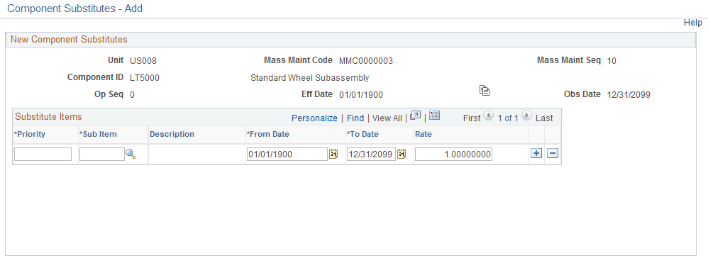

Use the Add - Substitutes page (EN_BOM_MMC_SUB3_SP) to add a substitute everywhere it's required.
Navigation:
This example illustrates the fields and controls on the Component Substitutes - Add page. You can find definitions for the fields and controls later on this page.
Field or Control |
Description |
Click the Copy Substitute Push button to display all valid substitute items for the business unit. |
To add all valid substitute items for the business unit, click OK.
If you don't want to add all valid substitute items for the business unit, enter each individual substitute item that you want to add. In addition, enter the priority, from date, to date, and conversion rate for each substitute.
Note: Substitute items must be unique for the item. You can't enter the same item twice as a substitute with different dates. For example, substitute A with effective dates from 01/01/99 to 02/01/99 and substitute A with effective dates from 02/01/00 to 08/30/00 couldn't be substitutes for the same item. In this case, define a different substitute for the second set of effective dates.
