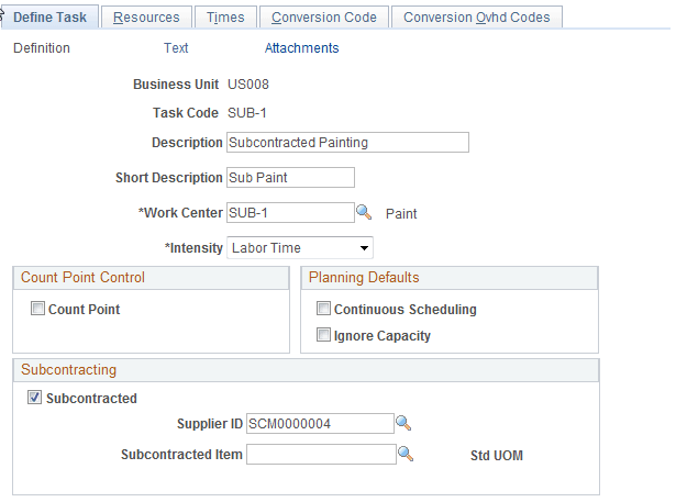

Before defining routings, you can define a master dictionary of tasks or jobs that can be performed at work centers.

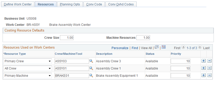

Use the Define Work Center Resources page (EN_WC_RESOURCE) to define work center resources.
Navigation:
This example illustrates the fields and controls on the Define Work Center Resources page. You can find definitions for the fields and controls later on this page.
Costing Resource Defaults
Field or Control |
Description |
Crew Size |
(Optional) Enter the number of people at the work center. This value appears by default from the primary crew specified in the work center definition. |
Machine Resources |
(Optional) Enter the number of machines at the work center. If multiple machines exist in the work center and you want to factor their costs into an item's cost, enter that factor here. |
Although these are optional fields, the system uses the crew size and machine resources information when it calculates standard labor and machine costs for items in the standard cost calculations.
In some cases, the system also uses crew size and machine resources when it calculates the per unit cost of an item, as well as the earned labor and machine amounts in PeopleSoft Manufacturing. The system only uses crew size and machine resources in labor and machine cost calculations if the value of the labor and machine rate is defined as a rate per hour, rather than a rate per unit. If the value is per unit, it's expected to be factored in and the system doesn't include it in the calculation. However, if the rate is per hour, the system uses the crew size in the calculation.
The system only uses crew size and machine resources for runtime labor and machine calculations. Setup times, for example, are typically of fixed duration and amount. Therefore, it is assumed that you have already factored in crew size and machine resources when you define them.
To better understand an item's cost calculation and the earned labor cost calculations, consider these equations. For setup time operations, the item's cost calculation equation is:
When calculating earned setup costs in PeopleSoft Manufacturing, the system calculates the setup cost for the production quantity. It does not divide by the average order quantity.
For runtime operation, the cost calculation equation differs, depending on whether the labor or machine rate is a rate per unit or rate per hour. If it's a rate per unit, then the applicable per unit item cost equation is the labor or machine rate per unit. To calculate the earned labor or machine run cost, the system uses this equation:
If the labor or machine rate is a rate per hour, then the applicable per unit item cost equation is as follows:
Field or Control |
Description |
Labor |
(Crew size) × (Labor
rate for run) × (Run time [in hours]) = Labor run cost
Machine |
(Machine resources)
× (Machine rate for run) × (Run time [in hours]) = Machine run cost
To calculate the earned labor or machine run costs in production, the system multiplies the per unit cost by the quantity completed at the operation.
The system copies the resources to the task when you enter the work center for the task. It copies the resources to the routing when you specify the task for an operation, or, if you are not using tasks, when you specify the work center for the routing operation. If you choose not to define resources, you can enter the crew size and number of machines used in the work center here.
Resources Used on Work Centers
Field or Control |
Description |
Resource Type and Crew/ Machine/Tool |
Select a type and resource to associate with the work center. You can only associate one Primary Tool, Primary Crew, and Primary Machine with the work center, but you can designate unlimited Alternate Crews, Machines, or Tools. A primary resource is the preferred resource to be used in production. You can assign tools, crews, and machines to multiple work centers. |
Status |
Indicates the availability of a resource for this work center. |
Priority |
Enter a whole-number ranking to indicate which resource has preference over others when considering multiple resources. The lower the priority assigned to a resource, the more likely it is that the resource will be chosen. You can manually specify a priority for the task resource or work center resource. The priority appears by default onto the routing. The primary resource for tool, crew, and machine automatically changes to a priority of 10. Other resources of like type automatically change to a priority of 20. The priority setting enables you to designate the order in which PeopleSoft Supply Planning uses resources. |
If you use PeopleSoft Supply Planning, you must enter at least one resource in the resource list (crew or machine) at each work center. PeopleSoft Supply Planning only uses the priority that you define on the routing.
Note: To specify a resource on a task or routing, first associate it with the work center in which the task or operation is performed.
Changing the resources for a work center does not change the resources for any routing operation that is using the work center. Furthermore, you cannot delete a work center resource if it is being used on a task or routing.
The system only copies primary resources when it copies routings to production.

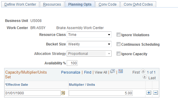

Use the Define Work Center - Planning Opts (planning options) page (EN_AGGREG_WC) to define the planning options associated with the work center.
Navigation:
This example illustrates the fields and controls on the Define Work Center - Planning Opts page. You can find definitions for the fields and controls later on this page.
Field or Control |
Description |
Resource Class |
Because work centers are modeled as aggregate resources in PeopleSoft Supply Planning, define each work center as either an aggregate resource by time or an aggregate resource by unit. Values are:
Bucket Size |
Enter the summation period, the period over which you are aggregating. Values are Daily, Weekly, and Monthly. The default is Weekly. |
Allocation Strategy |
Enter a value to specify how you plan to spread the time and unit over the bucket size. Values are Start, Finish, and Proportional. This determines whether if the task is stretched across two or more buckets—in its entirety—is placed in the first bucket, the last bucket, or spread proportionally across all buckets. The default is Proportional. |
Availability % |
Define a percentage of the total capacity time that the resource is available for use. You might take into consideration scheduled maintenance or include a buffer for unexpected repairs when you define the percentage. You can change the resource availability percentage for all the aggregate resources. The default is 100. |
Ignore Violations |
Select to prevent the solvers from analyzing and resolving capacity issues impacting the work center. When this check box is selected, capacity issues—although not recognized by the solvers—will appear in the PeopleSoft Supply Planning Violations workbench if they are before the capacity fence defined for the planning instance. By selecting the Ignore Violations check box on noncritical work centers, you enable the solvers to ignore these work centers and focus on critical work centers for capacity repair. Select this check box to generate what-if scenarios. |
Continuous Scheduling |
Select to complete the corresponding operation in a single run of continuous valid calendar time, with no gaps allowed between shifts. This field is used as a routing operation default. |
Ignore Capacity |
Select to prevent solvers from considering the corresponding operation as required capacity for the work center. This field is used as a routing operation default. |
Capacity Multiplier/Units Set
This is used by the system to determine the available capacity on a work center. Because these sets are effective-dated, you can use the Capacity Multiplier/Units grid to vary the work center's available capacity over time.
If you define the work center as an aggregate resource by time, the system uses the capacity multiplier to represent the number of identical work centers that exist for scheduling purposes.
For example, suppose that you define a work center as an aggregate resource by time with weekly buckets, and it has a capacity multiplier of 2, with an effective date of March 5, 2005. Then, beginning on March 5, 2005, PeopleSoft Supply Planning treats this aggregate resource as two identical work centers that it can use simultaneously for jobs. If the work center has 40 hours of available calendar time in a weekly bucket, then the available capacity for the bucket, based on a capacity multiplier of 2, would be 80 hours total. PeopleSoft Supply Planning uses this capacity multiplier to determine the work center's available capacity until the next capacity multiplier becomes effective.
If you define the work center as an aggregate resource by unit, the system uses the capacity units to represent the number of units that can be produced on that work center in an entire bucket (assuming a calendar of 24 hours per day, seven days per week, during the entire bucket).
For example, suppose that you define a work center as an aggregate resource by unit with weekly buckets. If this resource has capacity units of 100 with an effective date of April 10, 2005, then, beginning on April 10, 2005, PeopleSoft Supply Planning treats this work center as being capable of producing 100 units per week (based on a calendar of 24 hours per day, seven days per week). The actual available capacity for this work center is then calculated by factoring in the actual production calendar during each weekly bucket. If the work center has 40 hours of available calendar time in a weekly bucket, then the available capacity for the bucket, based on a capacity unit of 100, would be (100 units × 40 hours per week) ÷ (24 hours per day × 7 days per week) = 24 units. PeopleSoft Supply Planning uses these capacity units to determine the work center's available capacity until the next capacity multiplier becomes effective.

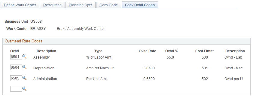

Use the Define Work Center - Conv Ovhd Codes (conversion overhead codes) page (EN_WC_CONOHCODE) to associate work center conversion overhead codes.
Navigation:
This example illustrates the fields and controls on the Define Work Center - Conv Ovhd Codes page. You can find definitions for the fields and controls later on this page.
Enter the overhead code that you want to associate with the work center. The system displays the overhead rates from the Conversion Ovhd Codes page. The rates appear from the frozen conversion overhead rates and costs that were updated during the last cost update and revaluation. When production costs are updated using a selected cost type and version, the system copies the conversion rates and conversion overhead rates—which are used to calculate the item costs—into a frozen conversion rate record. The system uses those frozen rates to calculate earned labor, machine, and overhead costs when end items are completed at operations or to stock. You can associate up to four codes with a work center.
Note: The system copies the overhead rates and costs into the item's routing when you assign the work center to a routing operation. The system uses these codes to calculate the cost of the operation that uses the work center.
