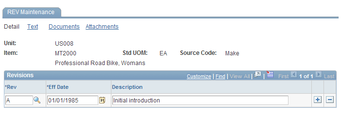

Use the REV Maintenance - Detail page (EN_REVISION) to define revision codes and determine the date that those revisions become effective.
Navigation:
This example illustrates the fields and controls on the REV Maintenance - Detail page. You can find definitions for the fields and controls later on this page.
Field or Control |
Description |
Rev (revision) and Eff Date (effective date) |
Enter values for each revision code that you're defining. Although you can enter as many user-defined revisions as you want, there can be no overlapping dates and no gaps between revision dates for a specific item. |
Note: You cannot use the same revision multiple times for an item. Also, you cannot delete a revision if it's tied to an item or one of its BOM components or if it appears on a production order or an ECO. If a component is used on a BOM or an ECO and you attempt to change revision dates for the component, the system displays a warning.
In the following example, you can see how existing revisions and BOM effectivity dates are affected when you manually insert a revision (or when the system automatically inserts a new revision). The obsolete date of the preceding revision must be the day before the effective date of the newly inserted revision. Also, if an obsolete date for a revision changes because a new revision is inserted, the obsolete date is also changed on any BOM where it appears.
