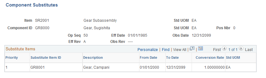

Use the Component Substitutes page (EN_BOM_INQ_SUB) to view BOM component substitute items.
Navigation:
Click the Substitutes link under the Attributes tab.
Click the Substitutes link.
This example illustrates the fields and controls on the Component Substitutes inquiry page. You can find definitions for the fields and controls later on this page.
Substitutes and related data such as Conversion Rate and effectivity dates appear in order of priority.

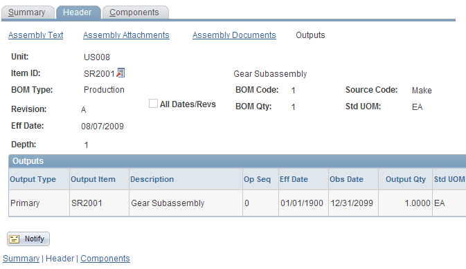

Use the Header - Outputs page (EN_BOM_INQ_OUTS) to display BOM assembly outputs.
Navigation:
This example illustrates the fields and controls on the Header - Outputs page. You can find definitions for the fields and controls later on this page.
The values in the header data (for the Unit, Item ID, BOM Type, BOM Code and Eff Date or Revision, Depth fields) are defaults values from the Summary page.
Note: Regardless of the depth that you entered, only outputs for the top-level item appear on this page. You can, however, use the Manufacturing BOMs inquiry - Summary: Summary: Attributes page to view lower level outputs. You do this by clicking the Outputs link. This link appears only if the component has multiple outputs on its BOM.
The system only explodes primary co-products for the BOM code that you specified. You cannot enter a co-product and see it exploded downward. Rather, you must enter the primary to which that co-product is associated to view the co-product details.

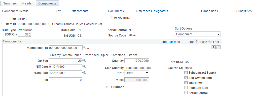

Use the Components - Component Details page (EN_BOM_INQUIRY_D) to display BOM component detail such as effectivity dates, quantities, yield, and unit of measure (UOM).
Navigation:
This example illustrates the fields and controls on the Components - Component Details page. You can find definitions for the fields and controls later on this page.
The values in the header data, for the item, BOM type, BOM code, revision, and effective date are default values from the Summary page.
Standard component data for the component revision, operation sequence, yield, subcontracted supply, teardown, and effectivity dates also appear.
