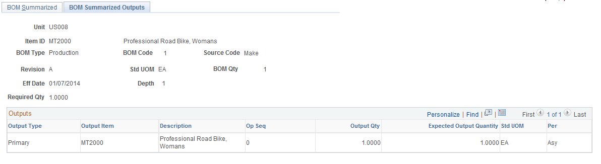

Use the BOM Summarized Outputs page (EN_BOM_SUMM_OUTS) to display BOM summarized outputs.
Navigation:
This example illustrates the fields and controls on the BOM Summarized Outputs inquiry page. You can find definitions for the fields and controls later on this page.
Note: The system only explodes primary co-products for the BOM Code specified. Only outputs at the top level are displayed, regardless of the Depth entered.
Field or Control |
Description |
Expected Output Qty |
Represents the anticipated output of each primary, co-product, recycle and waste product, based on the required quantity you enter. This is calculated as follows: ((Required Qty / BOM Qty) × Output Quantity). |
