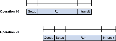

Example 1: Operations with no overlap; queue and setup are done sequentially.

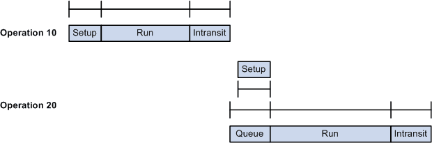

Example 2: Operations with no overlap; queue and setup are done concurrently; queue time is less than setup time.

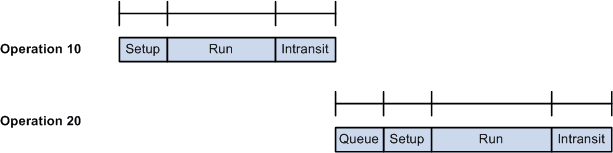

Example 3: Operations with no overlap, queue and setup are done concurrently; setup time is less than queue time.

This diagram shows an example of operations with no overlap and the queue and setup are done sequentially:
Operation |
Operation Start |
Run Start |
Operation Due |
10 |
Day 1, 8:00 a.m. |
Day 1, 9:00 a.m. |
Day 1, 2:00 p.m. |
20 |
Day 1, 5:00 p.m. |
Day 1, 8:00 p.m. |
Day 2, 6:00 a.m. |

This diagram shows an example of operations with no overlap and the queue and setup are done concurrently. The queue time is less than the setup time:
Operation |
Operation Start |
Run Start |
Operation Due |
10 |
Day 1, 8:00 a.m. |
Day 1, 9:00 a.m. |
Day 1, 2:00 p.m. |
20 |
Day 1, 4:00 p.m. |
Day 1, 7:00 p.m. |
Day 2, 5:00 a.m. |

This diagram shows an example of operations with no overlap, the queue and setup are done concurrently, and the setup time is less than the queue time:
Operation |
Operation Start |
Run Start |
Operation Due |
10 |
Day 1, 8:00 a.m. |
Day 1, 9:00 a.m. |
Day 1, 2:00 p.m. |
20 |
Day 1, 6:00 p.m. |
Day 1, 7:00 p.m. |
Day 2, 5:00 a.m. |

Notes |
1 |
Operation 10 start date and time. |
Production ID's start date and time. |
This calculation assumes that queue doesn't occur at the first operation. |
2 |
Operation 10 run start date and time. |
Operation start date and time + setup time. |
None. |
3a, or |
Operation 10 run time (time/unit). |
Operation start quantity × run rate (converted to hours) + fixed run (converted to hours). |
Use this calculation if the run rate is in terms of time per unit. |
3b |
Operation 10 run time (units and time). |
Operation start quantity / run rate (converted to hours) + fixed run (converted to hours). |
Use this calculation if the run rate is in terms of units per time unit. |
4 |
Operation 10 due date and time. |
Run start date and time + run time. |
None. |
This table lists the steps that you take to calculate start and due dates and times for the second operation (Operation 20):
Step |
To Calculate |
Use |
Notes |
1 |
Operation 20 start date and time. |
Prior operation's (Operation 10) due date and time + prior operation's in transit time + (queue − setup time of current operation). |
This calculation assumes that setup time is less than queue time. |
2 |
Operation 20 run start date and time. |
Current operation start date and time + setup time. |
None. |
3a or |
Operation 20 run time (time/unit). |
3b |
Operation 20 run time (units and time). |
Operation start quantity / run rate (converted to hours) + fixed run (converted to hours) |
4 |
Operation 20 due date and time. |
Current operation run start date and time + run time. |
If you have a schedule with more than two operations, repeat steps 1 through 4in this table until all subsequent operation due dates and times are calculated. |

Forward Scheduling Calculations
Production ID Start Date and Time = Day 1, 8:00 a.m.
This table lists the steps that you take to calculate the start and due date and times for the first operation (Operation 10):
Step |
To Calculate |
Use |
Notes |
1 |
Operation 10 start date and time |
Production ID's start date and time |
This calculation assumes that queue doesn't occur in the first operation. |
2 |
Operation 10 run start date and time |
Operation start date and time + setup time |
Setup is always included at the first operation. |
3a, or |
Operation 10 run time (time/unit) |
Operation start quantity x run rate (converted to hours) + fixed run (converted to hours) |
3b |
Operation 10 run time (units and time) |
4 |
Operation 10 due date and time |
Run start date and time + run time |
None. |
Step |
To Calculate |
Use |
Notes |
1 |
Operation 20 start date and time |
Prior operation's (Operation 10) due date and time + prior operation's intransit time + current operation's queue time - current operation's setup time |
This calculation assumes that setup can be completed any time after the first operation run has started. The start date and time represent the latest possible time that you should begin setup. |
2 |
Operation 20 run start date and time |
Current operation start date and time + setup time |
None. |
3a, or |
Operation 20 run time (time and unit) |
3b |
Operation 20 run time (units/time) |
Operation start quantity and run rate (converted to hours) + fixed run (converted to hours) |
4 |
Operation 20 due date and time |
Current operation run start date and time + run time |
If you have a schedule with more than two operations, repeat steps 1 through 4 in this table until all subsequent operation due dates and times are calculated. |
Backward Scheduling Calculations
Production ID Due Date and Time = Day 2, 3:00 a.m.
This table lists the steps that you take to calculate the start and due date and times for the last operation (Operation 20):
Step |
To Calculate |
Use |
Notes |
1 |
Production ID's due date and time - current operation's intransit time |
None. |
2a, or |
2b |
3 |
Current operation's due date and time - run time |
None. |
4 |
Current operation's run start date and time - setup time |
This table lists the steps that you take to calculate start and due dates and times for the prior operation (Operation 10):
Step |
To Calculate |
Use |
Notes |
1 |
Subsequent operation's (Operation 20) start date and time - subsequent operation's queue time - current operation's intransit time |
The run start date and time is used and setup is not included. The setup at Operation 20 can be completed at the same time the prior operation is being run. |
2a, or |
2b |
3 |
None. |
4 |
If you have a schedule with more than two operations, repeat steps 1 through 4 in this table until all prior operation due dates and times are calculated. |
This diagram shows an example of operations overlap. The queue and setup are done sequentially. Assume that operations have overlap expressed as a percent (100% = total overlap, 0% = no overlap) or send ahead quantity. If overlap is expressed as a percentage, assume that all units are available for processing at the start of the run or soon after:
Operation |
Operation Start |
Run Start |
Operation Due |
10 |
Day 1, 8:00 a.m. |
Day 1, 9:00 a.m. |
Day 1, 2:00 p.m. |
20 |
Day 1, 1:00 p.m. |
Day 1, 4:00 p.m. |
Day 2, 2:00 a.m. |
Step |
To Calculate |
Use |
Notes |
1 |
2 |
None. |
3a, or |
3b |
4 |
None. |
Step |
To Calculate |
Use |
Notes |
1a, or |
Operation 20 start date and time; overlap expressed as a percentage |
Prior operation's (Operation 10) start of run + [prior operation's total run time x (1 - overlap percent / 100)] + prior operation's intransit time + current operation's queue time |
None. |
1b |
Operation 20 start date and time; overlap expressed as a send ahead quantity |
Prior operation's (Operation 10) start of run + (prior operation's run rate x send ahead quantity, converted to hours) + prior operation's fixed run time + prior operation's intransit time + current operation's queue time |
None. |
2 |
None. |
3a, or |
Operation 20 run time (time/unit) |
3b |
4 |
Production ID Due Date and Time = Day 2, 2:00 a.m.
Step |
To Calculate |
Use |
Notes |
1 |
Operation 20's due date and time |
None. |
2a, or |
2b |
Operation start quantity/ run rate (converted to hours) + fixed run (converted to hours) |
3 |
None. |
4 |
None. |
This table lists the steps that you take to calculate start and due dates and times for the prior operation (Operation 10), with an operation overlap expressed as a percentage:
Step |
To Calculate |
Use |
Notes |
1 |
Operation 10 due date and time, when operation overlap is expressed as a percentage |
Subsequent operation's (Operation 20) start date and time - subsequent operation's queue time - current operation's intransit time + [current operation's total run time x (overlap percent / 100)] |
None. |
2a, or |
2b |
Operation 10 run time (units/time) |
3 |
None. |
4 |
This table lists the steps that you take to calculate start and due dates and times for the prior operation (Operation 10), with an operation overlap expressed as a send ahead quantity:
