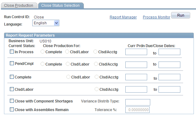

Use the Close Status Selection page (RUN_SFS1100A) to define the production close criteria.
Navigation:
This example illustrates the fields and controls on the Close Status Selection page. You can find definitions for the fields and controls later on this page.
Field or Control |
Description |
Current Status |
Select one or more of these production statuses:
Close Production For |
Select the new production status. Values are:
Curr Prdn Due/Close Dates (current production due and close dates) |
Enter the appropriate date ranges. If you are closing any In Process or Pending Complete production, the system closes any production IDs or production schedule quantities whose production due date falls within the date range specified. If you are closing any production IDs or production schedule quantities whose current status is Complete or Closed for Labor, the system closes any production whose close date falls within the range specified. |
Complete with Component Shortages |
Select this check box if you want to close production even if you haven't issued all the scheduled material for the production ID or production schedule. In this instance, the quantity issued to production is less than the current scheduled quantity for the component. |
Variance Distrib Type (variance distribution type) |
(Optional) Displays the variance distribution type, which can be used in conjunction with the transaction group for variances to define the accounting entries to post the variance to the general ledger. The default distribution type for the transaction group (if one was defined) appears, but you can override the distribution type for each accounting close. This field is used only when closing production for accounting. |
Close with Assemblies Remain (close with assemblies remaining) |
Select this check box if you want to close production even though the full production quantity hasn't been completed. Production can close with remaining assemblies only if the production quantity has not been started. Once any quantity is in process, you must complete the assemblies for production to close. |
Tolerance % |
You must indicate a tolerance percentage if you selected the Close with Assemblies Remain check box. Use this field to define what percentage of assemblies can remain uncompleted and still close production with remaining assemblies. For example, if you have a production ID with an order quantity of 100 but have completed only 92 units and enter a tolerance percentage of 5 percent, this production ID will not close because the quantity remaining to be completed is 8 percent of the order quantity. The default is 0 percent. The system closes any production in process, pending complete, complete, or closed for labor if the quantity of assemblies completed and scrapped at each operation equals the quantity started at each operation. |
Run |
Click to run this request. Process Scheduler runs the Close Production process at user-defined intervals. |
