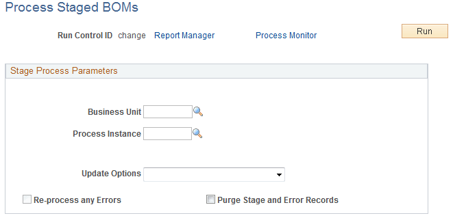

Use the Process Staged BOMs page (EN_RUN_BOMSTAGE) to reprocess corrected staged BOMs using the Process Staged BOMs process.

This example illustrates the fields and controls on the The Process Staged BOMs process page . You can find definitions for the fields and controls later on this page.
Field or Control |
Description |
Update Options |
Select an update option. Values are:
Re-process any Errors |
If you are processing a large number of BOMs, you can correct the errors in the BOM pages but leave the status as Error. You then select this check box while running the BOM Loader process, and the system reprocesses transactions with the statuses of New, Reprocess, and Error. If this check box is deselected, only transactions with statuses of New and Reprocess are processed. This option is only applicable when you select Validate Only or Validate and Transfer. |
Purge Stage and Error Records |
Select this check box to delete the error transactions from the staging table once you have run this process.
Run |
Click to run this request. PeopleSoft Process Scheduler runs the Staged BOMs process at user-defined intervals. |
