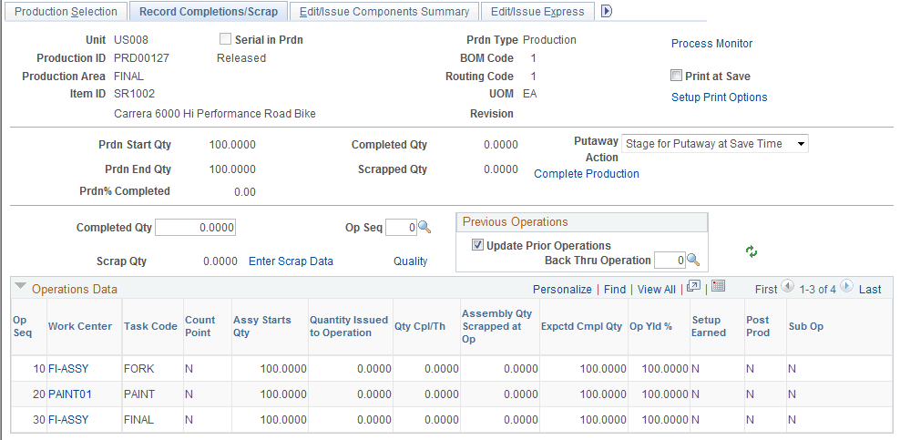

Use the Record Completions/Scrap page (SF_COMPL_ID) to enter completions and scrap information for production IDs.
In addition, use this page to move end items for production IDs with a single output or multiple outputs.
Navigation:
This example illustrates the fields and controls on the Record Completions/Scrap page. You can find definitions for the fields and controls later on this page.
Previous Completions Information
Field or Control |
Description |
Prdn Start Qty (production start quantity) and Prdn End Qty (production end quantity) |
Displays default quantity values from the Production ID Maintenance component. These values are updated whenever the quantity completed is changed. |
Prdn% Completed (production percentage completed) |
Displays the percentage of the batch production quantity that has been completed prior to this transaction. |
Completed Qty (completed quantity) and Scrapped Qty (scrapped quantity) |
Displays a quantity that represents the quantity that has been completed at the last operation. Scrapped quantity represents the quantity that has been scrapped at all operations. |
Putaway Action |
Select which putaway process to use. Options are:
Note: Upon saving the page, either stage the item for putaway or initiate the putaway process. Item completions are not allowed if the end item or a component of the end item is on hold. Similarly, item completions are prevented if a co-product or recycle by-product is on hold. However, completions are allowed for waste by-products with a hold status. |
Print at Save |
Select this check box if you want to print production documents for this particular production ID at save time. |
Setup Print Options |
Click this link to access the Process/Output Options page to select different print criteria for the production documents. |
Recording Operation Completions
Field or Control |
Description |
Completed Qty (completed quantity) |
Enter the entire production ID quantity or any portion of that quantity for each operation sequence that you want to record completions. You can enter completions as many times as necessary to complete the production quantity for the production ID. For production IDs with a single output, this field represents the quantity completed at the operation sequence. |
Op Seq (operation sequence) |
Select the operation step where the end items were completed. You can record partial completions by specifying any valid operation sequence, even if prior operation completions haven't been recorded. If you're using count points and you enter an operation sequence that is not a count point, then you can record only scrap. When using count points, completion quantities can only be entered at operations flagged as count point operations. |
Update Prior Operations |
Select this option if you want to automatically record completions and scrap for prior in-house operations at the same time that you're recording completions for this operation. |
Back Thru Operation |
Indicate how far back you want to report completions by selecting the operation sequence. The quantity that you're currently completing is added to any previously completed quantities at all prior operations specified. If you're using count points, this field displays the operation after the previous count point. |
Previous Operations |
If you're recording prior operations at a later time, do not enter any information in this group box, and ensure that the Update Prior Operations check box is deselect. |
Click the Refresh button to update the information in the Operations Data grid. |

You can use count points to record end item completions.
To record completions and scrap for production IDs using count points:
Access the Record Completions/Scrap page.
Enter the Completed Quantity for the operation sequence.
If you enter the completed quantity first, only the count point operation steps are available.
Select the Op Seq (operation sequence) that is a count point.
If you click the operation sequence look up without entering a completed quantity, all operation sequences appear.
Note: When you record completions at the last operation (which must be a count point), the system assumes that you have or will complete at all prior count points. Therefore, the completed quantity is updated only back to the prior count point.
Because the system automatically completes back to the operation after the previous count point, the Update Prior Operations and the Back Thru Operation fields are unavailable and the operation after the prior count point (operation sequence) appears by default. This indicates that the quantity completed will also be recorded for operations up to, but not including, the prior count point. If you're recording completions at the first count point, the system automatically completes back through and including the first operation.
All other processes, such as entering scrap data and routing completed end items, remain the same as those used with completing production IDs at intermediate operations.

To record completions at the last operation:
Enter the last operation on the operation list in the Op Seq (operation sequence) field if you want to complete all operations for the production ID and all of the operations are performed in-house.
Select Update Prior Operations, then select the first operation from the Back Thru Operation options.
Enter the number of completed end items in the Completed Qty (completed quantity) field.
You can record completions for the entire production quantity for the production ID or any portion of the quantity.
Note: Co-products can only be completed at the last operation.
Navigation:
When completing end items at the last operation, the Route-To PID/Stor Locations scroll area on the Record Completions/Scrap page becomes available. You can route the completed end items to a storage area, another production ID, or to a WIP location. Additionally, if the end item is lot- or serial-controlled, or if you're utilizing containers, you can assign serial numbers, lot IDs, or container IDs to the completed end items.
If a default putaway location is defined for the end item, you can route the completed end items to that location using the routing portion of the page.
Click Apply Defaults to indicate that you want to put away the end items to the default putaway location.
Note: The completions process puts away items in their standard UOMs.
