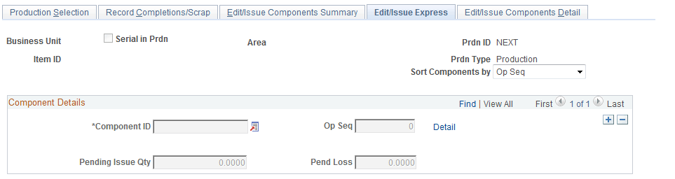

This example illustrates the fields and controls on the The Record Completions and Scrap-Edit/Issue Express page. You can find definitions for the fields and controls later on this page.
If the backflush lot selection rule is Manual, then the backflush process does not default lot IDs. You must manually enter the specific lot IDs and the quantity from each lot for consumed lot-controlled components.
If the backflush lot selection rule is Earliest Expiration Date or Earliest Available Date, then the backflush process consumes lot-controlled components by choosing the lot IDs and quantities from each lot ID within the WIP locations. The following rules are applied:
The backflush process does not override an existing lot entry but populates any blank fields or default-value fields.
The process can select one or more lots. For example, if 15 units are needed, the first 8 units are selected from lot L200, when this lot is exhausted then the last 7 units are selected from lot L500.
The process consumes lot-controlled stock until the consumed component is satisfied or the existing stock in the WIP location is exhausted. If there is not enough lot quantity in the WIP location, then the process leaves the remaining quantity in the pending issue quantity and pending loss quantity, as appropriate.
If the rule finds multiple lots in the WIP location that could be used, then the first tiebreaker is the opposite date (that is, the Earliest Expiration Date rule uses the earliest available date and the Earliest Available Date rule uses the earliest expiration date). If there still are multiple lots, then the next tiebreaker is the ascending lot ID value.
For consigned items, the process uses the stock in the owned WIP location. If more quantity is needed, then the non-owned WIP location is used.

Component ID
Component's Op Sequence
Component's Qty Code
Component's Qty Per
Picking a substitute item
In addition, entering a pending issue quantity or a pending yield loss quantity when there is no completion or scrap quantity triggers the calculation of the backflush lot selection rule. If the lot consumption fields have already been populated and then you manually change the pending issue quantity or a pending yield loss quantity, the system displays the following message:
Message Text: Recalculate the Lot IDs to consume (Y/N)?
Explanation: You have modified the pending issue or pending loss quantity for a component that contains values in its lot scroll. Select Yes to clear the lot scroll and repopulate based on the entered quantity - all other occurrences of this component on the component list which share the same WIP location will also have their Lot IDs recalculated. Select No to keep the pending quantity entered without changing the lot scroll - you will then need to modify the lot scroll so that its quantities correspond with the pending quantity entered. Select Cancel to cancel the action - the original pending quantity will be restored and the lot scroll will not be modified.
