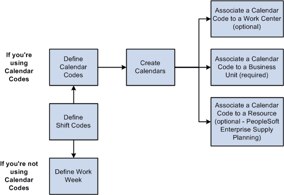

This diagram illustrates how the system finds the production calendar code used by the scheduling and planning functions. The system first looks to the work center, if no calendar code is defined, then the system looks to the business unit and then the resource (if PeopleSoft Supply Planning is used). If no calendar code is defined then the system uses the defined work week.

Once you create calendar codes and the associated run time calendar, you can associate them to the business unit, work centers, and resources. Once you attach the calendar code, its associated run time calendar code appears, indicating that the calendar is created and recognized in the planning and scheduling process.
