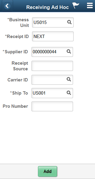

Use the Receiving Ad Hoc- Fluid page to define information for ad hoc receipts
Navigation:
This example illustrates the fields and controls on the Receiving Ad Hoc - Fluid Page. You can find definitions for the fields and controls later on this page.
Use this page to define basic information about an ad hoc receipt and to establish processing options for ad hoc receiving.
Note: To use this transaction, ensure that the Change Non PO Receipt Price check box is selected on the Receive Setup page for your user preferences. To access the check box, select:
Note: The Receipt Accrual process does not include ad hoc receipts in its processing because the Receipt Accrual skips these receipts.
Field or Control |
Description |
Business Unit |
Displays the user's default business unit. You can change the business unit. A business unit is required. |
Receipt ID |
Enter the receipt number that you want to use to create the ad hoc receipt. The system assigns the number when you save the receipt. The default value for the field is Next. You do not have to enter a number if you use the default value. The number is based on the autonumbering sequence defined in the PeopleSoft system for receipts. This field is required. |
Supplier ID |
Enter the supplier identification number from whom the shipment was received. The default value for the field is based on the business unit's default supplier for Mobile Receiving Ad Hoc. The field is required. |
Receipt Source |
Enter the source of the receipt if the source is not a valid supplier ID in your PeopleSoft system. |
Carrier ID |
Enter the freight carrier identification that delivered the shipment. |
Ship To |
Enter the ship to location. The default value from user preferences initially appears in the field. You can override the value. The field is required. |
Pro Number |
Enter the tracking number assigned to the shipment in which the material arrived. |
Add |
Click the Add button to add items to receive using this ad hoc receipt. The Add feature is also initiated when you tab out of the Ship To field. For more information about the Add feature, see "Selecting Items to Receive Using Ad Hoc Receipts." |

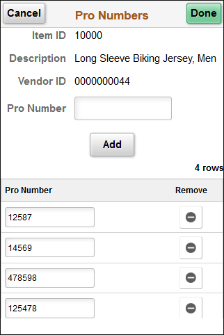

Pro Number (progressive number) |
Enter the tracking number assigned to the shipment in which the material arrived. Note: When this field is left blank, the default value is derived from the header page for an added item and on an added line. |

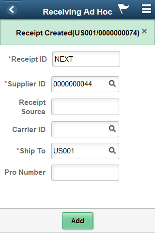

Click to save count of items added. Note: The system displays a receipt created message at the top of the page briefly. |

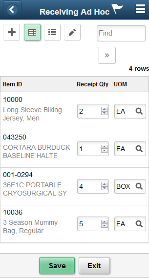

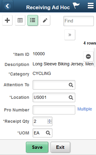

You can view item information in a grid and list views and also modify any if necessary.
This example illustrates the fields and controls on the Receiving Ad Hoc - Grid View Fluid Page.
This example illustrates the fields and controls on the Receiving Ad Hoc - List View Fluid Page.
This example illustrates the fields and controls on the Receiving Ad Hoc - Multiple Pro Numbers Fluid Page.

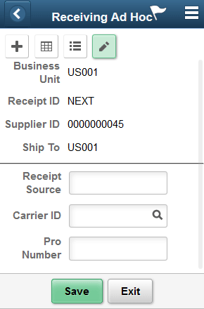

This example illustrates the fields and controls on the Receiving Ad Hoc - Edit View Fluid.
This example illustrates the fields and controls on the Receiving Ad Hoc - Receipt Creation Fluid Page.
