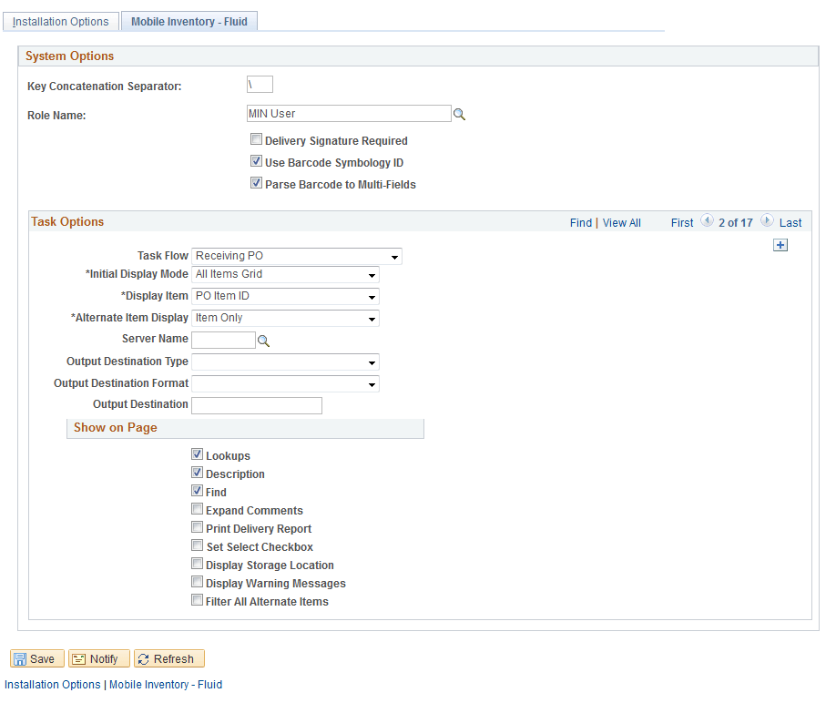

Use the Installation Options - Mobile Inventory - Fluid page (INSTALLATION_MIN_N) to establish Mobile Receiving options for purchase orders with receipts.
Establish Mobile Receiving options for ad hoc receipts.
Navigation:
Select the Receiving PO task flow.
This example illustrates the fields and controls on the Installation Options - Mobile Inventory - Fluid: Receiving PO task flow page. You can find definitions for the fields and controls later on this page.
You use installation options to define default values for Mobile Receiving pages in the PeopleSoft system and to control the behavior of the transaction.

Use the Installation Options - Mobile Inventory - Fluid page (INSTALLATION_MIN_N) to establish Mobile Receiving options for ad hoc receipts
Navigation:
Select the Receiving Ad Hoc task flow.
This example illustrates the fields and controls on the Installation Options - Mobile Inventory - Fluid: Receiving Ad Hoc task flow page.
You use the installation options to define default values for Mobile Receiving pages in the PeopleSoft system and to define page values available on a mobile device.
Each field on this page is also on the Installation Options - Mobile Inventory: Receiving PO task flow page.

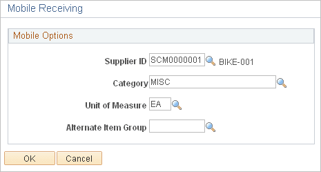

Use the Mobile Receiving page (BU_OPT_MOBILE_REC) to establish Mobile Receiving Ad Hoc default values.
Navigation:
Set Up Financials/Supply Chain, Business Unit Related, Purchasing, Purchasing Definition, and click the Mobile Receiving link
This example illustrates the fields and controls on the Mobile Receiving page. You can find definitions for the fields and controls later on this page.
You use this page to define default values that will be used by the Receiving Ad Hoc component.

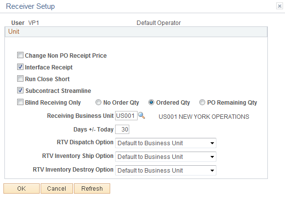

Use the Receiver Setup page (OPR_DEF_RECV_SEC) to establish printer defaults for the Mobile Receiving Delivery report.
Navigation:
This example illustrates the fields and controls on the Receiver Setup page.

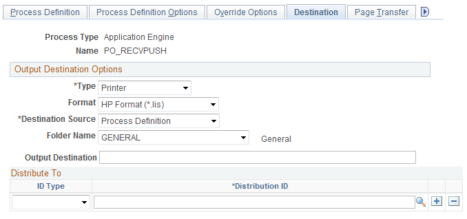

Use the Processes page (PO_RECVPUSH) to establish printer defaults for the Mobile Receiving Delivery report.
Navigation:
This example illustrates the fields and controls on the Processes page.
