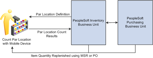

The following diagram illustrates the par location counting process when using mobile devices and PeopleSoft Mobile Inventory Management:
This example illustrates the process flow for counting the stock in a par location using a mobile device.
The sequence of events in the par location count using PeopleSoft Mobile Inventory Management is:
The par locations should be defined in the PeopleSoft Inventory business unit including the items in each par location, the optimal quantity for each item, and how each item should be replenished.
Use your mobile devices to count the par locations.
Based on your setup for the par location in PeopleSoft Inventory, you can:
Enter the current item quantity in the par location (count quantity) or enter the quantity needed in the par location (requested quantity).
Count just the items that you choose or those items that are required to be counted.
Accept or adjust an estimated count quantity that can be displayed to save input steps or conduct a blind count by entering each item quantity in a blank field. The default count quantity is calculated by the Calculate Average Usage process in PeopleSoft Inventory.
In PeopleSoft Inventory, run the Create Par Replenishment Requests process to generate orders for items that fall below optimal quantity levels. Based on your par location setup, this process replenishes the par locations using material stock requests, requisitions, or purchase orders.
