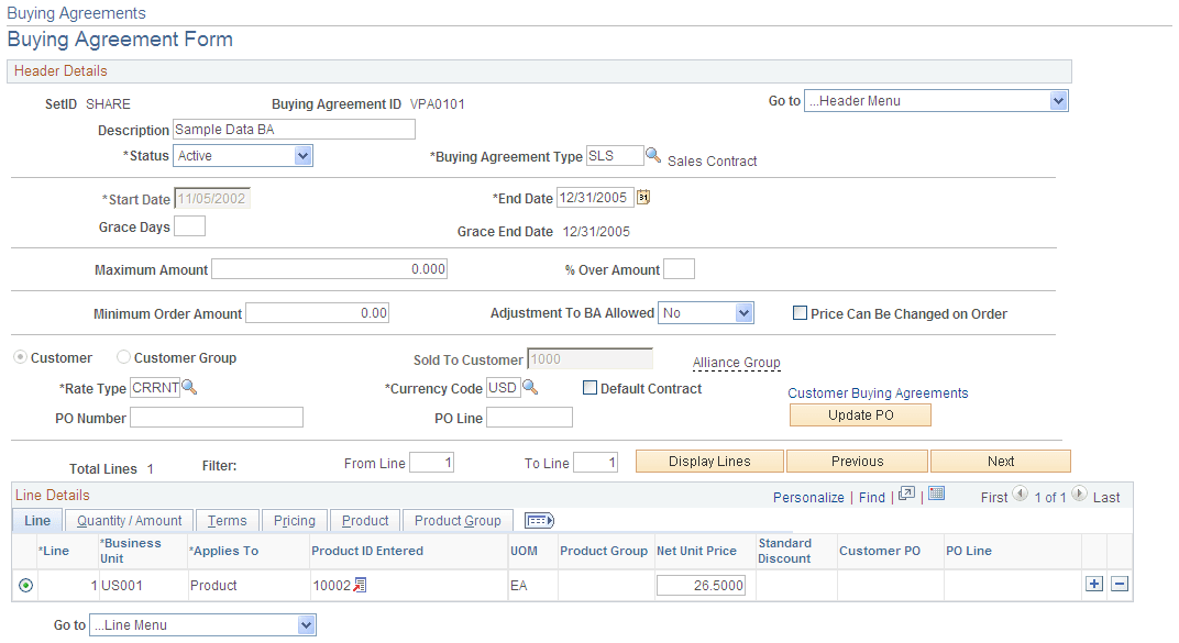

Use the Buying Agreement Form page (SCON_FORM) to enter buying agreement header information.
Define to whom the buying agreement applies (this can be a customer or customer group) and the effective dates of the buying agreement. Enter buying agreement line information including associated product groups or product IDs and establish pricing for those products.
Navigation:
This example illustrates the fields and controls on the Buying Agreement Form page. You can find definitions for the fields and controls later on this page.
Note: If you enter orders against a buying agreement or if orders are automatically created from releases, the only changes that you can make on the buying agreement line are in the Maximum Quantity (or Amount) and % Over fields.
