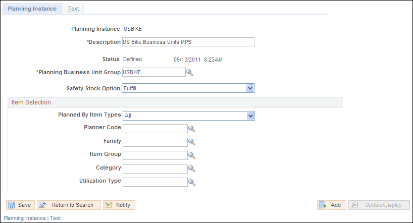

Use the Planning Instance page
Navigation:
This example illustrates the fields and controls on the Planning Instance Page. You can find definitions for the fields and controls later on this page.
| Field or Control | Description |
| Status | Displays the status of the Planning Instance Load process for the corresponding planning instance ID or the last major data exchange that occurred for the planning instance. |
| Safety Stock Option | Select the desired safety stock option from:
| Planned By Type | Select only those items that are associated with the specified planned by types. |
Note: A change to the item selection criteria has no effect on the next regenerative select or net change Load Planning Instance process run. Field values in the Item Selection group box apply to full regenerations only.
