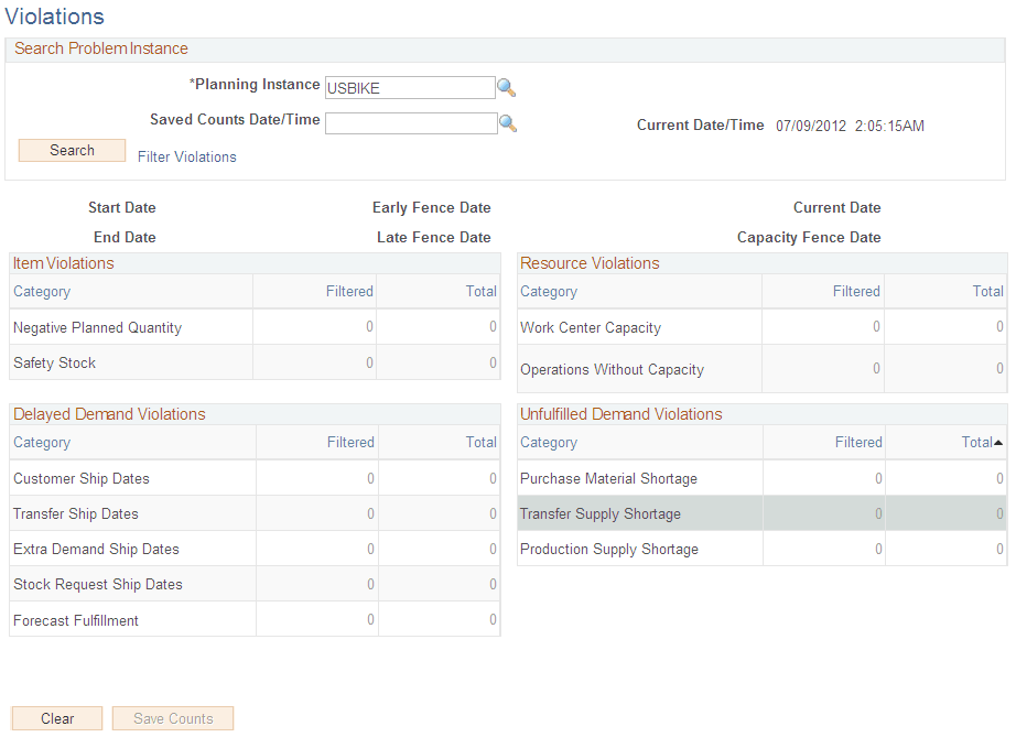

Use the Violations page (PL_REVIEW_ERRORS) to establish plan violation criteria and filters and retrieve violations that prevent a material or capacity plan from being feasible.
Navigation:
This example illustrates the fields and controls on the Violations Page. You can find definitions for the fields and controls later on this page.
Field or Control |
Description |
Saved Counts Date/Time |
Select a previously saved set of violation counts for review. You can save summary violation counts at any time, including before or after solver runs. When you save violation counts, the system retains the totals only. Additional details for saved counts are not available. |
Search |
Click to perform a new search using the filters that you defined. |
Filter Violations |
Click to access the Violations - Filter Violations page, where you can specify selection criteria to narrow the number of violations that the system displays on the Violations summary page. |
Start Date |
The beginning time boundary. Used with the end of time, this region defines the time period within which the system recognizes orders and changes. Solvers do not recognize times before the start of time. |
End Date |
The concluding time boundary. Solvers do not recognize orders or changes after this date. |
Current Date |
The current date and time for the planning instance. This fence is used to define various time offsets respected by the planning solvers. |
Early Fence Date |
The beginning time of the interval within which solvers process the elements of the material- and capacity-feasible plans and calculate constraint violations. |
Item Violations
Field or Control |
Description |
Negative Planned Quantity |
An item has a negative planned quantity on hand between the item's early fence and the late fence. The system calculates the violation if the item's histogram quantity falls below zero at any time between the current time and the late fence. Note: The system counts an item with negative planned quantity only once, even if the item has multiple occurrences of negative planned quantity on hand. |
Safety Stock |
The system generates a violation if an item has a planned quantity on hand below safety stock between the item's early fence and the late fence. Note: The system counts an item with stock violations only once, even if the item has multiple occurrences of safety stock violations. |
Delayed Demand Violations
Field or Control |
Description |
Customer Ship Dates |
The target ship date on a customer order cannot be met, and the order will ship late. The system generates a violation if the planned ship date is after the target ship date. |
Transfer Ship Dates |
The scheduled ship date on a transfer cannot be met and the transfer will be supplied late. The system generates a violation if the planned ship date is after the scheduled ship date. |
Extra Demand Ship Dates |
The target demand date on an extra demand required cannot be met and the extra demand will be supplied late. The system generates a violation if the planned schedule date is after the schedule ship date. |
Stock Request Ship Dates |
The target ship date on a material stock request cannot be met and the material stock request will be shipped late. The system generates a violation if the planned ship date is after the schedule ship date. |
Forecast Fulfillment |
A forecast demand cannot be met on the forecast date. The system generates a violation if the forecast demand has been canceled or satisfied at a later time. |
Resource Violations
Field or Control |
Description |
Work Center Capacity |
A work center is overloaded. The system generates a violation if the work center's aggregate utilization exceeds the resource aggregate capacity between the global early fence and the capacity fence. Note: The system counts a work center capacity violation only once, even if the work center has multiple periods where it is overloaded. |
Operations Without Capacity |
A production operation occurs at a work center for which the work center capacity has been exceeded. The system generates a violation only for production operations for which no or partial work center availability exists. For example, if an operation occurs in an overloaded capacity bucket and the operation only consumes available capacity, the system does not generate a violation. The system sorts which operation steps use the available capacity according to:
By sorting based on operation start date and time, the system first allocates available capacity to operations that may have started in a previous capacity bucket. |
Unfulfilled Demand Violations
Field or Control |
Description |
Production Supply Shortage |
Demand has no supply for items where the default sourcing option is a production option. The system generates a violation if the supply for any demand on an item (for which the default sourcing option is a production sourcing option) does not exist or would occur after the demand date. If an item has no default sourcing option, the system considers the sourcing type a production sourcing option if the item's make or buy option is Make. |
Purchase Material Shortage |
Demand has no supply for items where the default sourcing option is a purchase option. The system generates a violation if the supply for any demand on an item (for which the default sourcing option is a purchase sourcing option) does not exist or would occur after the demand date. If an item has no default sourcing option, the system considers the sourcing type a purchase sourcing option if the item's make or buy option is Buy. |
Transfer Supply Shortage |
Demand has no supply for items where the default sourcing option is a transfer option. The system generates a violation if the supply for any demand on an item (for which the default sourcing option is a transfer sourcing option) does not exist or would occur after the demand date. |

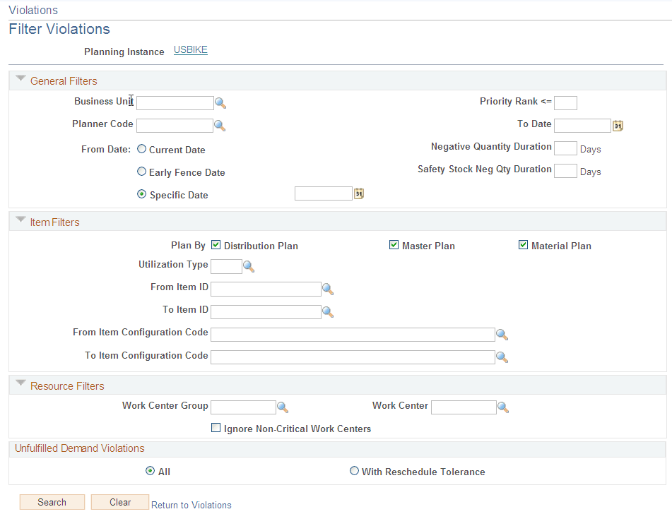

Use the Violations - Filter Violations page (PL_RVW_ERR_FILTERS) to specify selection criteria to narrow the number of violations that the system displays on the Violations summary page.
Navigation:
Click the Filter Violations link on the Violations page.
This example illustrates the fields and controls on the Filter Violations Page. You can find definitions for the fields and controls later on this page.
Field or Control |
Description |
Business Unit |
Select violations for the specified inventory business unit only. For interunit transfers, the system uses the source business unit. |
Planner Code |
Select violations for items associated with a specific planner code only. |
From Date and To Date |
Select violations in the date range specified only. For item violations and capacity violations, the system selects only those violations where the occurrence falls within the date range for the item. For delayed demands, the system selects violations only if the target ship date is in the date range. For unfulfilled demands, the system selects violations only if the demand date is in the date range. Define the from date as an early fence date, current date, or as a specific date. If you specify no date range, the system uses the late fence date as the to date when calculating for violations. |
Priority Rank |
Applies to unfulfilled demand violations and delayed demand violations only. Select violations if the item's demand priority rank is equal to or higher than the specified priority. Note: Small priority rank numbers (those numbers closer to zero) have higher demand priorities. |
Negative Quantity Duration |
Select only the negative quantity violations in which the duration is greater than or equal to the number of days specified in this field. |
Safety Stock Neg Qty Duration (safety stock negative quantity duration) |
Select only the safety stock violations in which the duration is greater than or equal to the number of days specified in this field. |
Planned By |
Select only those violations that are associated to items with these specified planned-by types: distribution plan, master plan, and material plan. |
Utilization Type |
Select only those violations with items that are associated with the utilization type. |
From Item ID and To Item ID |
Select only those violations with item codes in the specified range. |
From Item Configuration Code and To Item Configuration Code |
A non-active field that is related to a deprecated product. |
Work Center |
Select capacity violations that occur on the specified work center. The work center filter applies to operations without capacity and aggregate capacity violations only. |
Work Center Group |
Select capacity violations that occur on work centers in the specified work center group. The work center group filter applies to operations without capacity and aggregate capacity violations only. |
Ignore Non-Critical Work Centers |
Select the check box to ignore capacity violations for Non-Critical Centers. |
Field or Control |
Description |
All |
Shows all Unfulfilled Violations. This is the default selection. |
With Reschedule Tolerance |
Select to display Unfulfilled Violations, without considering demands which are satisfied by supplies within tolerance. |
Note: The system determines the aggregate capacity error total according to the total count in the Operations without Capacity Filtered column on the Violations page. For example, suppose that after applying the item filter, the operations without capacity all occur on the same work center (and the total in the corresponding Filter column equals 1), then the work center capacity total error count equals 1.
Field or Control |
Description |
Return to Violations |
Click to return to the Violations page without performing a search. |
Search |
Click to apply the filtering criteria and review the results on the Violations page. |
Clear |
Click to delete all of the previously entered filter criteria. |

Use the Violations - Unfulfilled Demand Violations page (PL_RVW_ERR_SUPPLY) to review violations related to unavailable supply for existing and planned demands.
Navigation:
click any amount total in the Filtered or Total column in the Unfulfilled Demand Violations group box on the Violations page.
Common Information
Field or Control |
Description |
Order Type |
Displays the type of demand for the corresponding item. |
Order |
Displays the order number. For example, depending on the order type, this field might display a sales order number, quote number, or buying agreement number. Click any value in this column to access the corresponding Refine Plan Details page for the order type. For example, suppose that the order type is Material Stock Request, you can click the order ID value to access the Refine Plan - Stock Requests page, where you can maintain information about internal and external demand orders on an inventory business unit, such as planning parameters, dates, and quantities. |
Order Tab
Select the Order tab.
Field or Control |
Description |
Operation Sequence |
Displays where you need components in the manufacturing process. PeopleSoft Production Management uses the work center associated with each operation and the WIP location associated with each work center to determine where to deliver components. The component's issue method in combination with the operation sequence determines when and where the material is delivered. It determines how the system updates inventory in the WIP location, as well as the quantity issue on the component list. When the operation sequence is set to zero or an invalid operation sequence is specified, it is assumed that the component item is to be used for the first operation. |
Details Tab
Select the Details tab.
Field or Control |
Description |
Demand Quantity |
Displays the demand quantity for the corresponding order. |
Priority Rank |
Displays a numeric value ranging from 1 (highest priority) to 999 (lowest priority) used by the planning engine to determine the order in fulfilling the demand. The system reserves 0 as a priority value. |
Ship To Customer |
Displays the customer ID to which the order is shipped. The customer name appears in the adjacent field. |
Use the Demand Violations Search page (SPL_DMD_V_INQ_SRCH) to specify search filters and retrieve violations generated by the Extract Demand Violations process.
Navigation:
Supply Planning, Solve Plan, Analysis, Demand Violations
Field or Control |
Description |
Planning Instance |
Select violations for the specified planning instance. |
Business Unit |
Item ID |
Select violations for the specified item ID only. |
Planner Code |
Planned By |
Start Date and End Date |
Select violations in the date range specified only. The system selects violations only if the planning date is in the date range. If you specify no end date, the system uses the late fence date as the end date when searching for violations. |
Family |
Select violations for the specified item family only. |
Utilization Type |
Category |
Select violations for the specified item category only. |
Search |
Click to apply the filtering criteria and review the results on the Demand Violations Detail page. |
Clear |
Order Type Filters |
Indicate whether you want to include violations that pertain to these orders types: sales orders/quotes, purchases, production, transfers, buying agreements, planned purchases, planned production, planned transfers, forecasts, stock requests and extra demand. |
