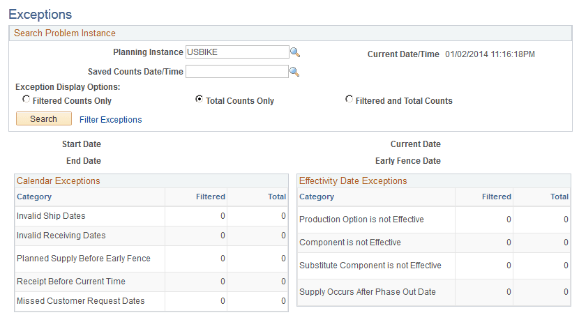

Use the Exceptions page (PL_RVW_EXCP_SUM ) to review exceptions by planning object type.
You can navigate to detailed exception information.
Navigation:
This example illustrates the fields and controls on the Exceptions page (1 of 2). You can find definitions for the fields and controls later on this page.

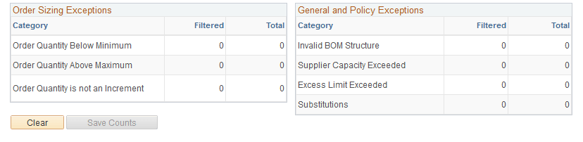

This example illustrates the fields and controls on the Exceptions page (2 of 2). You can find definitions for the fields and controls later on this page.
Field or Control |
Description |
Saved Counts Date/Time |
Select a previously saved set of exception counts for review. You can save summary exception counts at any time, including before or after solver runs. When you save exception counts, the system retains the totals only. Additional details for saved counts are not available. |
Exception Display Options |
Indicate how you want the system to calculate and display summary counts. Values are:
If you select Total Counts Only, you can specify the exception type, general, and order type filters criteria, but the system ignores these filters when calculating the total counts. |
Start Date |
The beginning time boundary, before which time does not exist within the planning instance. Used with the end of time, this region defines the time period within which the system recognizes orders and changes. Solvers do not recognize times before the start of time. |
End Date |
The concluding time boundary for the planning instance. Solvers do not recognize orders or changes after this date. |
Current Date |
The current date and time as established for the planning instance. This fence is used to define various time offsets respected by the planning solvers. |
Early Fence Date |
The default early fence for the planning instance. |
Save Counts |
Click to save the summary exception counts to the database for retrieval and review at a later date. Use the Save Counts Date/Time field to select a saved exception count for review. |
Calendar Exceptions
Displays supply and demand that occurs at invalid calendar times. Click any link in the Filtered or Total column to access the Calendar Exceptions page, where you can view additional information about the corresponding constraint.
Order Sizing Exceptions
Click any link in the Filtered or Total column to access the Order Sizing Exceptions page, where you can review additional information about the existing orders that do not follow the order minimums, maximums, or increments associated with an item's sourcing definitions.
Effectivity Date Exceptions
Click any link in the Filtered or Total column to access the Effectivity Date Exceptions page, where you can review additional information about orders where exceptions to effectivity dates have been encountered.
General and Policy Exceptions
Click any link in the Filtered or Total column to access the Policy Exceptions page, where you can review additional information about BOM exceptions found while calculating low level codes, planned quantity on hand levels greater than the excess limit, and orders where substitutions have been made.
