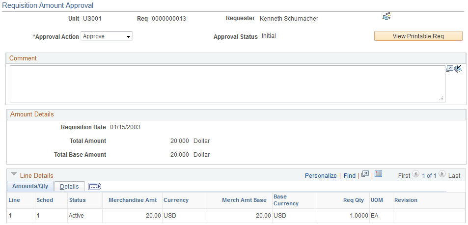

Use the Requisition Amount Approval page (REQ_APPROVAL_AMT) to approve, deny, or recycle a requisition.
You can also view details for amount approvals on this page. If you have a requisition approval role in workflow, you can access this page when you select a requisition from your worklist.
Navigation:
This example illustrates the fields and controls on the Requisition Amount Approval page. You can find definitions for the fields and controls later on this page.
Field or Control |
Description |
Appr Act (approval action) |
Select one of the following actions. If you do not have the authority to complete the approval or if you deny or recycle the requisition, the value in the Approval Status field remains In Process and routes to the next role user in the approval definition. Values are: Approve: Select to approve the requisition amount or ChartField. If you have the authority to complete the approval, the approval status changes to Complete when you save this page. If workflow is implemented, the system sends an email to the requester stating that the requisition has been approved. Deny: Select to send the requisition back to the requester. If workflow is implemented, the system adds the requisition to the requester's worklist and sends the requester an email notification. The requisition approval status changes to Denied. Recycle: Select to send the requisition back to the last user who approved the requisition. If workflow is implemented, the system adds the requisition to the user's worklist and sends the user an email notification. |
Approval Status |
Displays the overall status of the requisition. |
View Printable Req (view printable requisition) |
Click to launch the Requisition Print SQR (requisition print structured query report) process (PORQ010), where you can view additional details about the requisition. This process opens the resulting requisition print PDF file directly to the user's desktop if a REN server is configured. |
Comment |
Enter comments pertinent to your approval action. These comments are saved with the requisition and are visible only on the originating page (the Approve Amounts - Approval page or Approve ChartFields - Approval page). |
Amount Details
The amounts that appear are the amounts that you are to approve. You can change these values on the Maintain Requisitions - Requisition page and Maintain Requisitions - Schedule page.
Line Details - Amounts/Qty Tab
Field or Control |
Description |
Amount |
Displays the price of the items on the requisition line. |
Base Amt (base amount) |
Displays the price of the items on the requisition line expressed in the base currency. |
Revision |
Displays the manufacturer product revision number for the ordered item. If the ship to is an inventory business unit, and the item is under revision control in that business unit, the revision automatically defaults to that effective on the due date. |
Line Details - Details Tab
Select the Details tab.
Field or Control |
Description |
Price Tol /Price Tol Under (price tolerance/price tolerance under) |
Displays the over and under price tolerance amount for the selected requisition line. |
% Prc Tol /% Prc Tol Under (price tolerance percentage/price tolerance under percentage) |
Displays the over and under price tolerance percentage for the selected requisition line. |
RFQ Required (request for quote required) |
Designates whether the purchase of this requisition line item requires an RFQ. |

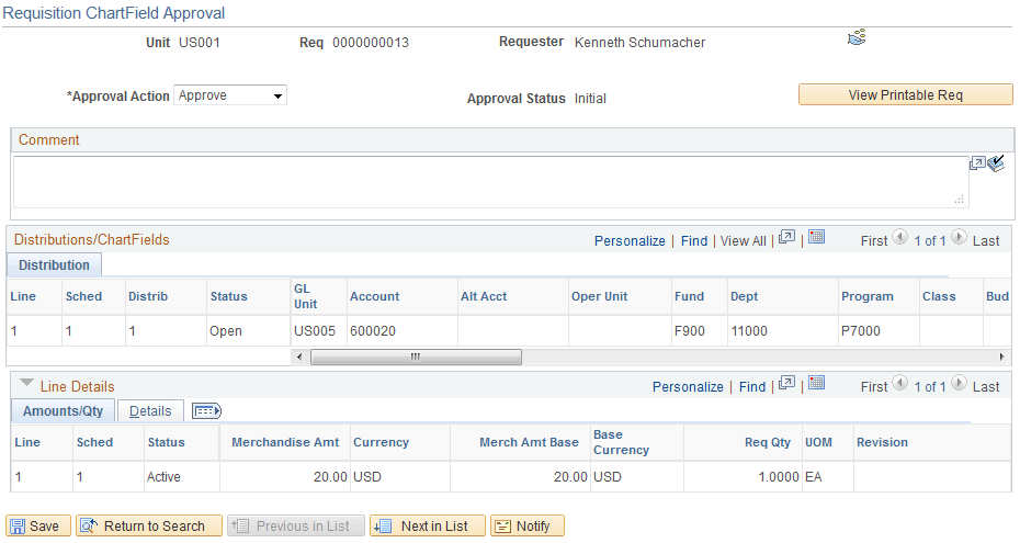

Use the Requisition ChartField Approval page (REQ_APPROVAL_CHRT) to approve, deny, or recycle a requisition based on the ChartFields that appear.
You can also view details for ChartField approvals. If you have a requisition approval role in workflow, you can access this page when you select a requisition from your worklist.
Navigation:
This example illustrates the fields and controls on the Requisition ChartField Approval page. You can find definitions for the fields and controls later on this page.
Field or Control |
Description |
Approval Status |
Comment |
Distributions/ChartFields
These are the ChartField values that you are to approve. You can change these values on the Maintain Requisitions - Requisition page and Maintain Requisitions - Distributions page.
