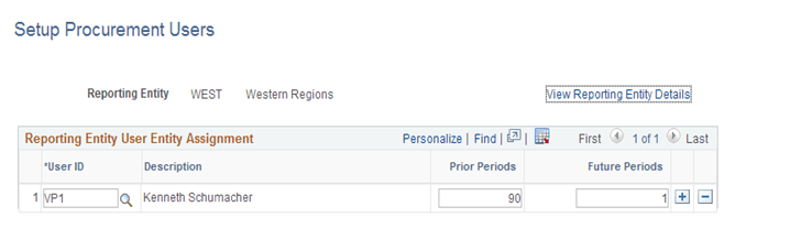

Use the Set up Procurement Users page to assign users to a Reporting Entity and also specify the periods for which data should be displayed. Current period data is displayed in case no data is specified.
Navigation:
This example illustrates the fields and controls on the Setup Procurement Users. You can find definitions for the fields and controls later on this page.
Field or Control |
Description |
User ID |
A user assigned to the reporting entity, can only be associated with one reporting entity. The user's reporting entity is used in the Procurement Operations Home Page and select procurement pivot grids. |
Prior Periods |
Enter the number of periods before the start of the current period at which you want to begin displaying procurement spend accumulation in the Procurement Operations Home Page. |
Future Periods |
Enter the number of periods after the start of the current period at which you want to end displaying procurement spend accumulation in the Procurement Operations Home Page. |
