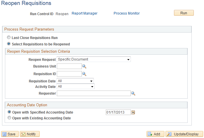

Use the Reopen Requisitions page (RUN_PO_REQREOPEN) to run the Requisition Reopen process.
Navigation:
This example illustrates the fields and controls on the Reopen Requisitions page. You can find definitions for the fields and controls later on this page.
Field or Control |
Description |
Last Close Requisitions Run |
Select this option if you want to reopen the requisitions that were closed during the last run of the Close Requisitions process. When you select this option, the Reopen Requisition Selection Criteria group box is not available. |
Select Requisitions to be Reopened |
Select this option if you want to reopen any requisition that has already been closed. After you select this option, enter the requisition or requisitions you would like to reopen in the Reopen Requisition Selection Criteria group box. |
Field or Control |
Description |
Reopen Request |
Select the reopen request option. Values are:
Requisition Date |
Select a requisition date option. Values are:
Activity Date |
Select an activity date option. Values are:
Requester |
Select the requester. Requisitions associated with this requester will be reopened. |
Accounting Date Options
Field or Control |
Description |
Open with Specified Accounting Date |
Select this option if you want to reopen the requisitions using the accounting date you specify. The current date appears by default in the date field but you can override it if you choose. This field only appears if you are using commitment control. |
Open with Existing Accounting Date |
Select this option if you want to reopen the requisitions using the existing accounting date on the requisitions. This field only appears if you are using commitment control. |
