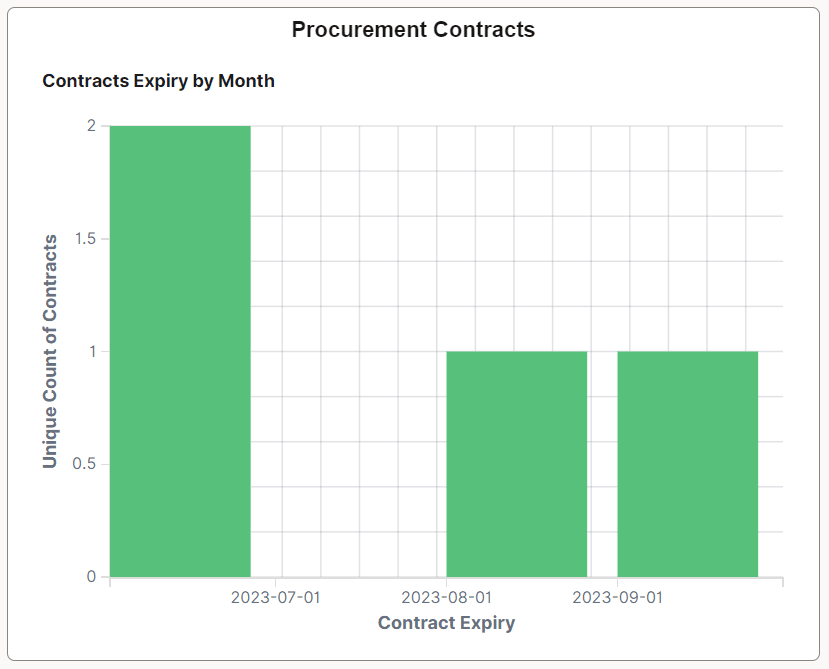

This example illustrates the Procurement Contracts tile.

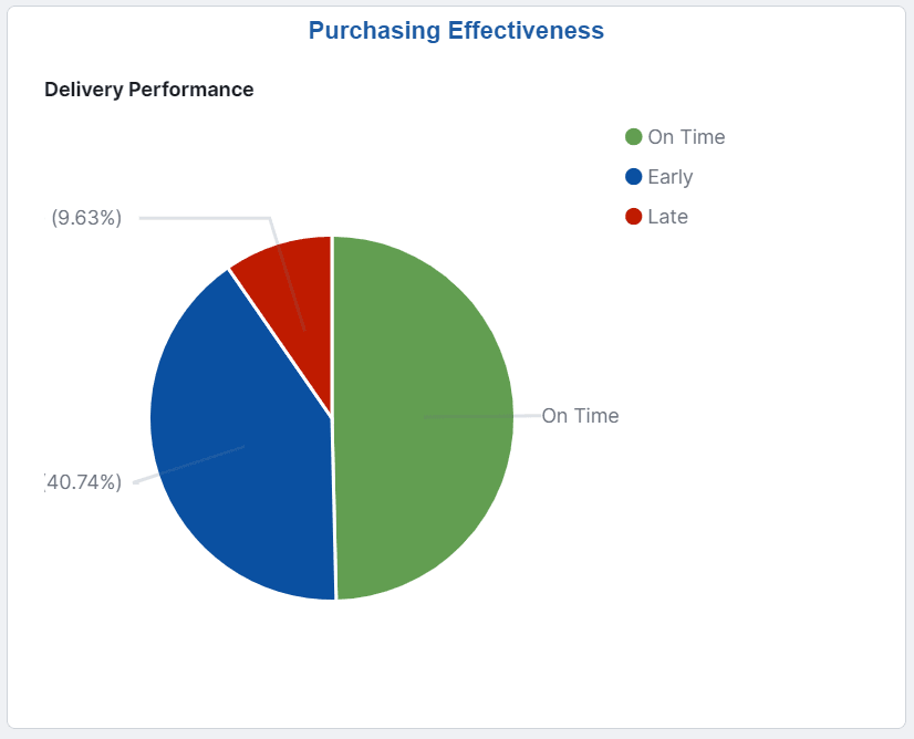

This example illustrates the Purchasing Effectiveness tile.

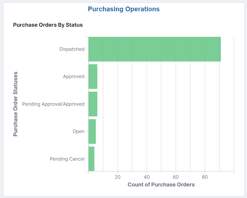

This example illustrates the Purchasing Operations tile.

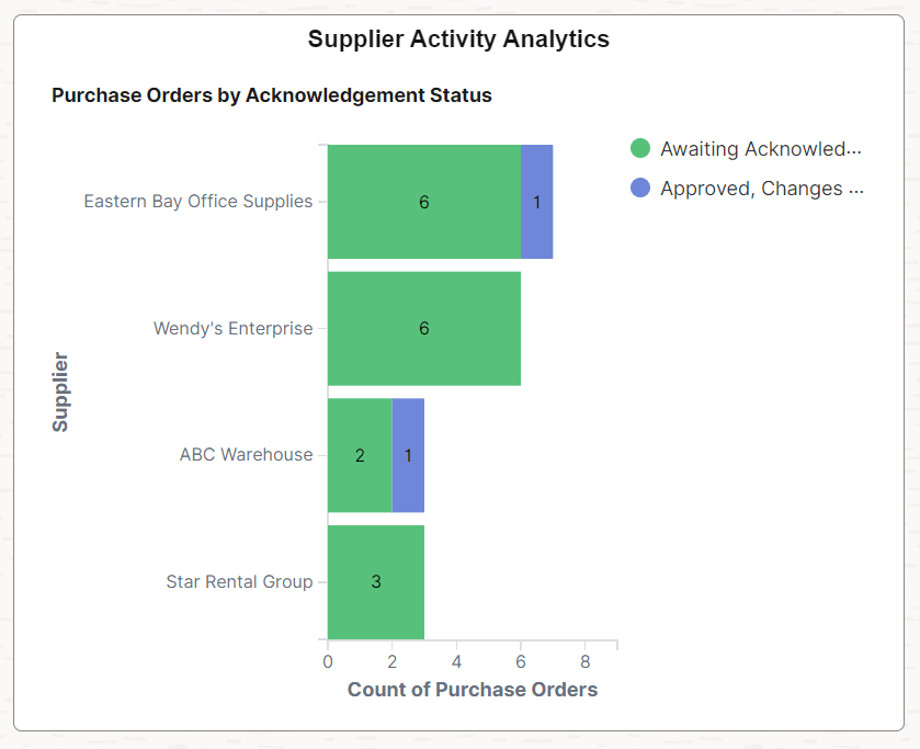

This example illustrates the Supplier Activity Analytics tile.
