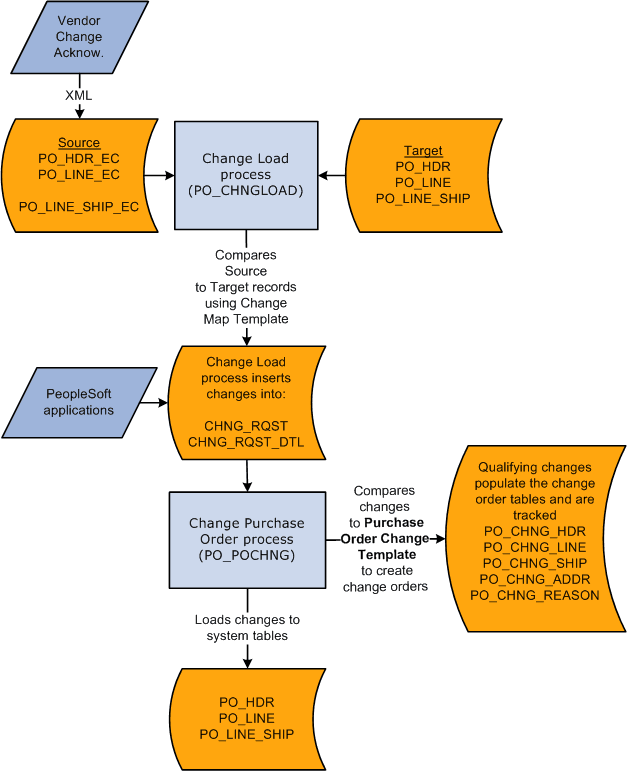

When you update a purchase order that has been dispatched, you create or append a change order. With PeopleSoft Purchasing, you can create change orders online using the purchase order pages, or you can load and process change requests using the Change Load Application Engine process (PO_CHNGLOAD) and Change Purchase Order Application Engine process.
The Change Load process loads data from the PO_HDR_EC, PO_LINE_EC, and PO_LINE_SHIP_EC tables. These tables store supplier acknowledgements that arrived in the system using EDX or supplier-facing online acknowledgements. These acknowledgements may contain information that requires you to change the purchase orders.
Based on the Change Map template, the Change Load process compares staged source record fields and field values (PO_HDR_EC, PO_LINE_EC, PO_LINE_SHIP_EC) with target system record fields and field values (PO_HDR, PO_LINE, PO_LINE_SHIP). If a difference exists, the Change Load process creates change requests (CHNG_RSQT, CHNG_RQST_DTL).
Based on the purchase order change template, the Change Purchase Order process creates the necessary change orders from these change request tables. The Change Purchase Order process takes the change order information and creates change history records (PO_CHNG_HDR, PO_CHNG_LINE, PO_CHNG_SHIP) and updates target system records with the changes.

This diagram illustrates the Change Order process flow:

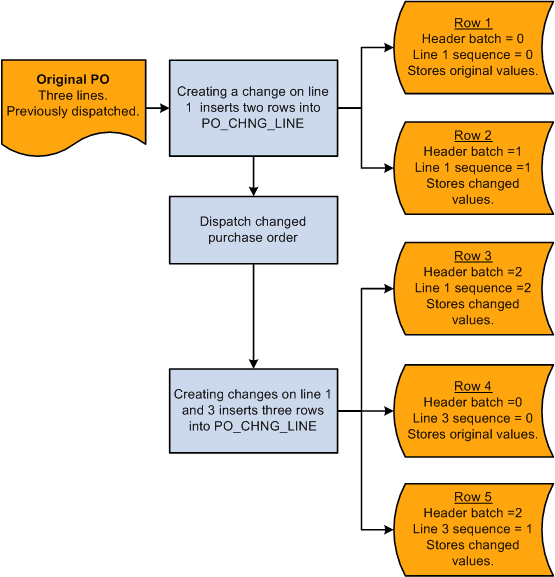

Example
Here is an example of batch changes:
You dispatch a purchase order containing three lines.
You create a change on line 1.
The header change order batch number is set to 1; the change sequence number for the first line is also 1.
Note: A historical row is created to store original values for line 1. The header change order batch number is 0 and change sequence number for the first line is 0.
After you dispatch the first batch of changes (change order batch number 1), you change lines 1 and 3.
The change order batch number is 2, because you are making changes after dispatching change order number 1.
Because this is the second time that you have changed line 1, its change sequence is 2.
Because you have changed line 3 for the first time, its change sequence is 1.
Note: The system creates a historical row to store original values for line 3. The header change order batch number is 0 and the change sequence number for the first line is 0.
This diagram illustrates how the PO_CHNG_LINE table helps track the batch and sequence changes discussed in the example:
Similar changes are stored in PO_CHNG_HDR, PO_CHNG_SHIP, and PO_CHNG_ADDR tables when changes are made to header, schedule, and one time address fields that are eligible for change order tracking.
