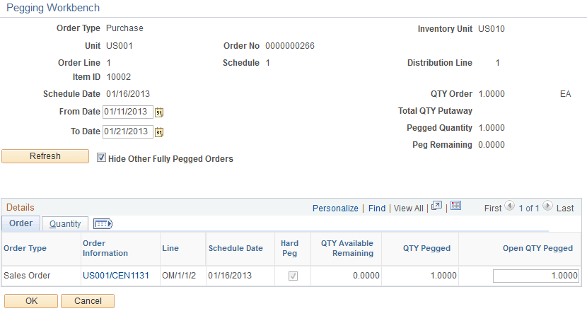

Use the Pegging Workbench page (IN_PEG_DETAIL_SP) to apply, change, or remove pegs from items.
Navigation:
Click the Schedules button for a particular line item on the requisition.
Select the Statuses tab.
Click the Pegging Workbench button.
This example illustrates the fields and controls on the Pegging Workbench page. You can find definitions for the fields and controls later on this page.
Note: Items must indicate that they are to be received into an Inventory business unit to access the Pegging Workbench.
Use the Pegging Workbench to apply, change, or remove pegs. The workbench enables you to link a specific quantity from a demand to incoming supply. For example, 10 units of a soft-reserved item on a sales order's demand line can be pegged to 10 units on a requisition line. One demand line can be pegged to one or more supply-side lines. For example, 10 units of a soft-reserved item on an order's demand line can be pegged to 4 units on one purchase order and 6 units on another purchase order. In addition, you can peg the supply side to the demand side, for example, starting with a purchase order line with 10 units and pegging to a sales order that needs 10 units.
Field or Control |
Description |
From Date and To Date |
Enter beginning and end dates for pegged information. |
Hide Other Fully Pegged Orders |
Select this check box if you want to filter out other orders than are completely pegged to other orders. |
Details
Field or Control |
Description |
Order Information |
Displays the source business unit and order number. Select the line to access an inquiry page with additional information about this order. |
Line |
Displays the order line, schedule line, distribution (or demand) line. |
Schedule Date |
Displays the date of the schedule. |
Hard Peg |
Indicates whether the row has hard-pegged demand or supply. Hard pegs indicate that the existing peg has a one-to-one relationship between a demand line and a supply-side line. If you attempt to peg additional demand or supply quantities to this row, the system displays a warning that will change the peg to a soft peg. If you continue with the change, then the peg chain is changed to a soft peg. |
QTY Available Remaining (quantity available remaining) |
Displays the item quantity that is available to be pegged. |
QTY Pegged (quantity pegged) |
Displays the quantity of this line that has already been pegged to another order. |
Open Qty Pegged (open quantity pegged) |
To create a peg, enter a quantity in this field to be pegged against the line displayed at the top of this page and then click the Save button. This creates the peg chains for the demand and supply. To break (remove) a peg, enter zero in this field and then click the Save button. |
Pegged QTY Received (pegged quantity received) |
Displays the pegged quantity that has already been received into a PeopleSoft Purchasing business unit. |

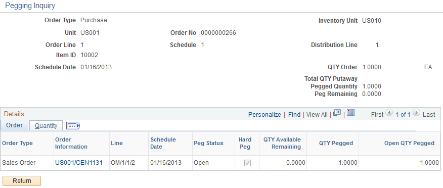

Use the Pegging Inquiry page (IN_PEG_DETAIL_SP) to view pegging information for line items.
Navigation:
Click the Pegging Inquiry button on the Maintain Requisitions - Schedule page.
This example illustrates the fields and controls on the Pegging Inquiry page. You can find definitions for the fields and controls later on this page.
Important! You must save any changes before you can access the Pegging Inquiry page.
Use this page to view information such as order type, order information, and quantity pegged that is associated with any pegged orders.
