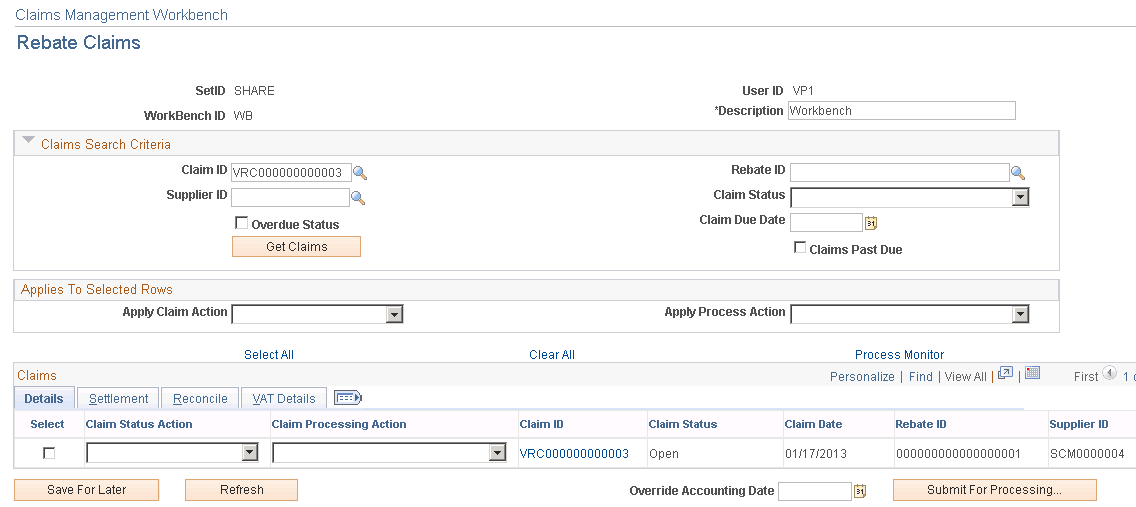

Use the Claims Management Workbench - Rebate Claims page (VRBT_CLAIM_WB) to maintain vendor rebate claims.
Navigation:
This example illustrates the fields and controls on the Claims Management Workbench - Rebate Claims page. You can find definitions for the fields and controls later on this page.
Before you access this page, enter the workbench ID in the Claims Management Workbench dialog box.

Claims Search Criteria
Field or Control |
Description |
Overdue Status |
Select this check box if you want to work with claims that are overdue. The Overdue Status check box is selected on the claim. |
Claim Due Date |
Select a claim due date. The system displays all claims for which the claim due date is prior to or equal to the date that is specified. |
Claims Past Due |
Select this check box if you want to work with claims that are past due. The system looks at the claim due date that is entered to determine what is past due. |
Get Claims |
After you select the claim search criteria, click this button to have the system display in the Claims group box all of the claims that match the search criteria that is selected. |
Applies To Selected Rows
Field or Control |
Description |
Apply Claim Action |
Select the claim action that you want to apply to all the claim rows that you select in the Claims group box. Claim actions are:
Using this field, you can apply the claim action that you select to multiple claims. To apply a claim action to an individual claim row, select the claim action using the Claim Status Action field in the Claims group box. |
Field or Control |
Description |
Apply Process Action |
Select the process action that you want to apply to all the claim rows that you select in the Claims group box. Process actions are:
Using this field, you can apply the claim action that you select to multiple claims. To apply a claim action to an individual claim row, select the claim action using the Claim Processing Action field in the Claims group box. |
Claims
Field or Control |
Description |
Select |
This check box next to each claim row is used in conjunction with the Apply Claim Action, Claim Status Action, Apply Process Action, and Claim Processing Action fields. Select the claims to which you want to apply the claim action or the process action. |
Claim Status Action |
Select a status action for an individual claim. Claim status action values are the same as those for the Apply Claim Action field. Claim status actions are:
Claim Processing Action |
Select a claim processing action for an individual claim. Claim processing action values are the same as those for the Apply Process Action field. Claim processing actions are:
Claim ID |
Displays the claim ID. Click the Claim ID link to access the Claim - Details page. Using this page, you can view all the detail information that is associated with the claim. |
Claim Status |
Displays the header status for the claim. |
Claim Date |
Displays the claim date from the claim header. |
Click the Claim Processing Error button to view the error message that is associated with the last claim processing action performed on the claim. This button appears only if an error has occurred. |
The In Process button appears on the page when a process that you submitted is being run by the system. This button appears only if a process is currently running. Also, the Claim Status Action and Claim Processing Action fields are not available for entry until the requested processing action has finished and this button no longer appears. |
