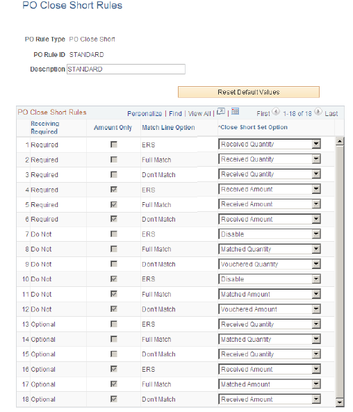

The PO Close Short Rules is defined by a Purchasing Rule ID. The Purchasing Rule ID can be assigned to one or more business units.
Rule |

The Close Short check box for PO Line / Schedules will be deselected and disabled once the user disables a rule. This holds true for PO Add / Update as well as the PO Close Short WorkBench.
Use the PO Close Short Rules page for maintaining the PO Close Short Rules. When a new Purchasing Rule ID is added, the 18 rules will be inserted with the Predefined settings as shown in the previous table. The Close Short Set Option can also be modified according to a desired value.
Note: A STANDARD rule ID would be delivered, which would be used as a template for any new rules to be created.
The 18 rules would be copied from the STANDARD template except for the Close Short Set Option, which would be provided by default as shown in the above table.
This example illustrates the fields and controls on the PO Close Short Rules page. You can find definitions for the fields and controls later on this page.
Field or Control |
Description |
Reset Default Values |
On selecting Reset Default Values, the default values for the rule in the rules table appear by default. |
Whenever you select the Close Short check box for a row, either by copying it from the PO or selecting it on the page, the following conditions must be checked:
If the Close Short Set option is Matched Amount and the matched amount for the row is zero, but the received amount is greater than zero. This will create a cancel request for the PO schedule, and the cancellation will fail because of receiving activity. The Close Short Set option should be changed for the row.
If the Close Short Set option is Matched Quantity and the matched quantity for the row is zero, but the received quantity is greater than zero. The condition will create a cancel request for the PO schedule, and the cancellation will fail because of receiving activity. The Close Short Set option should be changed for the row.
If the Close Short Set option is Received Amount and the received amount for the row is zero, but the matched amount is greater than zero. The condition will create a cancel request for the PO schedule and the cancellation will fail because of matching activity. The Close Short Set option should be changed for the row.
If the Close Short Set option is Received Amount and the received amount for the row is less than the matched amount. The condition will create an invalid change request for the PO schedule and will fail. The Close Short Set option should be changed for the row.
If the Close Short Set option is Received Quantity and the received quantity for the row is zero, but the matched quantity is greater than zero. The condition will create a cancel request for the PO schedule and the cancellation will fail because of matching activity. The Close Short Set option should be changed for the row.
If the Close Short Set option is Received Quantity and the received quantity for the row is less than the matched quantity. The condition will create an invalid change request for the PO schedule and will fail. The Close Short Set option should be changed for the row.
If the Close Short Set option is Vouchered Amount and the vouchered amount for the row is zero, but the received amount is greater than zero. The condition will create a cancel request for the PO schedule because of receiving activity. The Close Short Set option should be changed for the row.
If the Close Short Set option is Vouchered Quantity and the vouchered quantity for the row is zero, but the received quantity is greater than zero. The condition will create a cancel request for the PO schedule, and the cancellation will fail because of receiving activity. The Close Short Set option should be changed for the row.

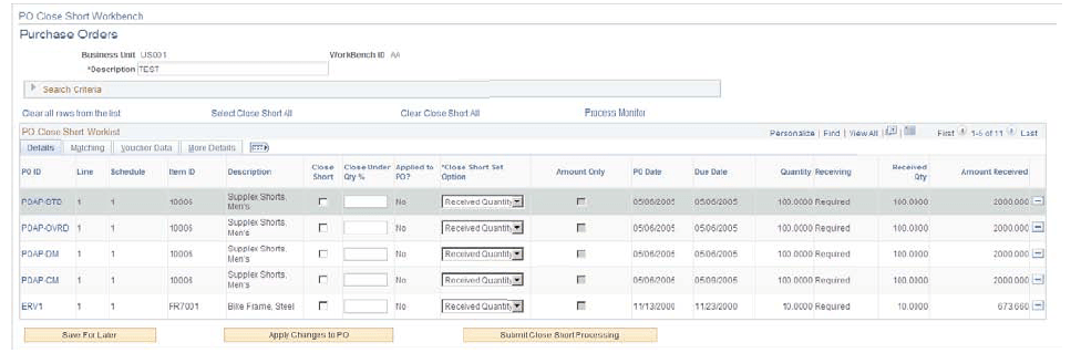

Use the PO Close Short Workbench - Purchase Orders page (PO_CLOSE_SHORT_WB) to use the PO Close Short Workbench.
Navigation:
This example illustrates the fields and controls on the PO Close Short Workbench - Purchase Orders page. You can find definitions for the fields and controls later on this page.
The Close Short Workbench provides a way to review purchase orders and determine whether outstanding purchase order lines should be set to close short. Using PO Close Short Workbench, you can run both the PO_CLSSHORT AE process and the PO_POCHNG AE process so that the purchase order is updated to reflect the Close Short processing.
The workbench page is divided into two sections. The top portion enables you to define search criteria for locating the purchase order schedules. The lower portion is a grid of the returned rows from the search. Each returned row contains a combination of purchase order header, line, and schedule information for your review and analysis.

Details
Use the Details tab to view line and schedule information for selected purchase orders.
This example illustrates the fields and controls on the PO Close Short — Details tab. You can find definitions for the fields and controls later on this page.
Field or Control |
Description |
PO ID (purchase order ID) |
Click to view and update purchase order information. |
Line |
Displays the purchase order line number. |
Schedule |
Displays the purchase order schedule number. |
Item ID |
Displays the item that is associated with the purchase order line number. |
PO Date (purchase order date) |
Displays the purchase order date. This value is retrieved from the purchase order header. |
Due Date |
Displays the schedule's due date. |
Quantity |
Displays the purchase order quantity from the purchase order schedule. |
Receiving |
Displays the line item receiving requirement indicator from the purchase order line. Values include Required, Optional, and Do Not Receive. |
Received Qty (receiving quantity) |
Displays the receipt quantity for the purchase order schedule. The system retrieves this value from the net receipt quantity for the receipt transactions. The system refreshes the quantity from the receipt transactions when you open an existing workbench or worklist. |
Close Short |
Indicates whether the Close Short check box on the purchase order line is selected. If you select or deselect the check box, the system applies the new value when you click the Apply Changes to PO button. |
Close Under Qty % (close under quantity percentage) |
Displays the close under percentage value from the purchase order schedule. You can enter a new value and click the Apply Changes to PO button to apply the change. |
Applied to PO? (Applied to purchase order?) |
Indicates whether changes have been made to the Close Short check box or the Close Under Qty % field and applied to the purchase order. |
Close Short Set Option |
The Close Short Set Option value will be provided by default on the PO Close Short Work List when the row is populated during search processing for the PO Close Short WorkBench. The PO line and schedule values for Amount Only flag, Receiving option, and Match Line option, along with the PO Close Short Rule ID of the PO business unit, will be used to find the PO Close Short Default Rule and retrieve the Close Short Set Option value. The close short set option would be set to either Received Quantity or Received Amount based on the Amount Only flag and grayed out irrespective of the close short rule; and the close short flag would be selected and grayed out if the PO line is stockless. Note: If the close short set option is disabled for any of the PO schedule, then close short flag on all the rows listed for that particular PO line would be deselected and grayed out. If the close short override is not enabled on the PO Business unit, then the close short set option would be grayed out. |
Amount Received |
Displays the amount received for the PO schedule. |
Save for Later |
Click to indicate that you want to save the changes that you made to the search criteria, the worklist, or the run control parameters for the Close Short process. The system stores the values for the specific workbench ID and you can retrieve them by opening the workbench. |
Apply Changes to PO (apply changes to purchase order) |
Click to apply close short or close under quantity percent changes that you have made to purchase order lines and schedules. |
Submit Close Short Processing |
Click to access the Process Request Options page, where you can submit a batch Close Short process. If you do not apply the changes that you made on this page, the system displays an error message when you click the Submit Close Short Processing button. |

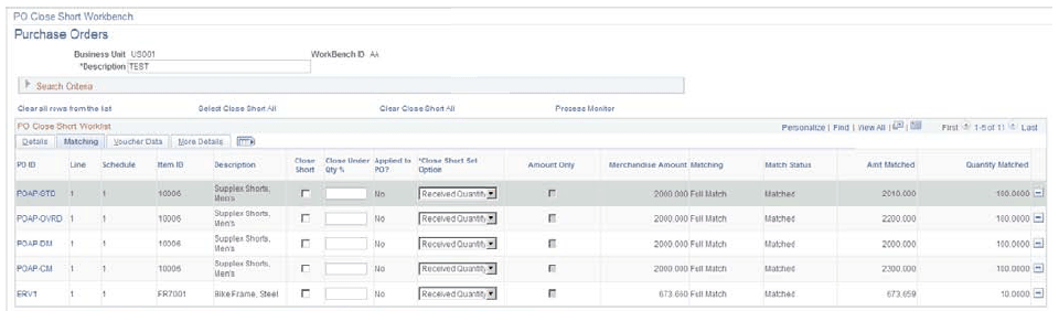

Matching
Use the Matching tab to view line and schedule information for selected purchase orders.
This example illustrates the fields and controls on the PO Close Short — Matching Tabs. You can find definitions for the fields and controls later on this page.

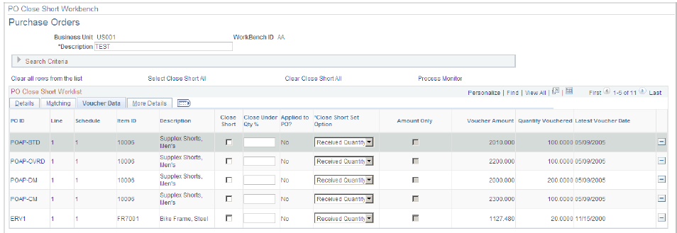

Voucher Data
Use the Voucher Data tab to view line and schedule information for selected purchase orders.
This example illustrates the fields and controls on the PO Close Short — Voucher Tabs. You can find definitions for the fields and controls later on this page.
The Amount Vouchered, Quantity Vouchered, and Latest Voucher Date fields will only appear on the Voucher Data tab if the Close Short Set Option is using a Voucher value.
